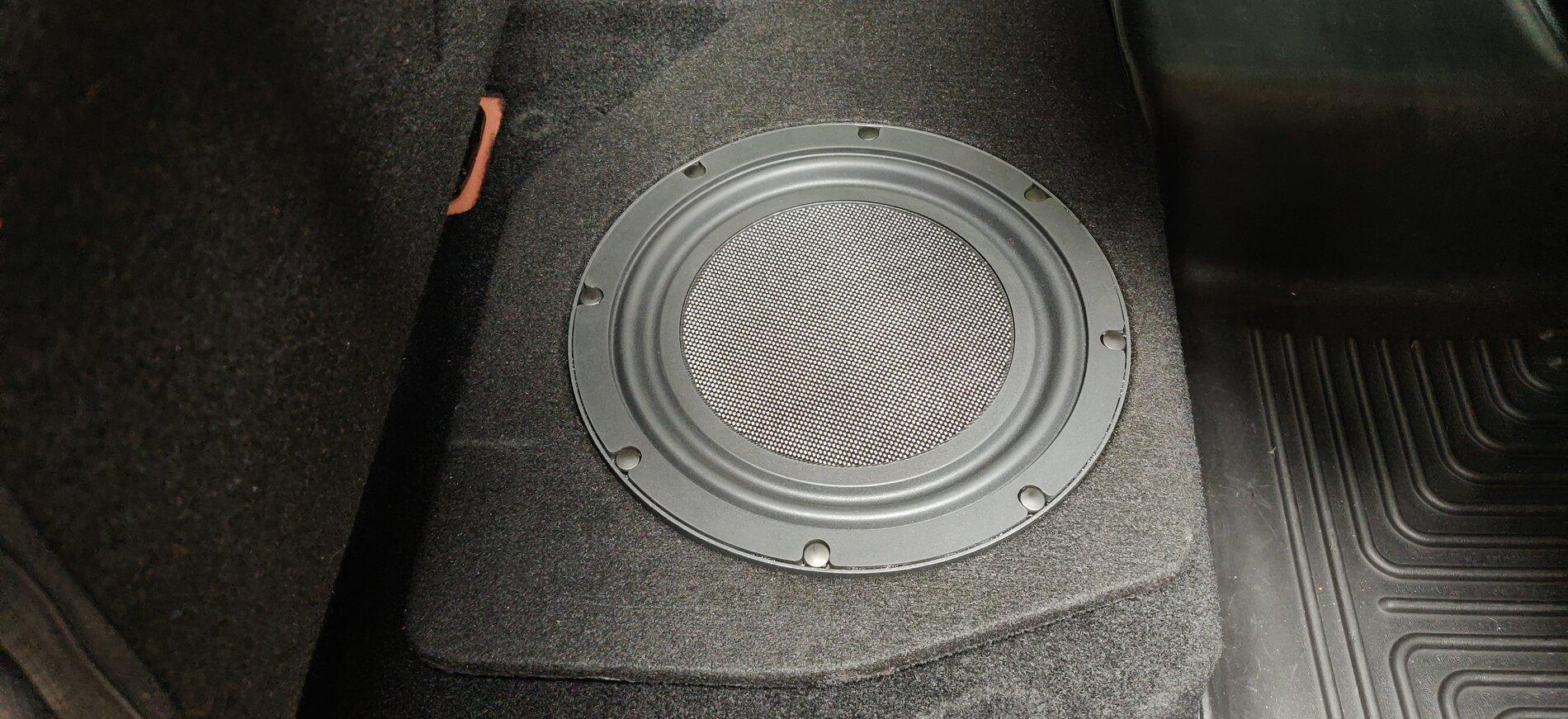

LOL - I broke that LED thing on my driver's door when I did my audio upgrades to the B&O. I super glued it back together and the repair is still holding up. I'm sure it would break if I were to remove the door panel again.
I used about 3/4 of a bulk pack of Dynamat Xtreme and did 1 layer of Raam Audio Ensolite closed cell foam on the back wall and door skin behind the door panel. Sound deadening is well worth the effort and probably did more to improve the sound quality than upgrading the drivers.
I also installed Infinity Reference drivers and a 10" sub under the rear seat. The sub is powered by a Kicker KXA400.1 but the factory B&O amp/processor powers the Infinity drivers.
To counter the sub roll-off I use my phone as a BT source running Spotify and tune the sound with Viper4Arise.

Oh, super clean sub install!
I tried rejoining the broken pieces of the light pipe using heat shrink, but the light transmission was poor enough that the ambient lighting in the door handle got dim. It bothered me (of course) so I had to replace it.

I bought 36 square feet of Kilmat for $60 from Amazon and needed almost all of it. Learned Kilmat is manufactured in Russia. When I removed the plastic door panels, I disconnected the door handle and power window controls, but left the lock switch/fiber optic cables installed. There's no need to risk breaking the fiber optic by disconnecting it. You can swing the plastic panel out of the way and place it inside the cab without disconnecting those cables. I didn't need to remove the B&O speakers. There was zero sound deadening material inside my door panels unlike the Raptor in the video, front or back, just the foam glued to the outside.
Sound quality is noticeably better without the door resonating, you can crank the stereo without it being audible outside and road noise is greatly diminished. The doors are heavier and latch more reliably without slamming them. Took me one hour per door, absolutely worth it. This combined with moving to one size larger highway tires and a tonneau cover, it's night and day inside.
