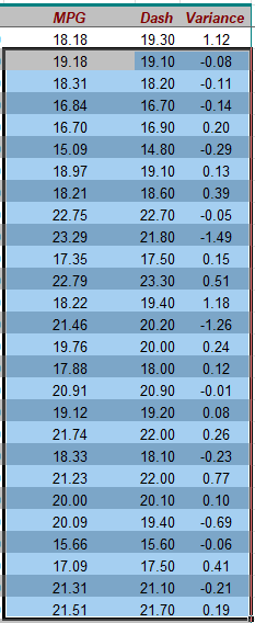

I set mine to 948 back in May and over 26 different fuel calcs/tanks, I average out to being dead on now.

I did mine back in Feb. and I average pretty much dead on over the time frame. It varies fillup to fillup as your post shows @Gizmokid2005
