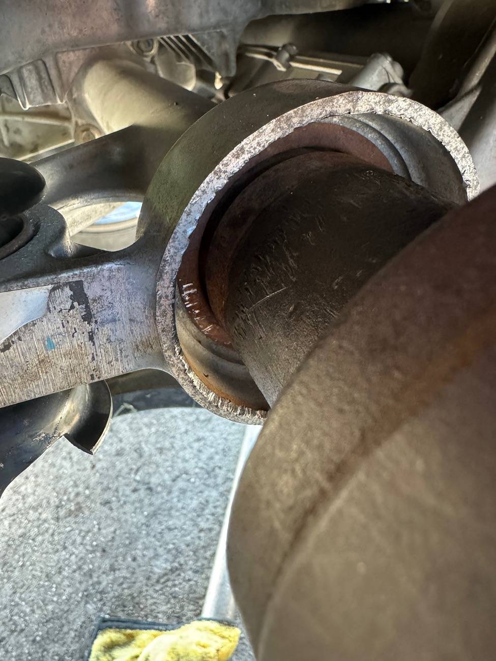

I am trying to get the inner CV out of the transfer case and it wont budge. I have been prying on it for two days and cannot seem to get it out. Has anyone got any tips for getting this removed? It has come out some but I cannot seem to get the thing out. I have a tire install scheduled Friday and right now the truck is not drivable.

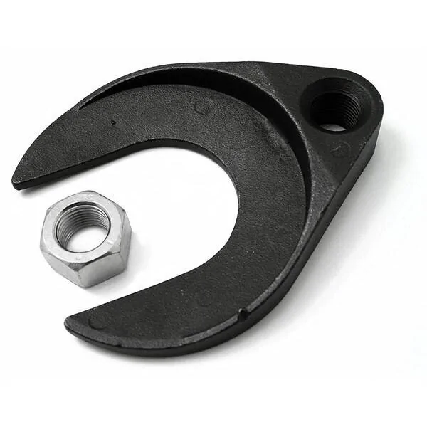

A Slide Hammer with a - Adapter Plate that will fit around the shaft.
The TRICK is getting past the tension of the circlip, and a quick motion pull / jerk helps get past that tension.
Some slide hammer kits come with a plate that will fit, and they do make an adapter specifically made for CV Shafts- or you can make your own out of steel plate.
I have both as I once made my own in a pinch.
I do not like using the prybar method, due to marring the axle output housing and or marring the seal - Like in the posted pic.
Example:
Or steel plate with a hole drilled and then use nuts to secure it to the slide hammer vs a threaded adapter like this.
