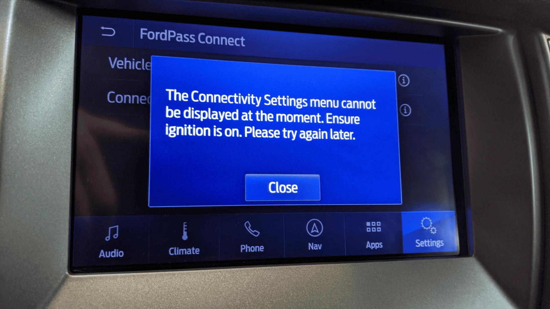

My Fordpass app stopped updating, went into the Fordpass settings in the truck and I get this now...
The ignition is on. I did a master reset, disconnected the battery, moved the truck outside, and reset the app on the phone. I think my modem is dead?

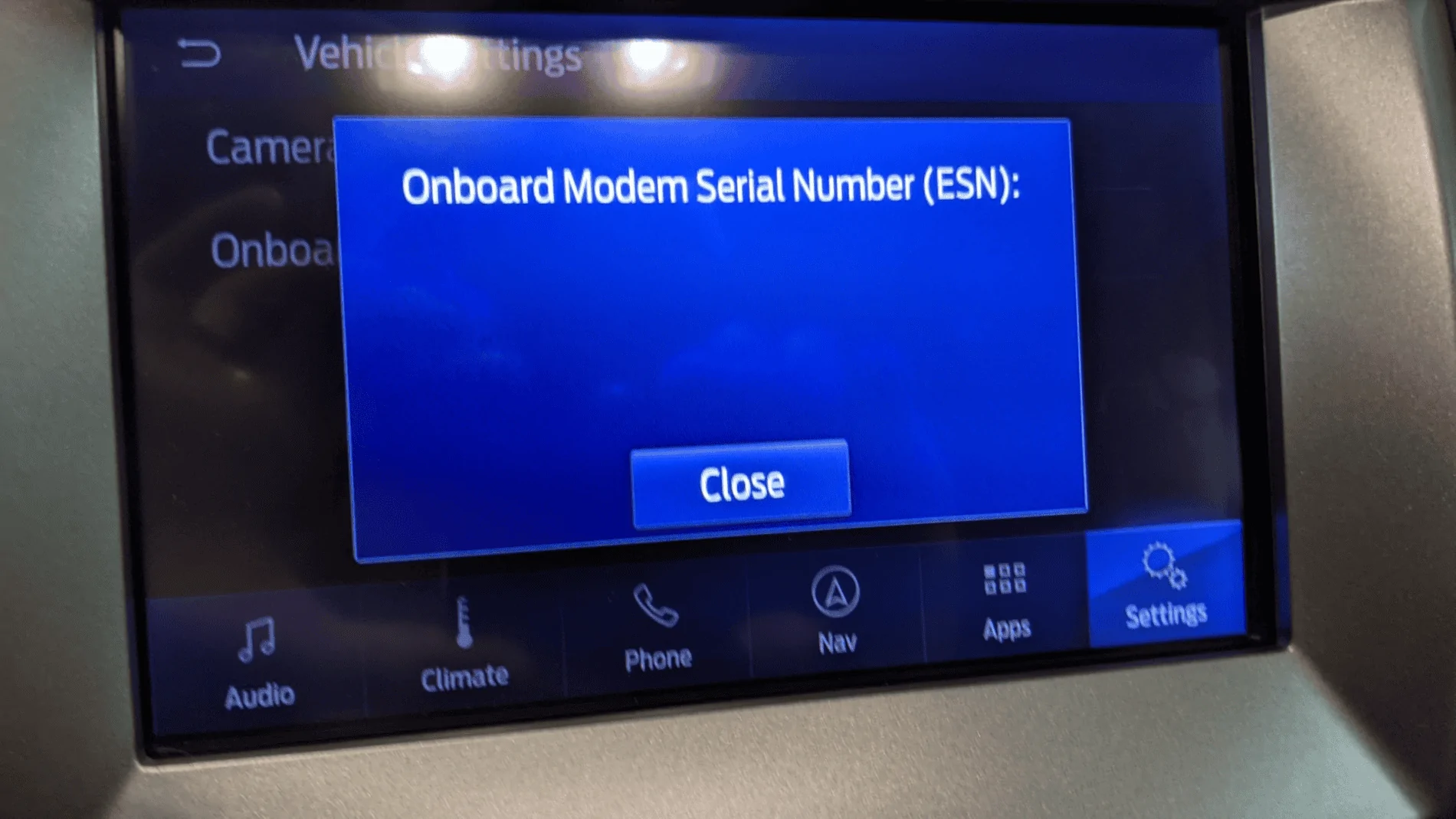

mine did that back in may, go to the truck info screen, if the modem is dead it wont show the modem serial number, but my guess is you are right your modem has shit the bed. took me over a month to get a replacement
Yeah.... great, I get to interact with my Ford dealer again...
