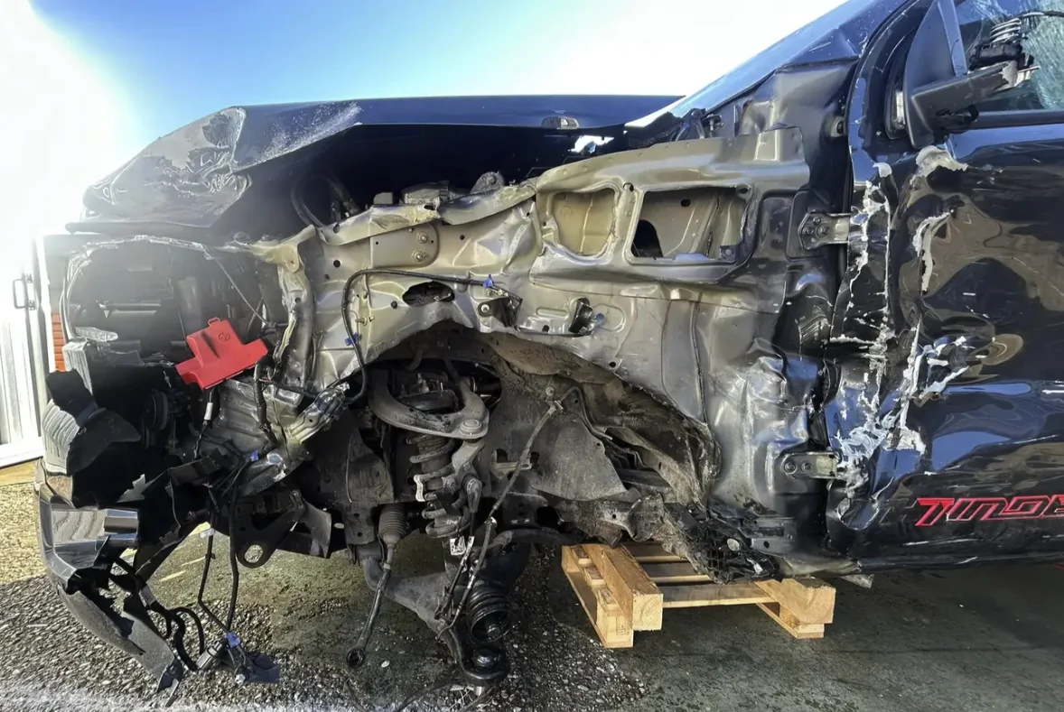

Do you have brake lights? - Push button start (requires brake pedal input) - one brake line is cut, but the car reacts to brake pedal pressing. I will double check the rear lights.
Do you know if the truck ever ran (after accident)? - no idea.
Was there any repairs done or was this simply bought at auction (totaled or as-is) salvaged title - bought from the dealer.
Exactly what was damaged - details of damage may reveal wire harness or fuse damage? - I will make more photos of BJB. Someone has definitely been there before.

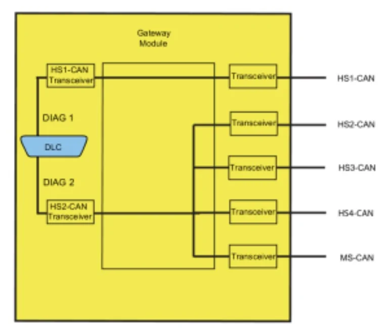

I think i may have some understanding - as i never really dug into this (specific) transition between the DLC & GWM
1. The Diag 1 & Diag 2 - we see on the diagrams are - Internal to the GWM (Only) these are the micro controller circuits that pick up the com data from all the busses
2. So the (no continuity) at pins 17-20 would be normal as the security com of the GWM opens the ports for communication for data.
The GWM is internally switching the logic board to read the data from pins 17-20 and producing the data to the DLC pins
3. When you test pins 6 and 14 from the front DLC - this is only testing the DLC for com to the GWM
This is testing the (Diag 1) & (Diag 2) bus - Totally Internal to the GWM
Pin 6 to Grd
Pin 14 to Grd
With Battery Disconnected - 60 Ohms
Powered
Pin 6 to Grd - Diag 1 Can High - 2.7 Volts
Pin 14 to Grd - Diag 1 Can Low - 2.3 Volts
Pin 3 to Grd - Diag 2 -Can High - 2.7 Volts
Pin 11 to Grd - Diag 2 -Can Low - 2.3 Volts
The key Point is - understanding the Ref to Diag 1 and Diag 2 are not the actual can busses this is misleading by how the wire diagrams depict it
Basically we need to look at this as a (Gateway Module) or router that is switching ports internally - I am sorry but this is a learning experience for me as well, since I do not do this professionally anymore and got out before scan tools diagnostics became a norm , so I have never really dug into the internal handling of the GWM and from what I gather I think my above theory of operation is correct - its not a direct connection as one would think.
I know there are some videos online that use - Can Bus (Breakout) boxes that may explain how it transitions better - I plan on watching to get a better understanding.
As you are really the first to have a full - no com issue and i have only used the data from scan tool com to pinpoint (where the issue) lies by seeing what coms are lost and what modules are producing a code.

So to dumb it down:
Diag 1 = HS1 (Network) - the GWM internally connects to the HS1 Can Bus
Diag 2 = HS2 - HS3 -HS4 and the MS Can Busses - also GWM internally connects to those busses
Pins 6 & 14 - Check Diag 1
Pins 3 & 11 - Check Diag 2
This only checks the com from the GWM to the DLC

GWM - showing the transceivers - that the wiring diagram leaves out, i knew it had the terminating resistors inside, but did not realized or pay attention to the detail that there was an extra set of (resistors) inside for Diag 1 and Diag 2
That’s some interesting stuff happening inside the GWM. If I understand correctly, cutting off the MS1 CAN line did not break anything because the transceivers collect and pass the data. If I had cut off, for example, HS1, that would not have worked.
