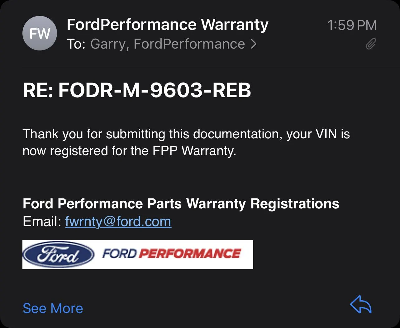

Where did you submit your receipt for the warranty? This is something I haven’t done yet and have 0 idea where to send the receipt.
In the paperwork that came with the Procal, under warranty there is an email address, Send pics of your documentation.
My bad Garry.
Go to the website you signed up at. Look under warranty for the email address.
Call Ford Performance Center at 1-800-367-3788 or email [email protected] to register for warranty.
