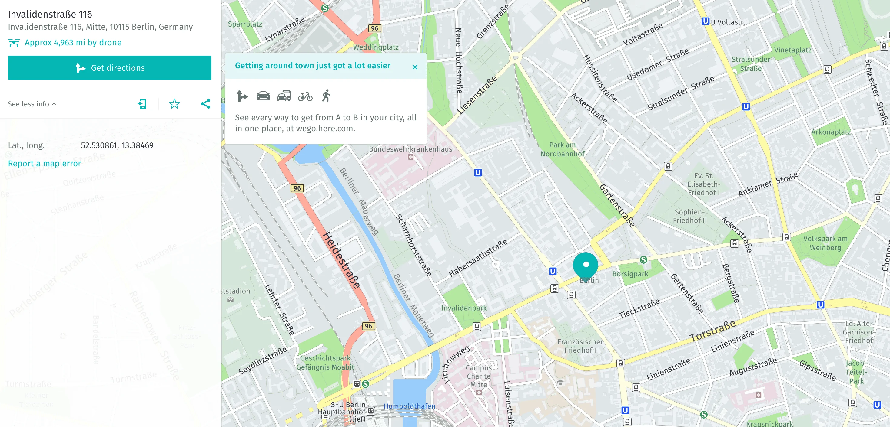

My map just opened up in Berlin!
Mine does this pretty often. It'll quickly zoom across the world to where my truck actually is, but it's weird. The app uses Here Maps, which does have offices in Berlin......
Have to see if opens here.
I didn't really pay attention, just saw it was in Berlin. If it does it again, I will look closer.
