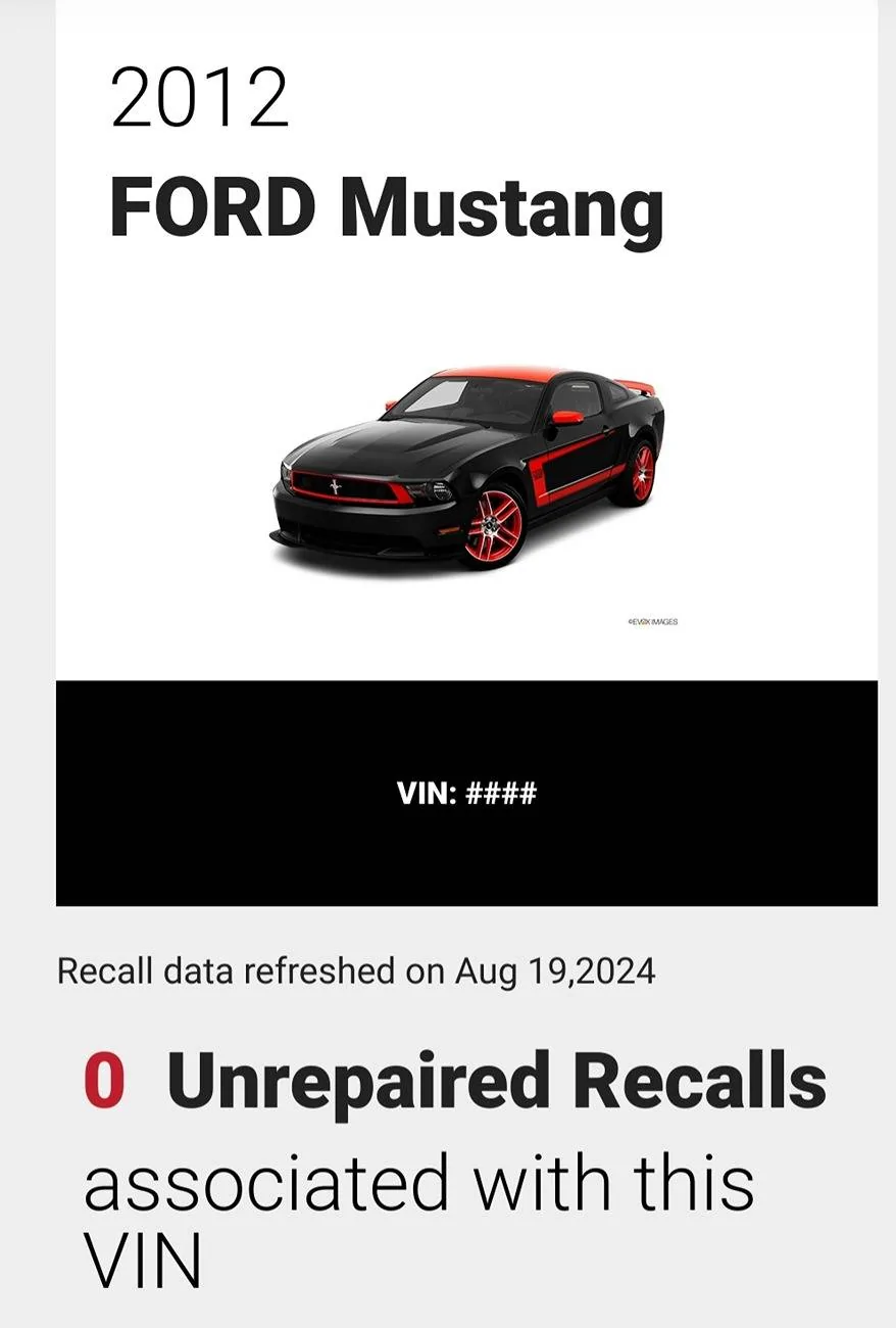

I have been getting letters and e-mails for the 2012 Mustang GT that I traded in to a Ford dealer in 2015. I guess nobody follows up on this stuff.
I got my 08 mustang from my inlaws and started getting the notices as soon as the title was transferred. Ford kept sending them to my inlaws as well for good measure lol
