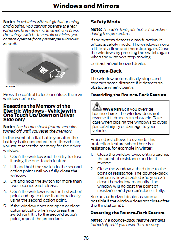

I just had my Ranger in the shop so get the Brake Controller install and noticed my drivers side Auto Up/Auto Down feature isn't working. I know they had to disconnect the battery to perform the installation. Is there a configuration or something I need to do to make Auto Up / Auto Down work? Thanks, John

I am sorry, I forgot to post about this - Check your Owner's Manual for procedure.
If you disconnect battery - such as replace, you must do a reset of the Drivers Door Window, Auto Up/Down

they didnt do the window reset -- my dealer didnt do it when they replaced the battery last year either glad you found the solution hopefully thats the only thing they missed!
