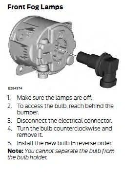

Can anyone show me how to replace my FOG light bulbs on my 2022 Ford Ranger Tremor XLT? I have my guy who swapped all my factory halogen bulbs throughout my truck with LED bulbs which they look amazing but I would like to do it myself this time. I looked in the vehicle Manual but has limited information on it. I also looked on the internet and YouTube with no help.

With the Tremor I think it is more of a limited access to the back of the Fog Lights, so you may have to pull the skid plate to allow enough (hand room) to reach up to the back and pull the socket out.
So did a fairly new - LED upgrade bulb - already blow? or is this another upgrade to the upgrade?
I will say even for the non-Tremor, it is a tight space, but can be done.

Thank you so much for your response! What you replied it's exactly what I found on the owner's manual. It has the exact same diagram. On my Ranger there's a cover in the wheel well. I should have taken a photo of it to show you specifically what I'm asking. The factory FOG Light was Halogen. My guy changed it to a non branded LED that works excellent but for some reason it's either malfunctioning and / or the conector is loose. When I hit bumps on the road the light bulb flickers and now it won't turn on. Since it's going to be replaced by me anyway I rather now go with LASFIT branded FOG Lights as I have them on my 2016 Ford Escape Titanium and they work way better than the ones non branded I have on my Ranger. I will eventually take photos to show you.

If you put the front of your truck on ramps and remove the skid plate, you can snake your hand in there to get to the bulb
