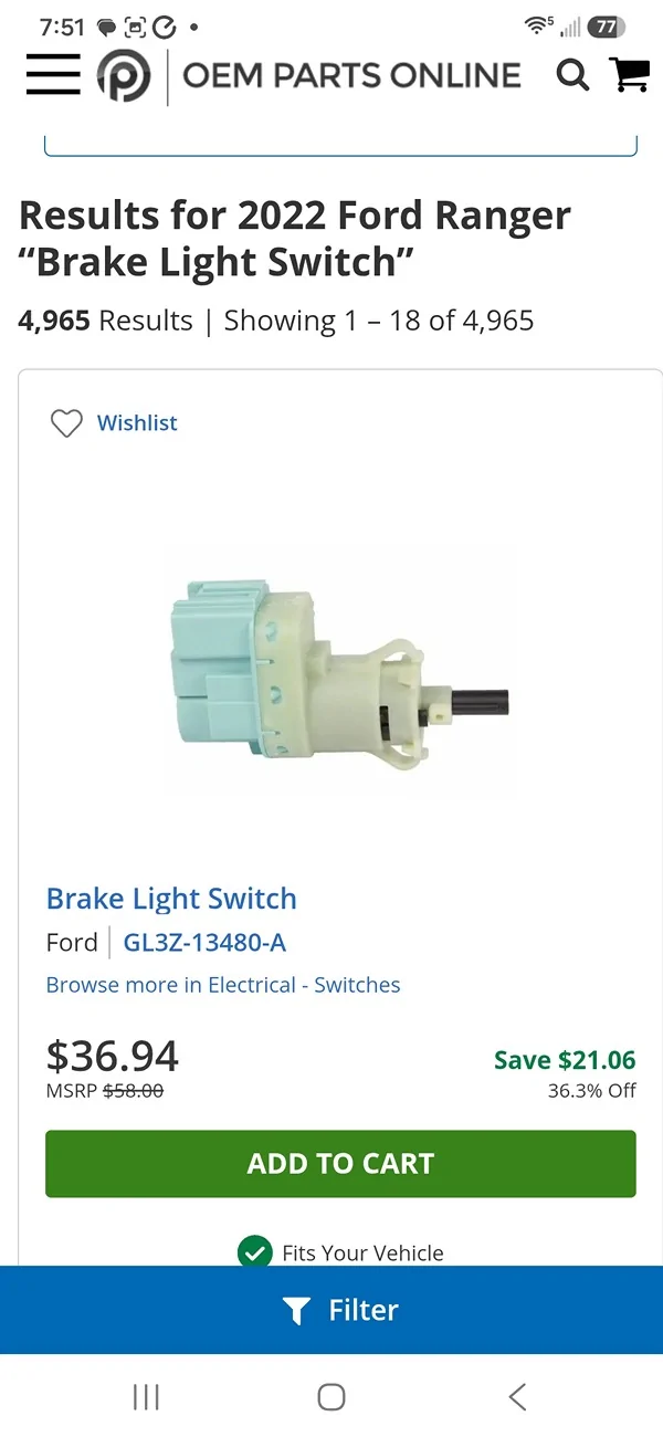

My Ranger has been acting up for awhile now. The hill start assist feature randomly disables, cruise control disables, and brake lights/taillights stay on or flash without brake pedal being pressed.
I think it may be a faulty brake light switch. Has anyone had this issue with their 2022+ Ford Ranger and know what brake light switch to get?

Thats what I come up with ... if that is in fact the problem...
carson23
Carson
Apr 19, 2026
oklahoma
2022 XLT 4x4 Ford Ranger
sales/marketing
After briefly looking at mine, they have the same colors. I haven’t had the chance to pull it off and look at the part# yet
