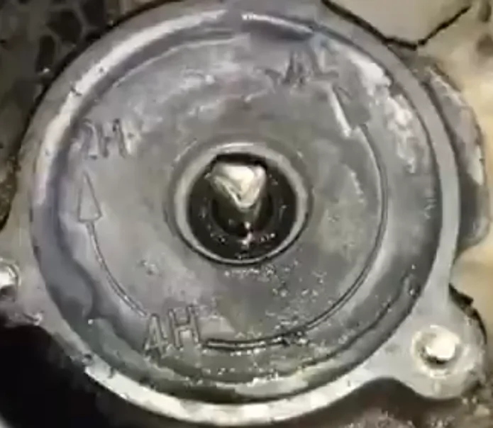

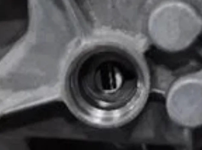

I already found out some interesting things. This is where the actuator bolts to the transfer case. We just need to find out if the tx neutral is between the 4H and 4L (which I think it is since that actuates the planetary gear), or 2H and 4H.
Next we need to see if there is a detent in the neutral position or if it is spring loaded to go out of neutral.
From there, I will figure out a way to make it more solid/reliable and possibly make a fix for it and offer it to the community if there is interest.

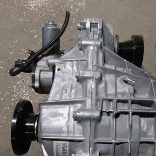

The picture above is from an F150, but visually, they look very close. The above picture is the motor removed of course, looking into the tx case.
I might just buy a used tx case at this point and open it up to prove this out for sure.
If there is a detent, then its a question of how do you keep in in the detent?
Obviously having your vehicle shut off and not receiving any electrical signals at this point would be step one towards this goal.
After Looking at this, I might consider making a mechanical override with a lockout. This wouldnt address the brake lights of course.
The basic arrangement looks similar to the F150
Here is the motor removed. You can see it's a inside/out compared to the F150
