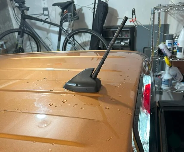

And... as a bonus if you want to see how this happened:
https://1drv.ms/v/s!AtuhT174YsbYl8MsN7fziSYVNbSuMA?e=liWupZ
(video is out of focus, but you get the idea).
This happened minutes after I was done putting the rear leaf spring back on after welding it together when it fractured. (As seen here - https://www.ranger5g.com/forum/thre...back-home-can-i-diy-repair-temporarily.32550/ )
Imagine my surprise hearing that bang and seeing something fly past the windshield.... after just welding a leaf spring back together.
I was exhausted, thirsty, and hungry after 5 hours of work on that project... what you don't see in the video is me going to sit down on a chair and just contemplate mistakes I've made.

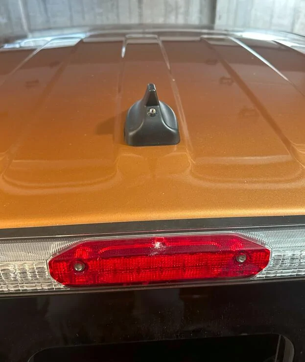

Was it necessary to touch up the paint if you sealed it so well?

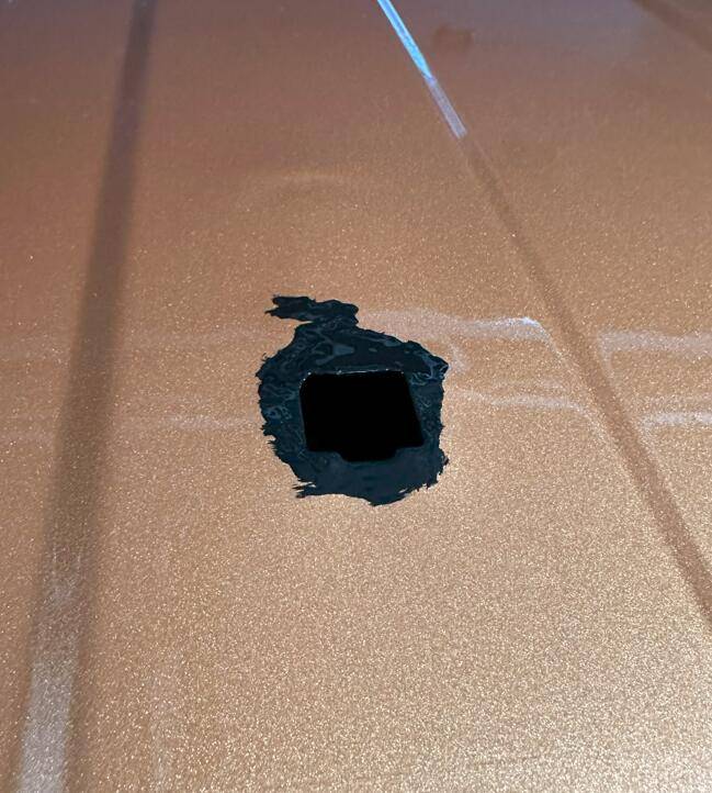

Possibly not, but I didnt want ANY chance of rust starting. Belt and suspenders when it comes to these kind of repairs, I dont want to do them again :)
