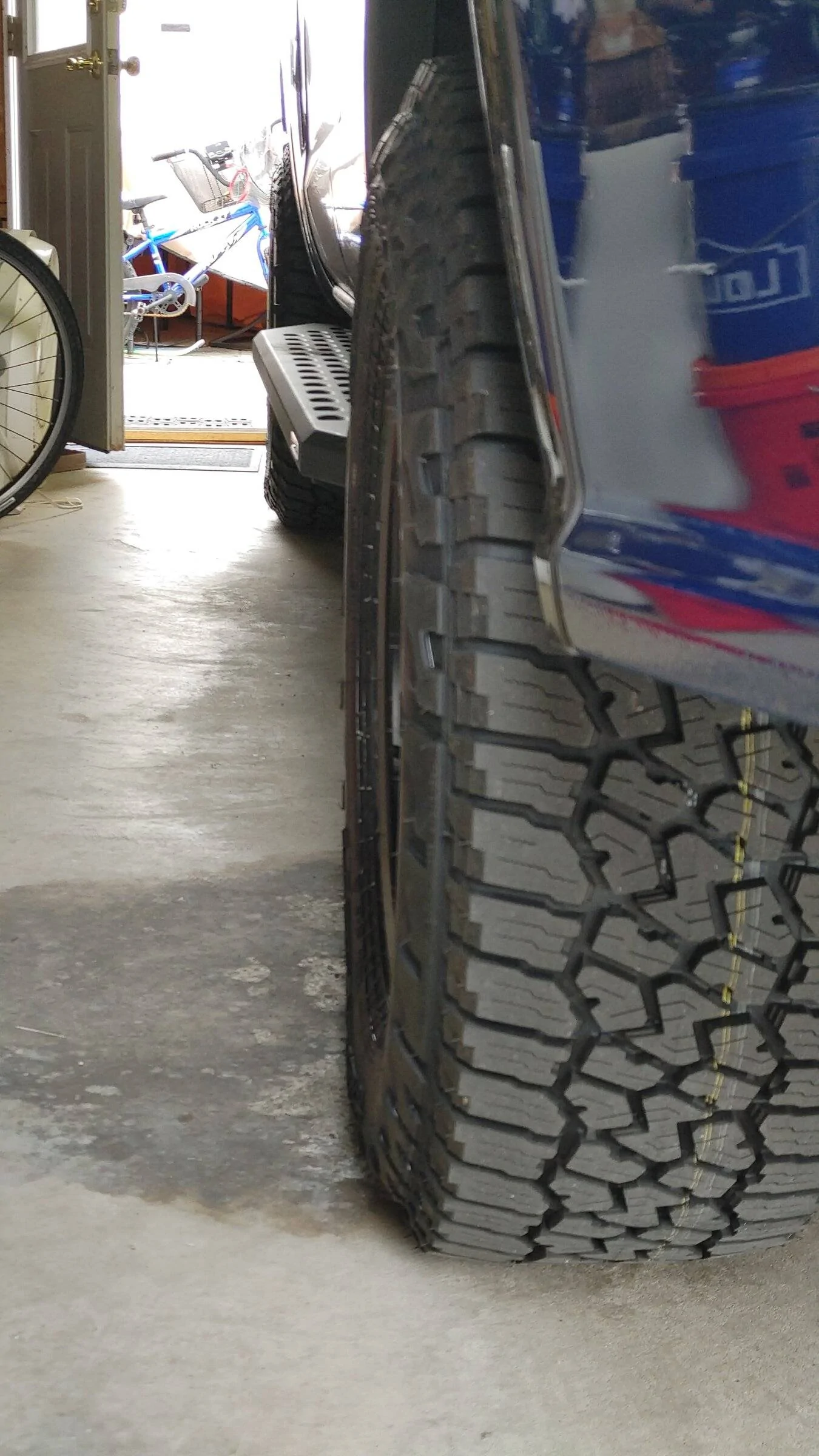

I’m the poor schmoe who went with 275s and a +15mm offset - super close to the crash bars (1/4” at lock) and I almost had the sweet spot - that prize goes to Calvin. ?
I swapped in ReadyLIFT anti-intrusion beams just to be safe. So, yeah, I agree with your butter zone comment. ??

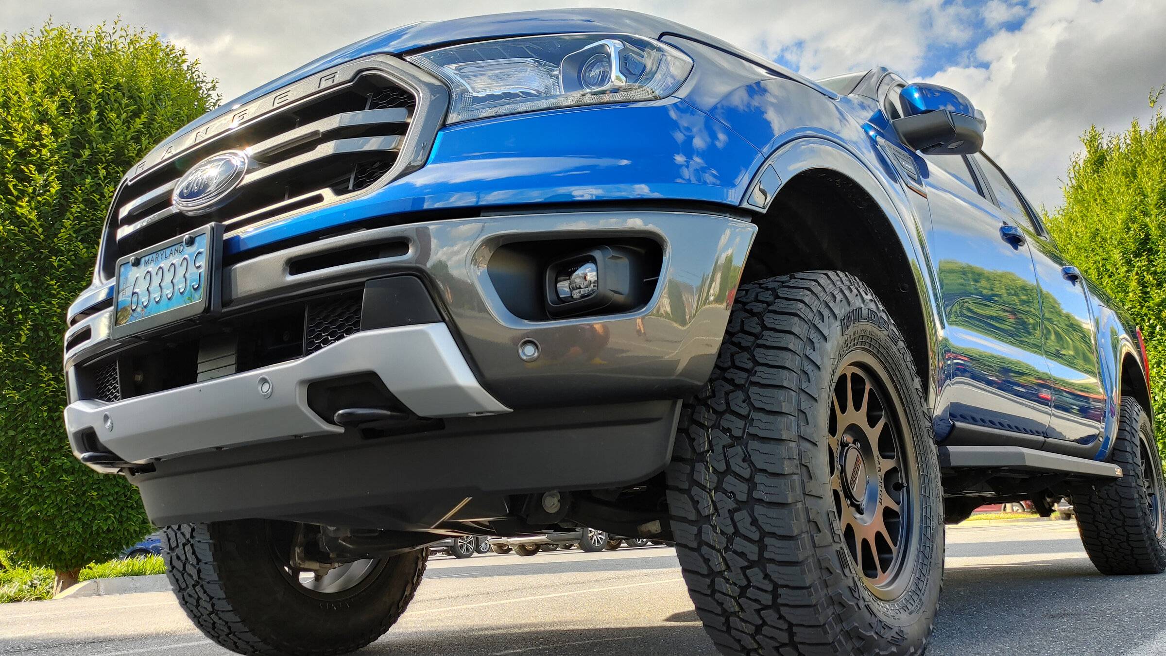

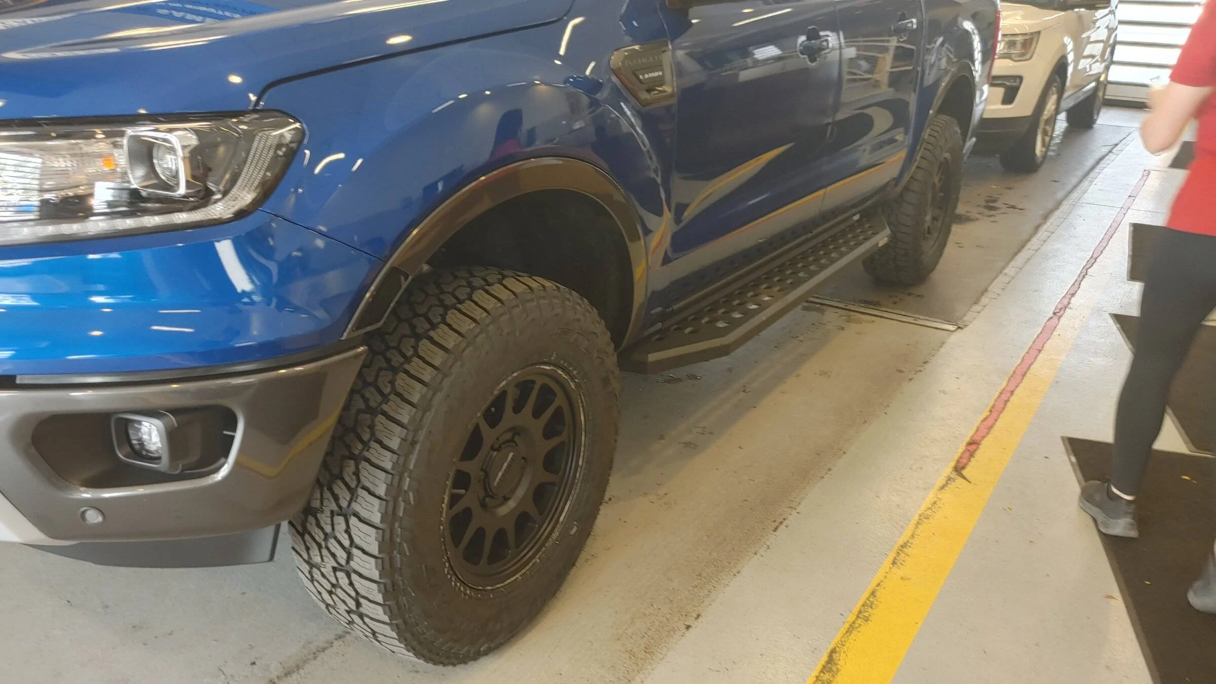

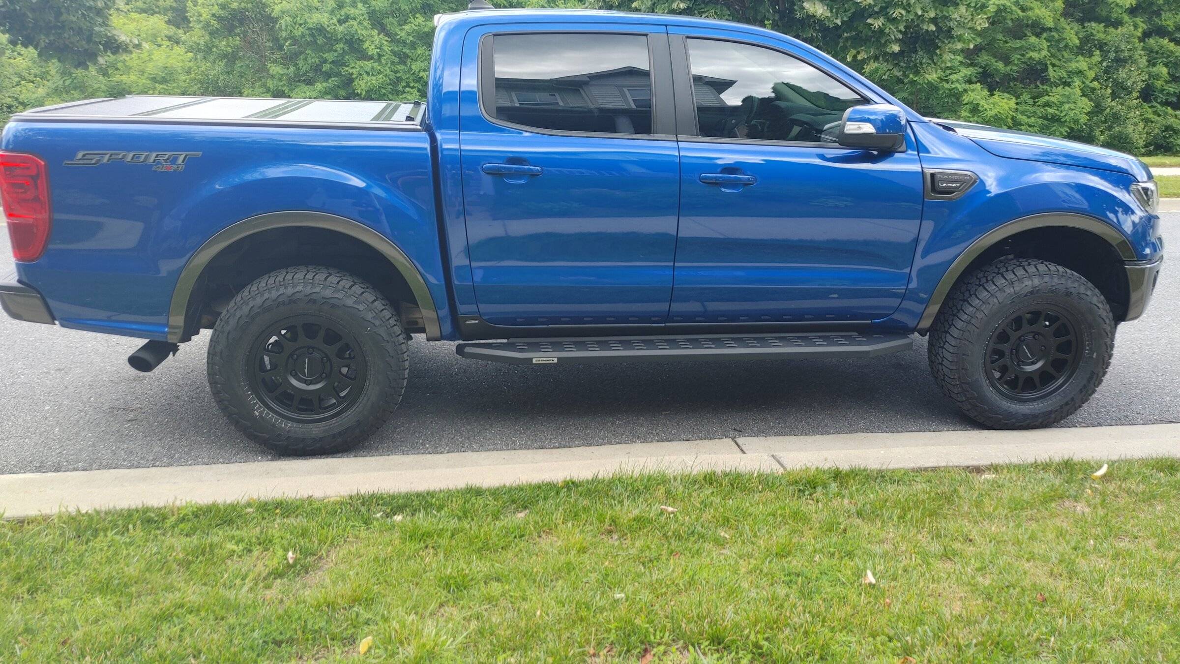

Finally got the wheels and tires done. Ever since i went to the bronco off rodeo last year i've wanted meatier feet. My 13 year old talked me into new wheels too. so here i am, 2.5 level, falken wildpeaks 265/70/17 on Method Race 703, 8.5" x 17" with +35 offset. I think it turned out pretty good.
