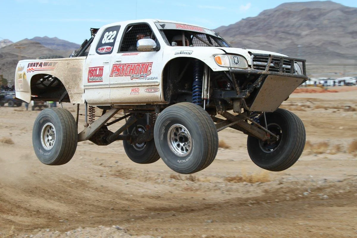

Here’s an exaggerated photo for effect

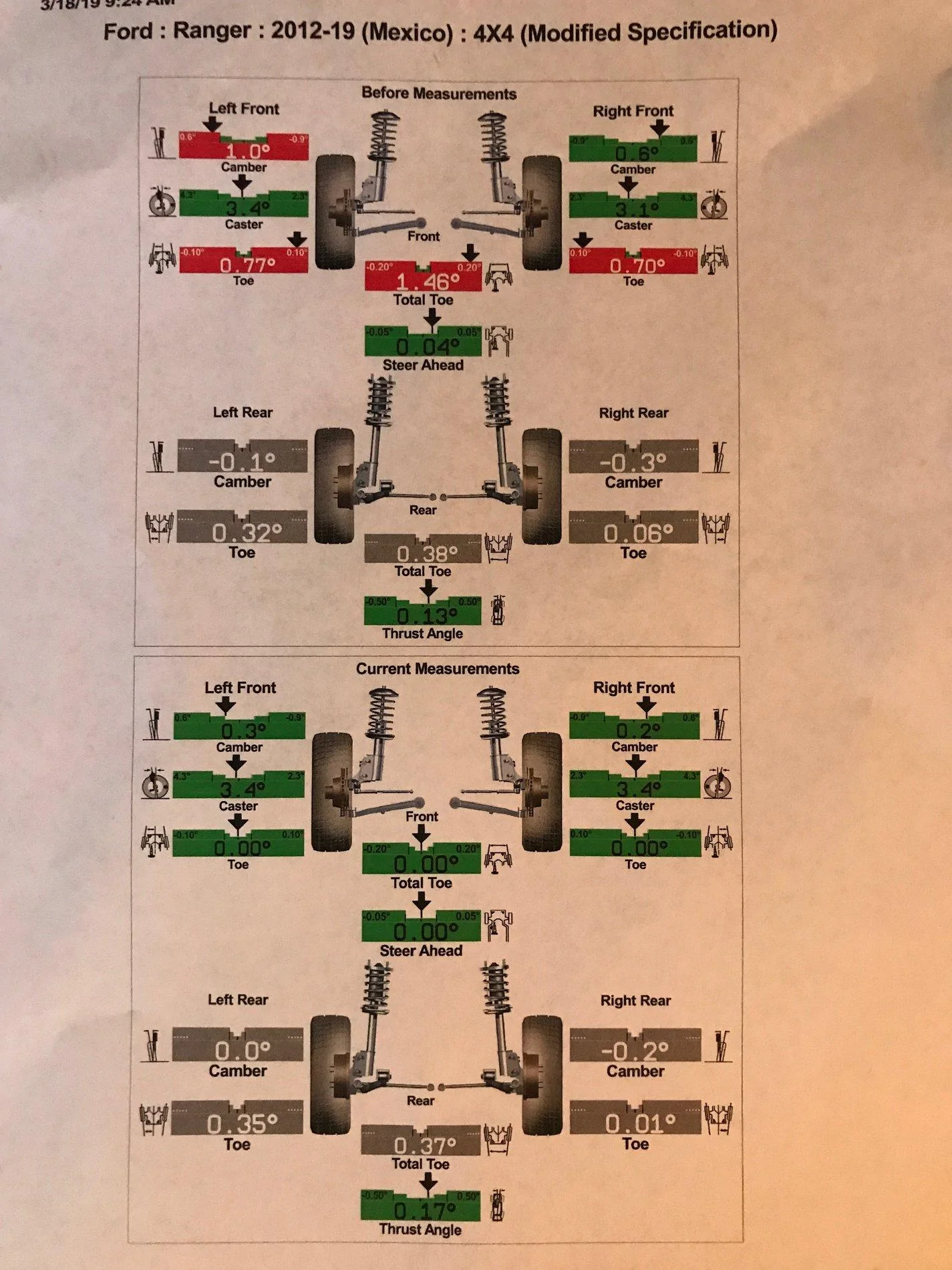

Here is the alignment read out from my truck with the 2.5” TC level. They didn’t say a thing about needing more adjustment and it fell within the RC alignment specs. I’d like to know if I’m at risk for any issues... wonder if RC’s specs are acceptable?
you still have positive camber!! Not sure why these lift companies say this is in spec. This will cause shitty handling when turning.
