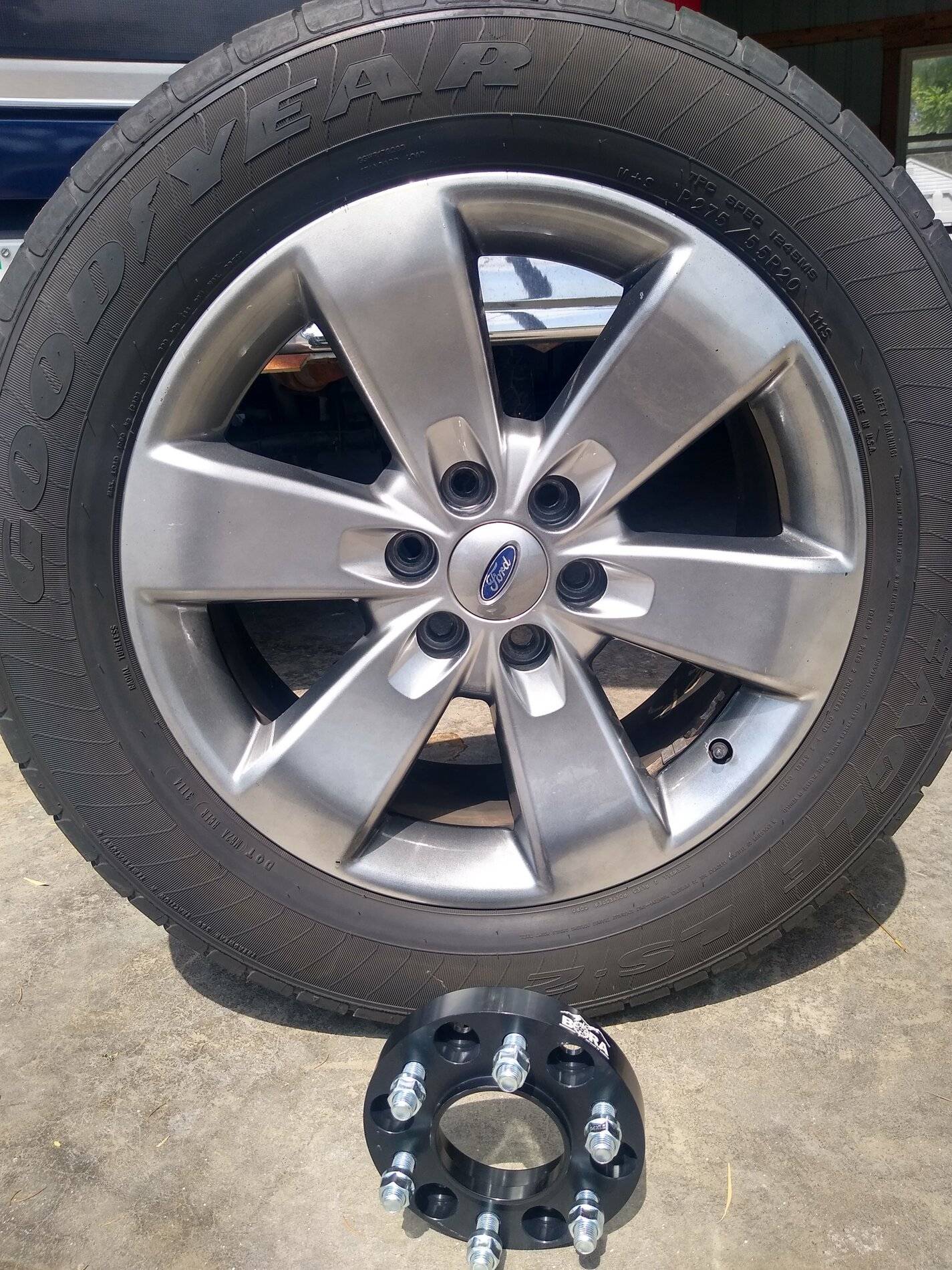

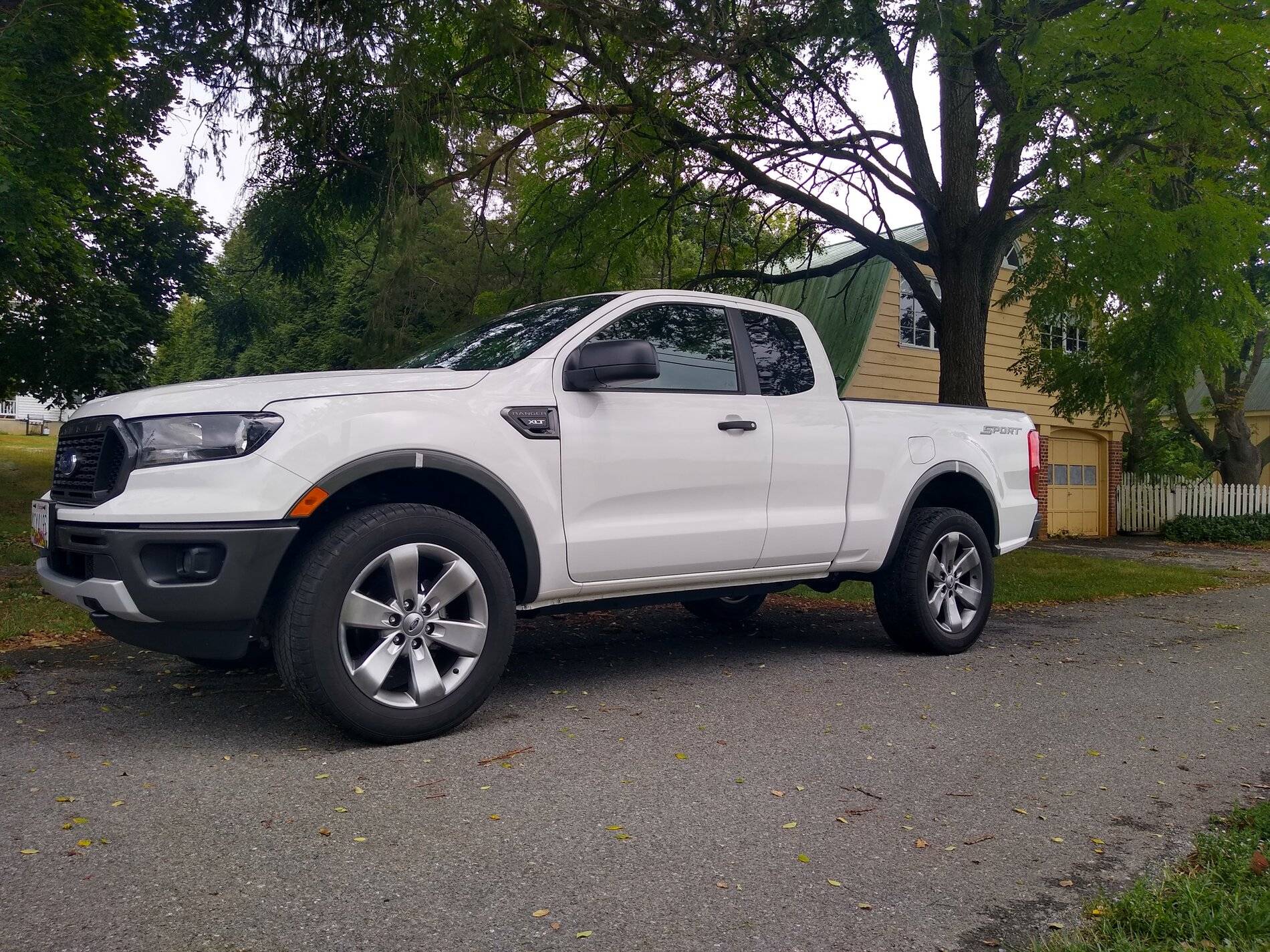

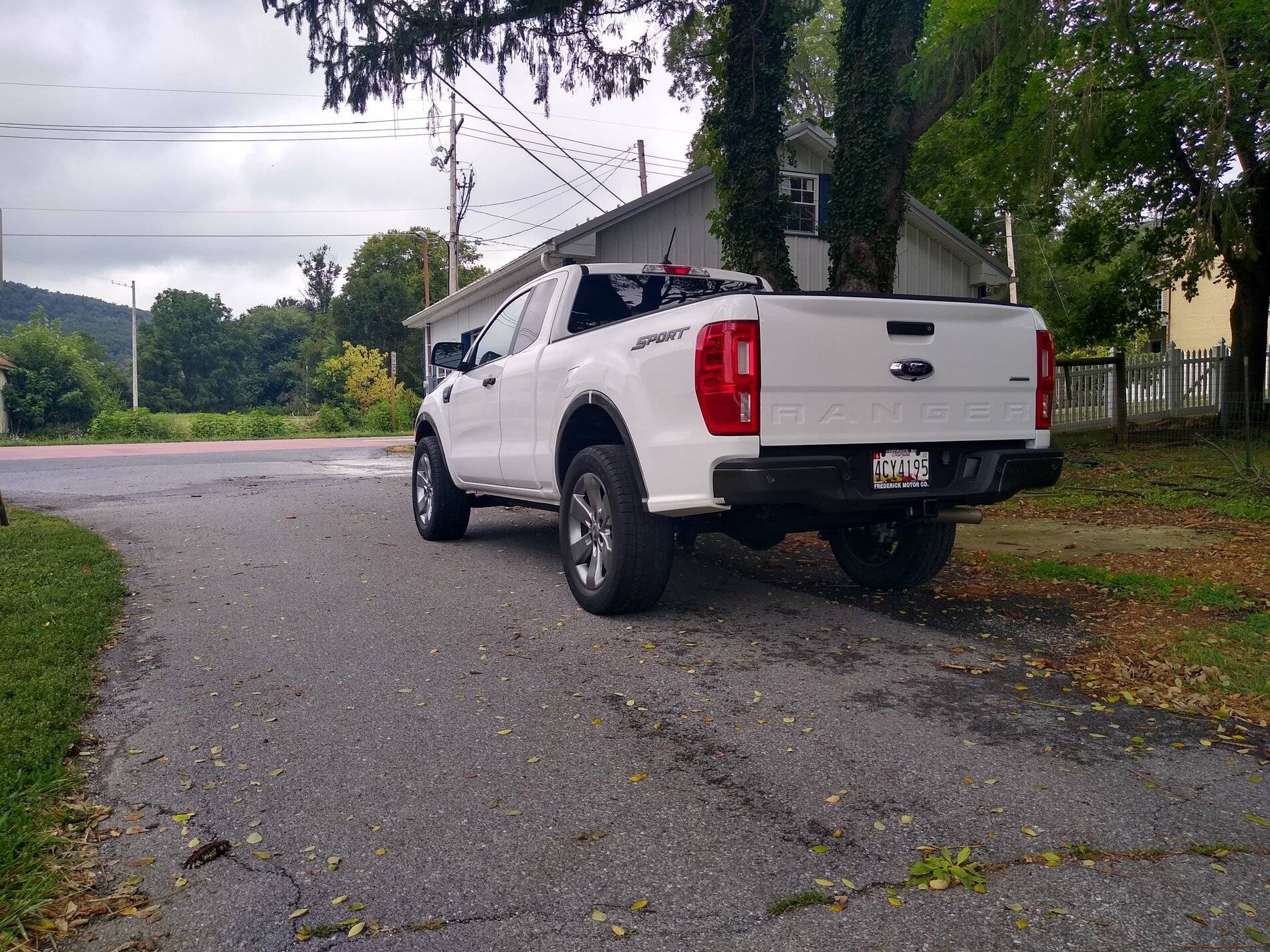

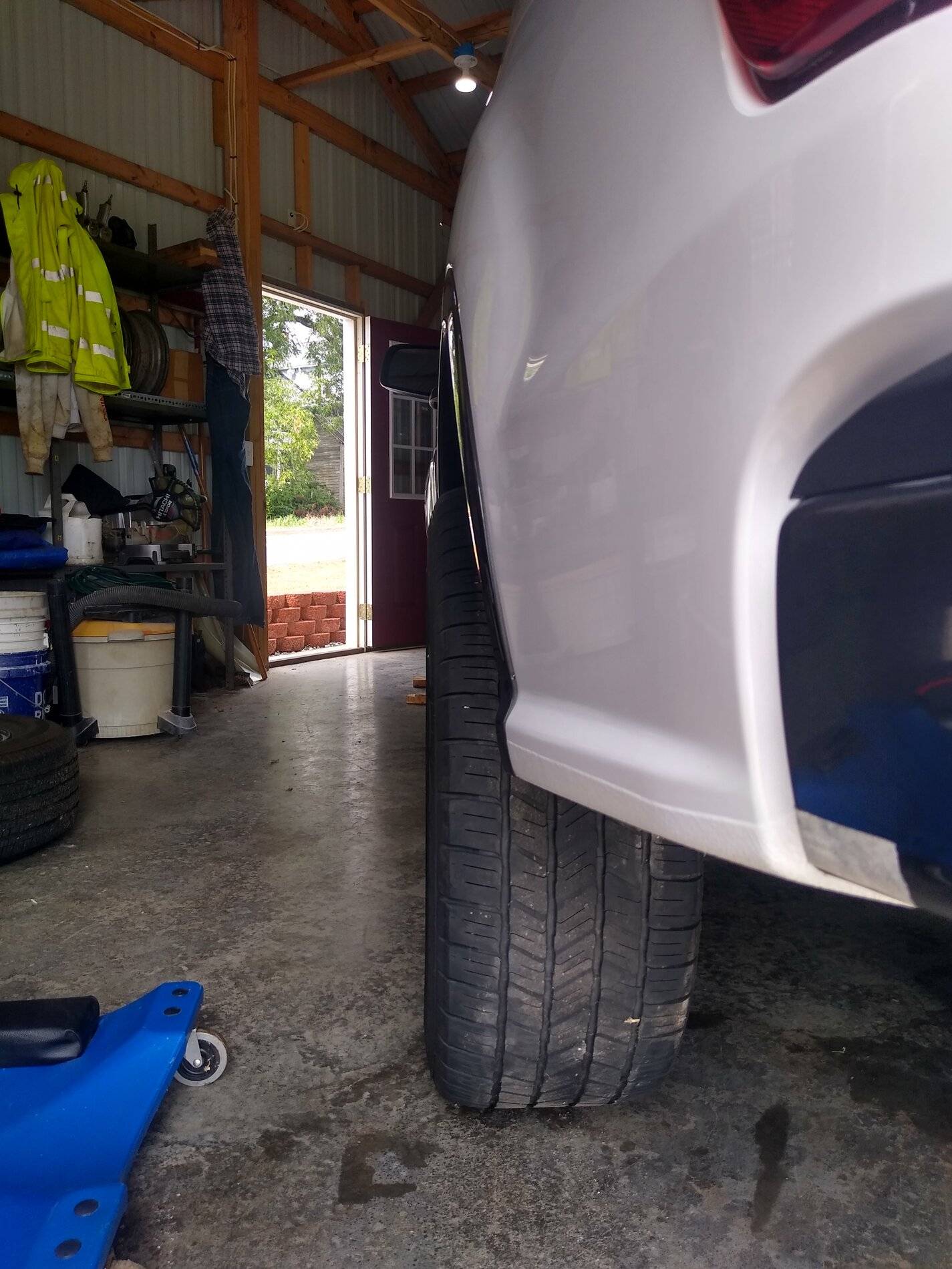

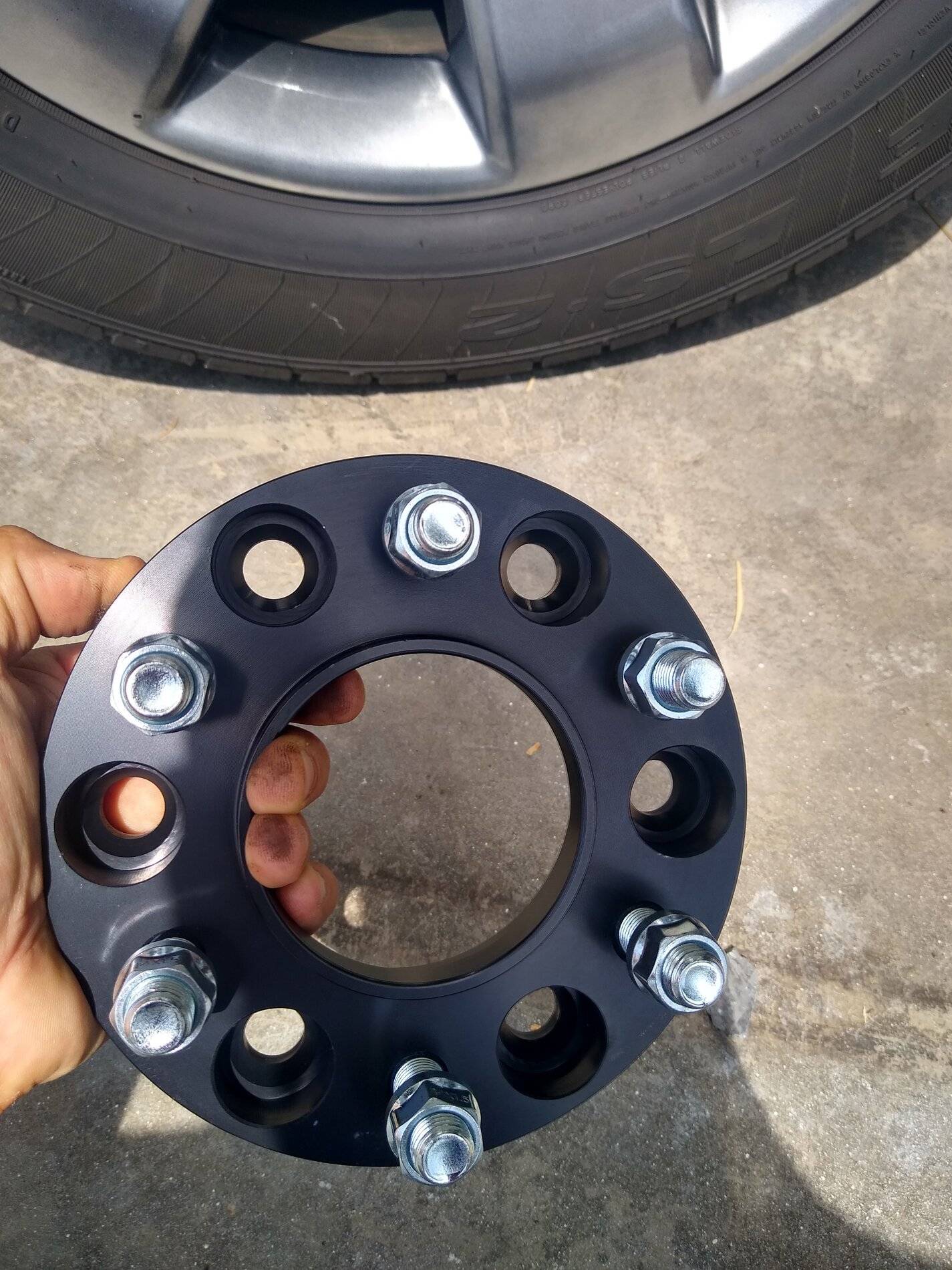

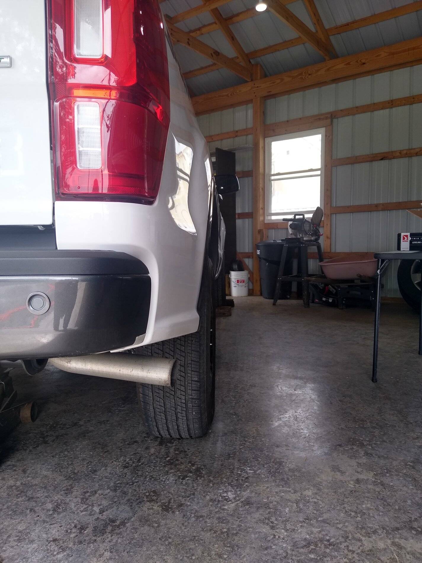

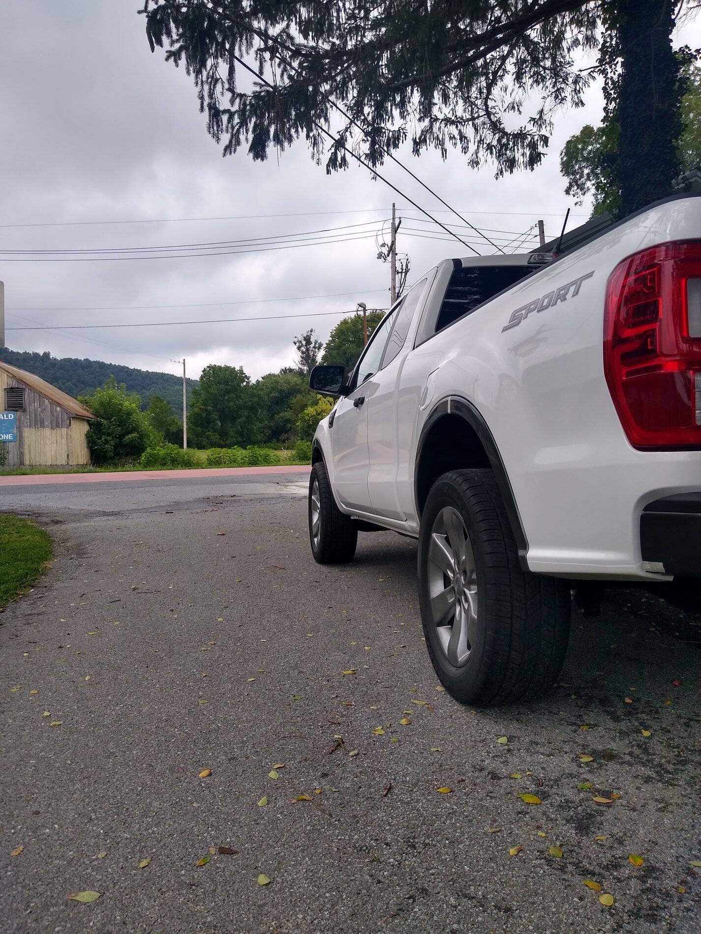

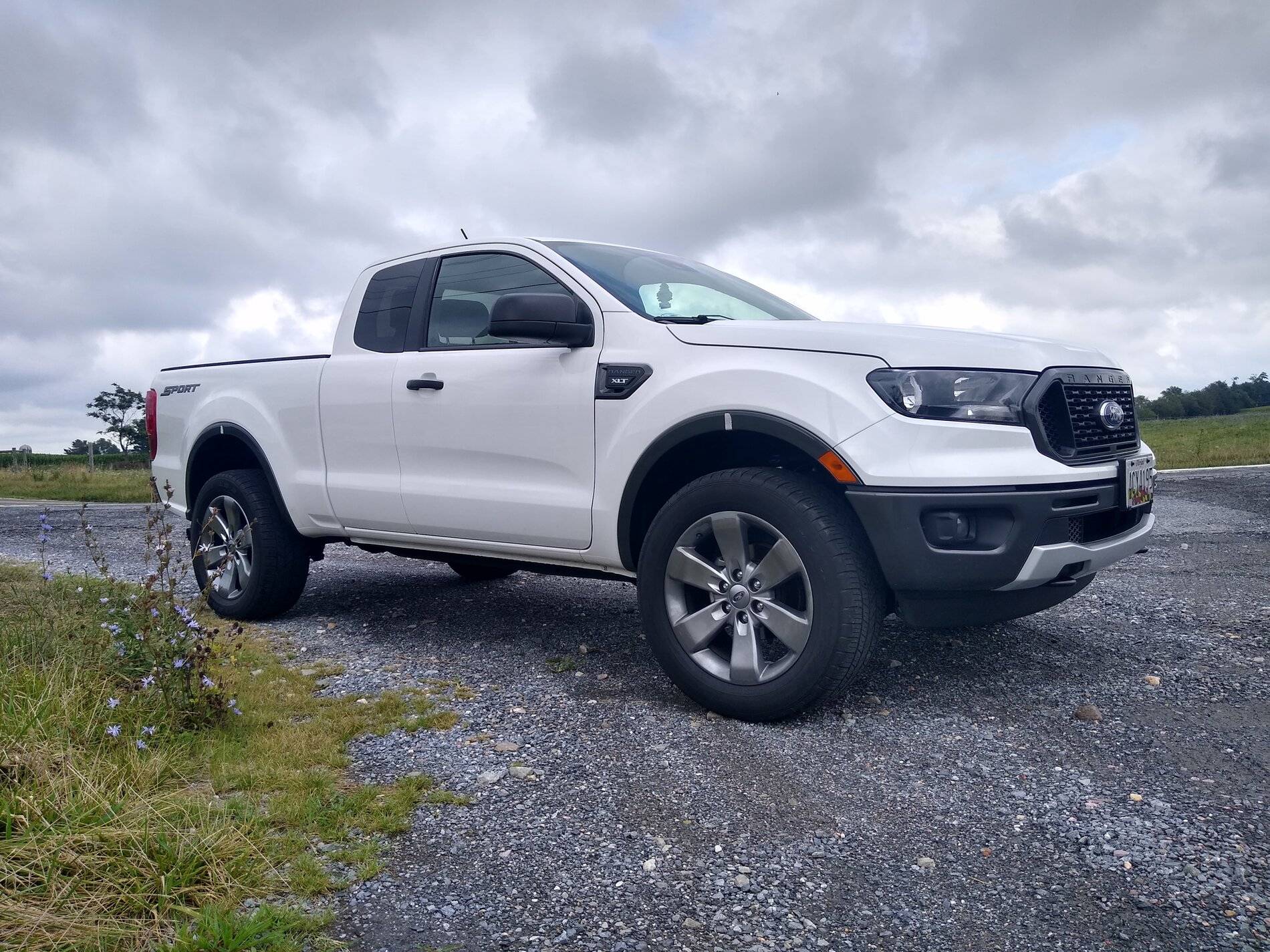

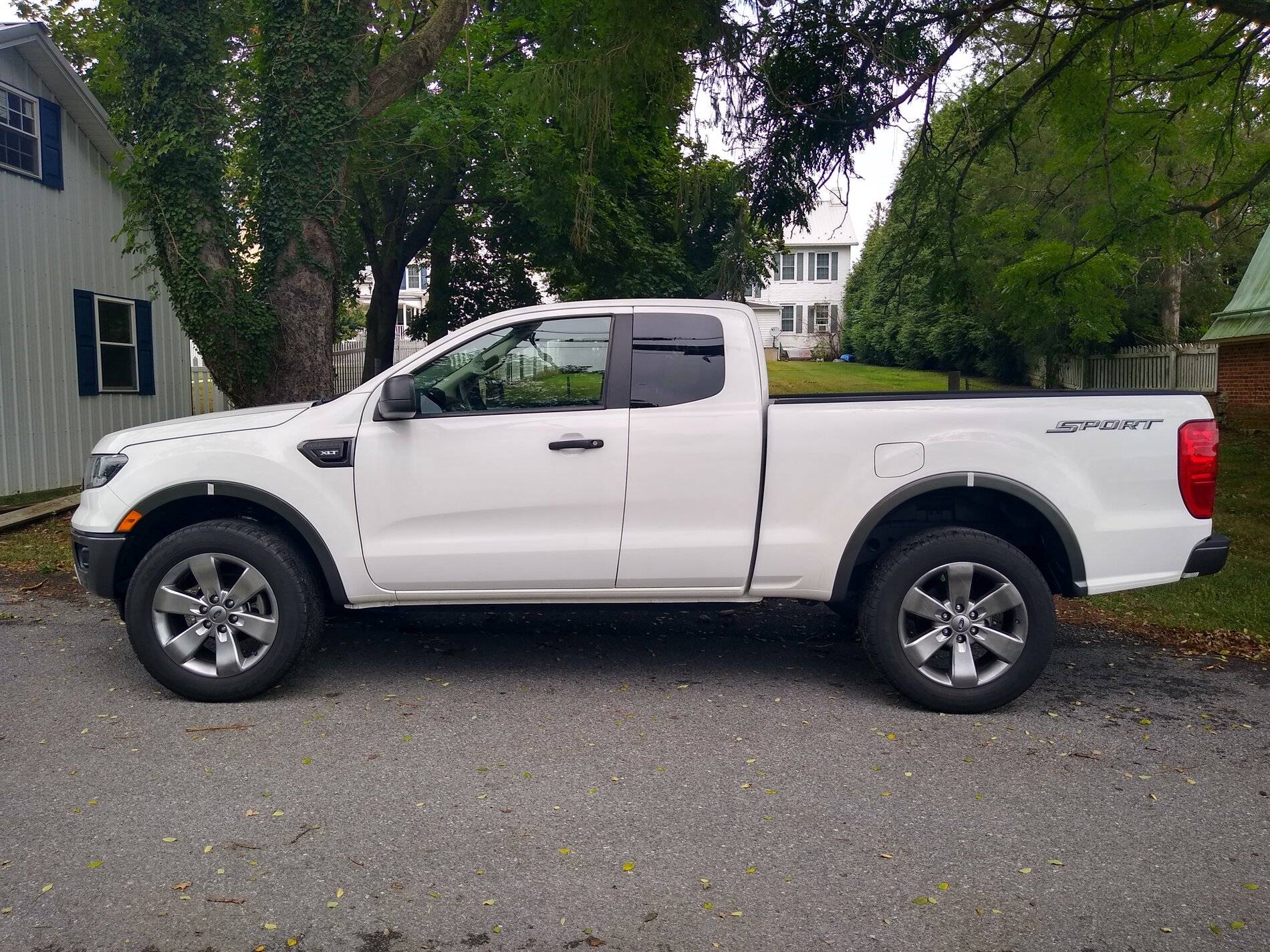

Tried out the new adapters and wheels today. Had some serious rubbing issues!
This was just a trial run before I swap the tires and install the lowering kit. Wanted to see if the TPMS sensors would work correctly and check fitment of the adapters. The sensors worked fine so that is a win.

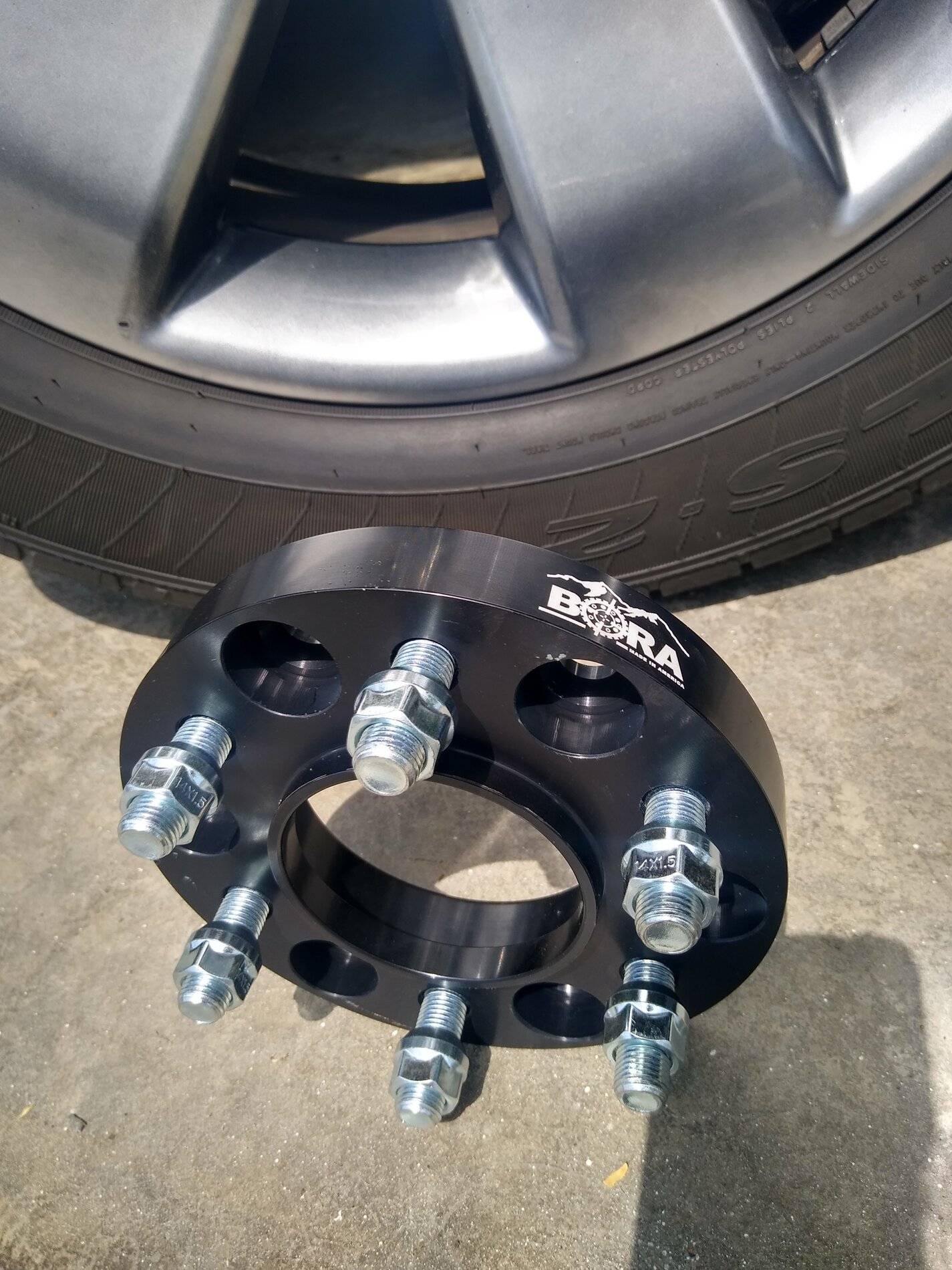

The Bora adapters worked perfectly! I used my stock lug nuts to hold the adapter in place and the supplied open style lug nuts to hold the wheels. I will order a set of F150 lugs when I decide whether I want to powder coat the wheels, may go with black.
As you can see in the pics the offset is kinda wide but I think it will be better with a narrower tire. The stock F150 tires are 275/55/20. I plan to go with 265/50/20. I am thinking that the shorter, narrower tire will not have rubbing issues especially when I lower the front and get the tires up into the wheel well opening and away from the crash bars. The F150 tires are approximately 31.5" tall and the Ranger tires are closer to 30"
So this shows that it can be done and I think this would be a cool setup for a 4wd truck looking to get a wider stance.
I will update when I get my lowering kit installed and smaller tires on the rims.

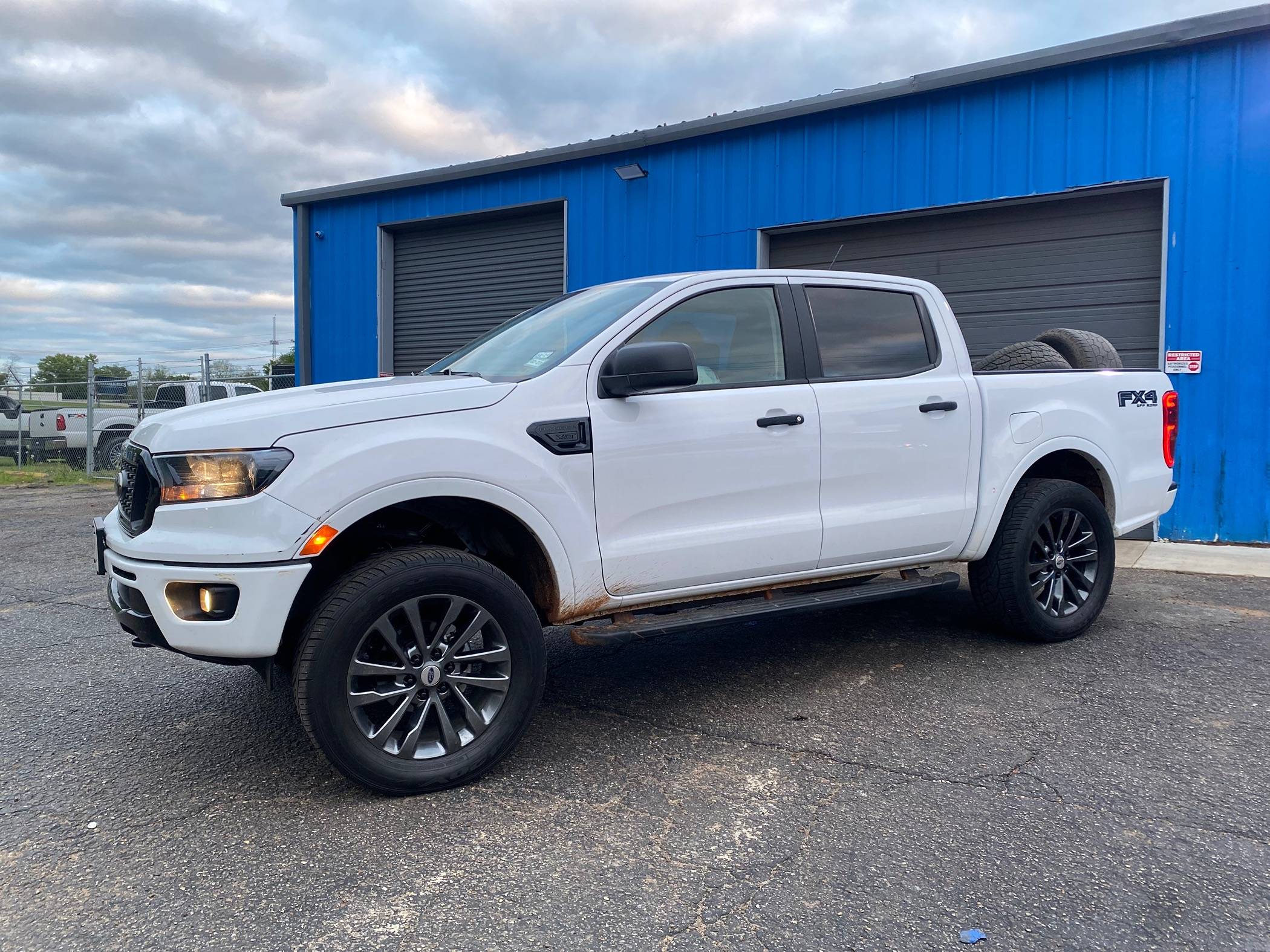

2.5” level kit , wheel adapters was told ranger pattern is same as Chevy . Don’t understand why Ford wouldn’t just go with their 6 lug pattern . Tires are just what I was running on Expedition 305/50/20 Nitto 420V . They do rub frame at full turn . Will probably downsize when new tires needed .
