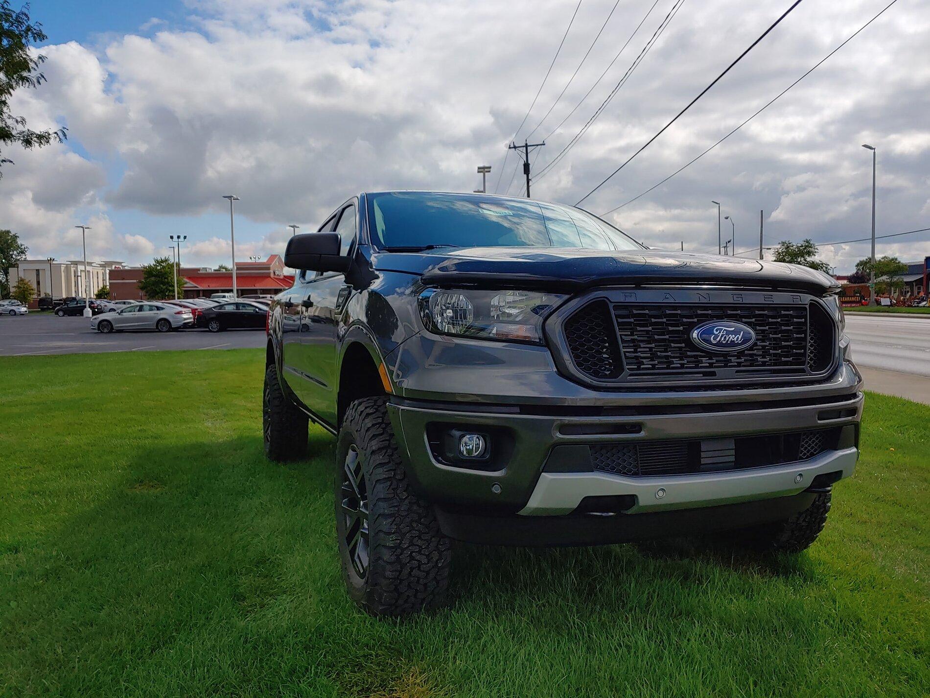

Is there anyone running the Ranger Raptor wheels with FX-4 size (265/65x17) tires without a spacer? I would just like to know how much space there is between the tire and aluminum knuckle.
I’m running the Raptor wheels with 265/70-17 Wildpeaks and there is around 5/8” to 3/4” clearance between the tire and knuckle. (just eyeballing it)

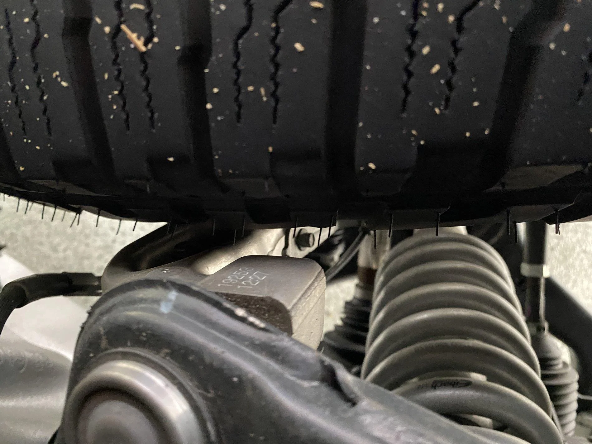

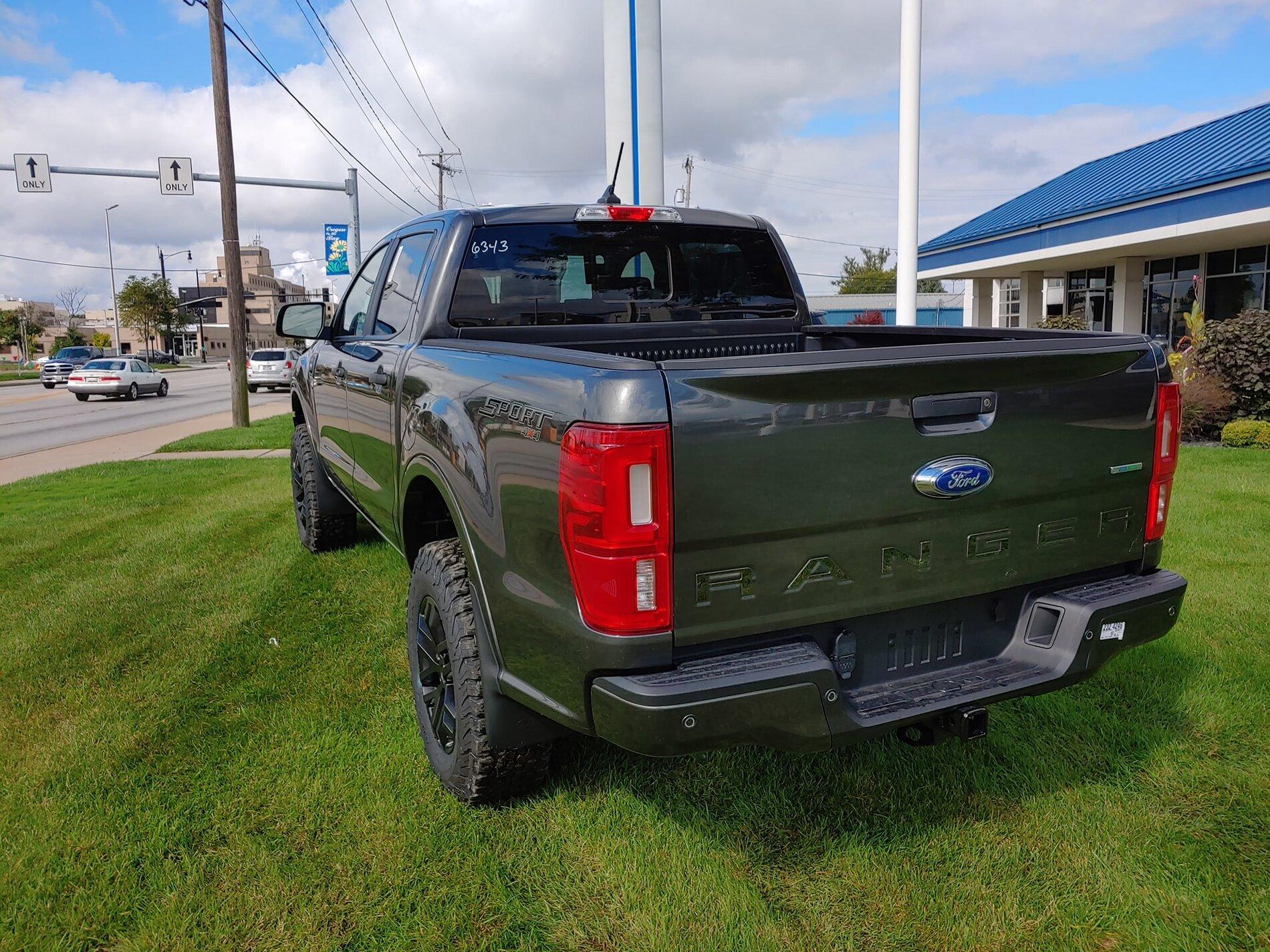

We did one at the dealership, RC 2.5 leveling kit, Ranger Raptor wheels, 265-70-17 BFG, 1.5" wheel spacer, VERY close to the spindle. Even Ford Performance says it's very close. Only took 5 days to sell it.
