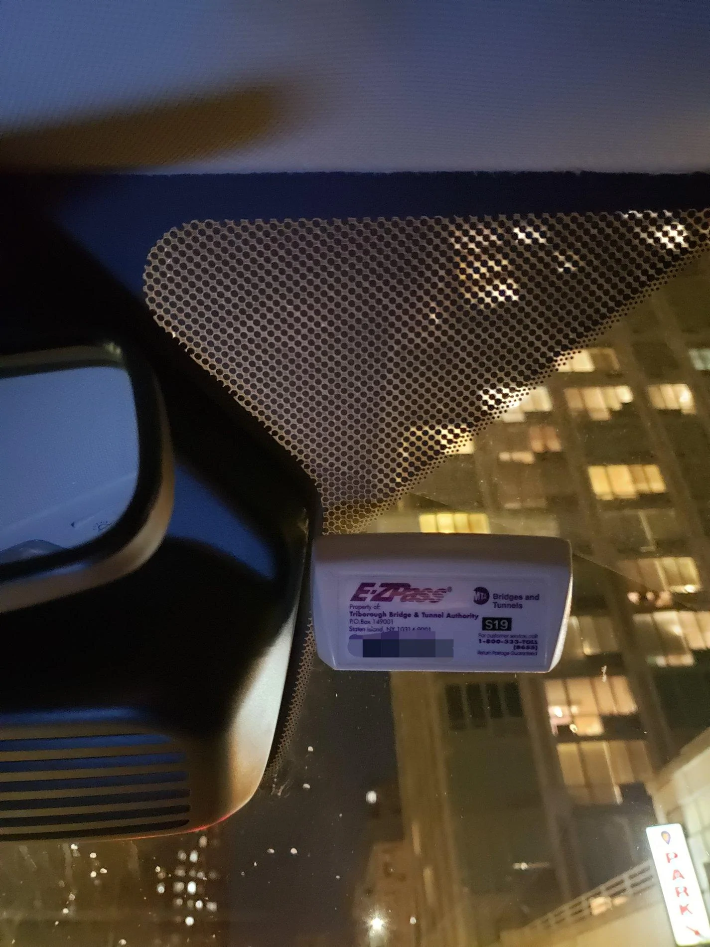

Placement on the Ranger windshield was a little tricky because of the large amount of metallic tint where I would have normally placed the transponder. Ended up mounting a little off center as seen below and it works great.
Another option would be an external tag. I have a plate mounted tag on my Wrangler because I wanted something a little harder to snag when the top is down.
