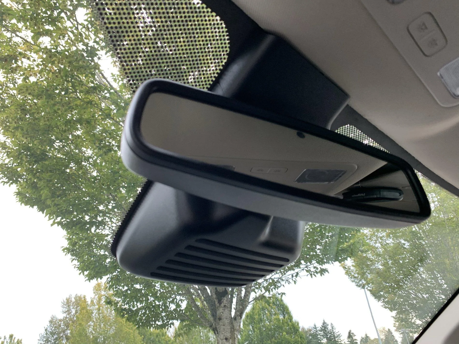

New Ranger XLT owner here. Not sure if this the correct section in the forum for this question regarding the windshield.
On the inside of the front windshield at the top, there is a huge black piece of plastic attached. The rear view mirror is attached to it. It looks like a vent, but I don’t think it is. What is this? I can’t find anything on it in the manual.

Thank you! I guess this makes it a bit more difficult if you ever have to replace the windshield and not damage the Co-Pilot360. Can it be detached and re-attached to a new window?

No need to worry on the windshield replacement. I had to get a new windshield on my Fusion which has similar sensors and camera in the same place. All went well and even the rain sense wipers work fine after that.

I believe you need to have the camera/sensors re-calibrated after getting the windshield replaced, though, correct? I seem to recall reading that somewhere.

I have a Tacoma, but it has the same style windshield vHad to have it replaced, it was expensive and they said it would possibly have to be taken to A dealership to have it calibrated. Luckily it didn’t, worked fine after installation.

I had the same thing on my Outback. The Eyesight seemed to work fine after the windshield was replaced so I called the dealer - if it wasn't calibrated after the windshield was replaced, they couldn't guarantee the Eyesight would function properly...I had it recalibrated (to the tune of $300+:curse:) because I didn't want to risk a fight with Subaru if there were any "issue" in the future.

Any reputable glass replacement shop should be able to recalibrate sensors. After they replace your windshield they will park in front of a large screen with an array of dots and lines in various locations. They hook up shop tablet to vehicle diagnostics port and sensors/cameras calibrate off screen of know points in front of vehicle
