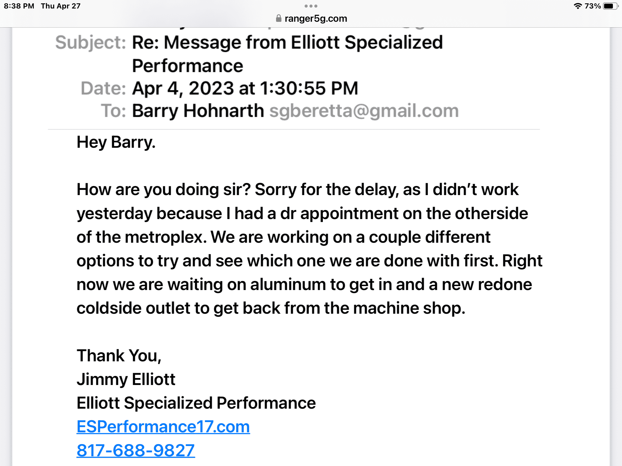

Jimmy replied to my email, So he’s is not going to ship my intercooler out till he comes up with a solution to the mismatched size, he said he’s got a couple different ways to fix the problem but trying to see the best way to do it. Only issue I have is he’s got my money since the 3rd but he’s a stand up guy so im going to see just what he comes up with..He said he’s going to keep my updated..

The latest I got from Jimmy::

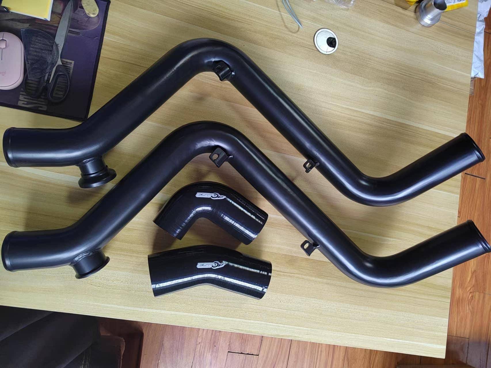

Hey Guys, how’s everyone doing? Yes, the piping we are doing is an aftermarket upgraded kit. You will get a cold and hot side kit free of charge. I would never just make a stock replacement pipe, that would just be awful. I attached a picture of our Focus ST hotside piping that we have been working on, just so you guys have an idea of the quality you will be getting. As of right now, we are still waiting on the silicone pieces for the sample to be made. This has put us a little behind, but we are getting close. Also, everyone should look for a email from us today as well. The email will be Giving updates and we are going to do a drawing for a free set of wheel spacers for everyone that has been waiting patiently.
Just make sure the mount for the BOV in the Ranger version doesn't cause them to rub the hood/hood liner. It's pretty tight and tilting the mount might give you clearance.
