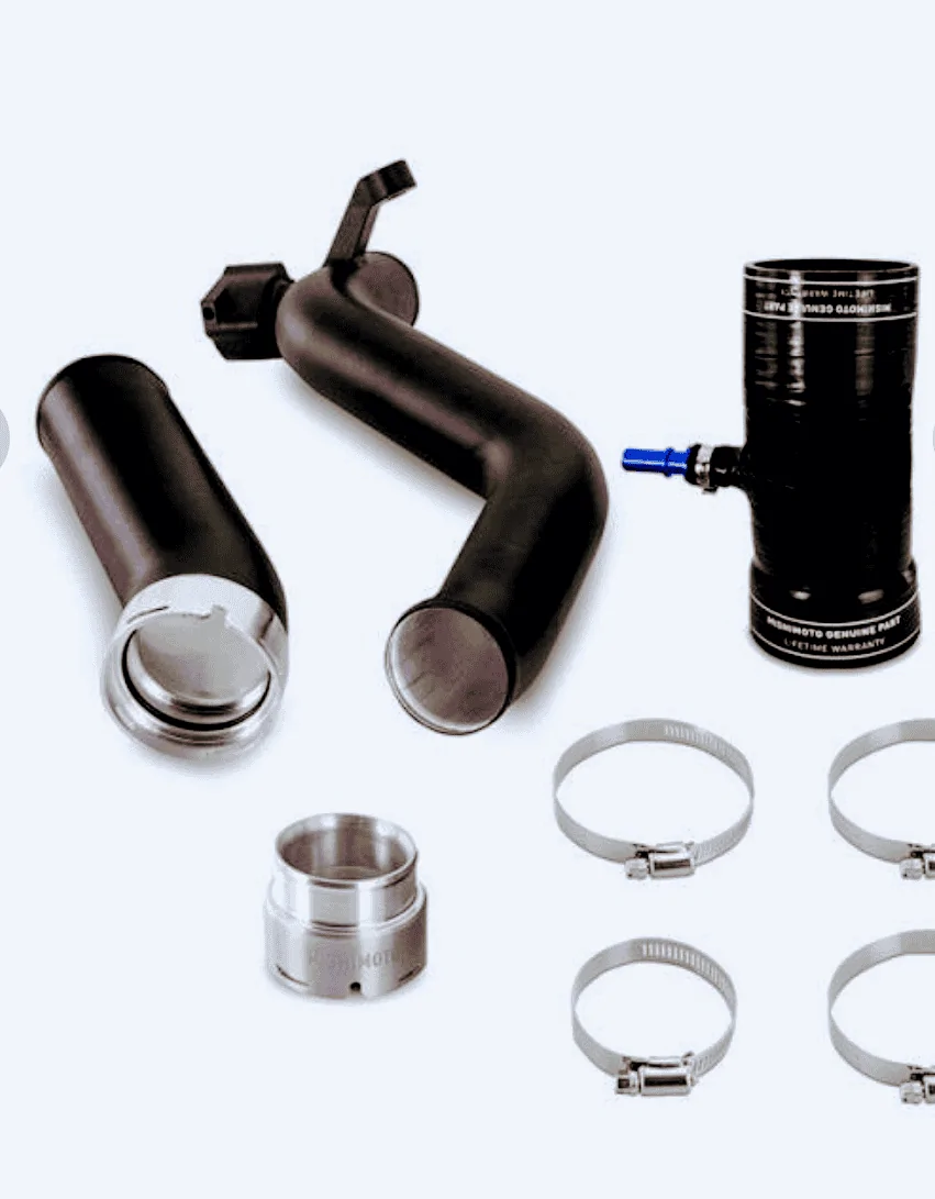

EDIT: in another thread discussing this it seems the 'defective' units have 68mm ends while the factory is 67mm. With metal pipes the difference would be no bueno so if that's what it is I'll be waiting ☹. Here's a picture of the Mishimoto pipes from their site:

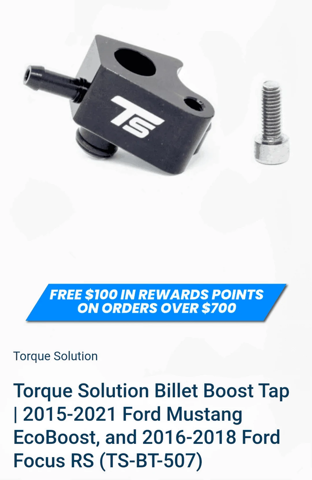

Not that I did it but Mishi had a spot on their pipe that is flat so you could tap for a boost gauge or water injection. I'll email ESP to see if they'll do it too.

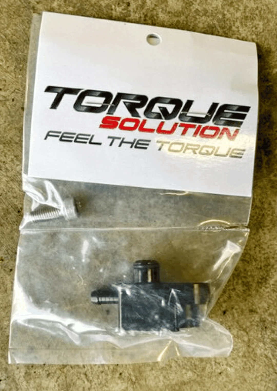

EDIT: after visiting the Boost Gauge thread I found there is an adapter that goes between the MAP sensor and the engine to provide a port for real boost gauges. Sounds more desirable to me than tapping the pipe.

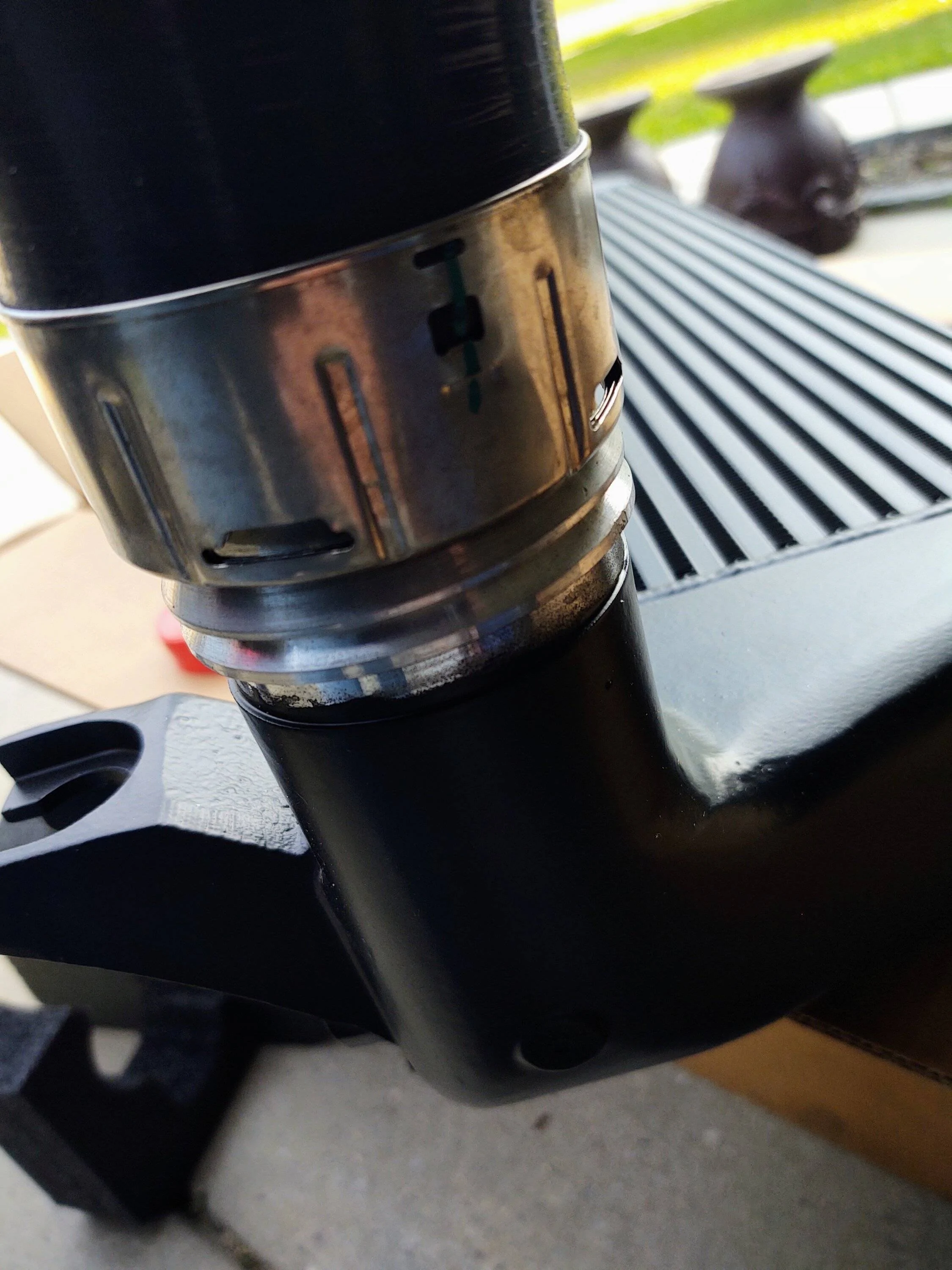

Mine arrived today unmolested but with the 'custom' 68mm cold side port. Guess I'm waiting for the 'custom' ESP cold side pipe.

EDIT: it's starting to look like all the 'flash sale' units have the bigger outlet on the cast tank? Don't know how that might have come about and whether ESP should have/could have known but really - if we all are using higher flow charge pipes the 'solution' shouldn't deprive us of what we spent other money and work on, right? Too bad it doesn't look like there's enough material to lathe down the single mm diameter - not that I could do that.

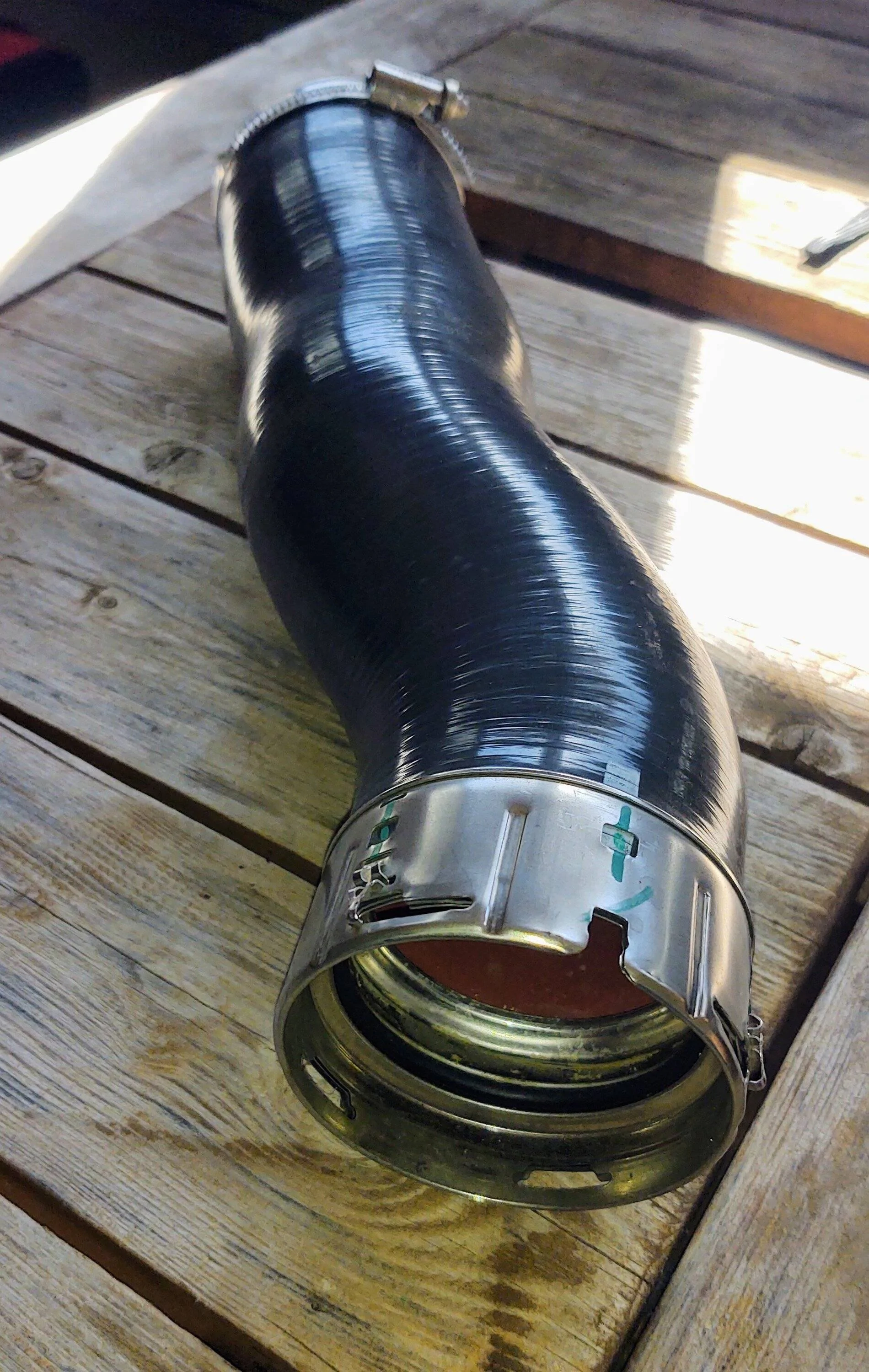

Here's the OEM cold side:
Frankly if ESP's solution is something that mimics Mishimoto's - whether it has a threaded bung or not - will be fine. If they can flare a pipe on the IC end and use a decent sealing clamp I would be pretty happy in spite of the delay.

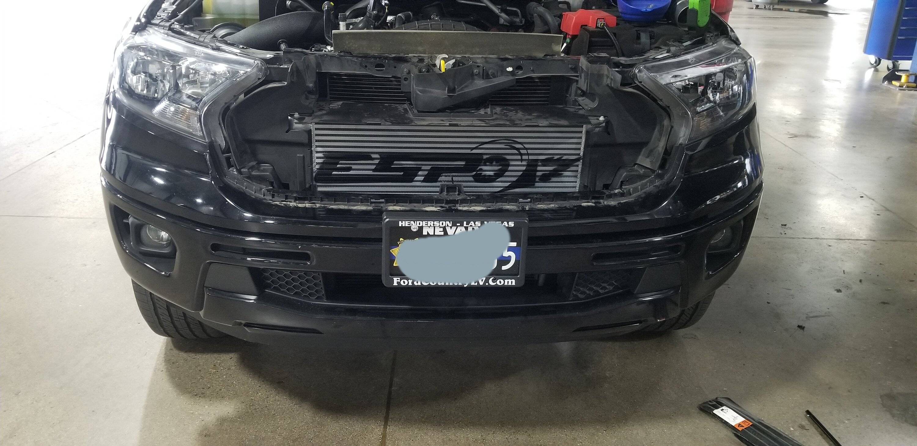

Got mine installed yesterday , cut the stock cold side hose at intercooler and slid it over the barbed section with a clamp for now , minor trimming needed on the plastic near lower end tanks mounting brackets
I'm on the fence about re-installing the factory cold pipe and cutting it up like you did to get mine in. If I end up returning the intercooler it would be a major pain to remove. After the major pain to install.
