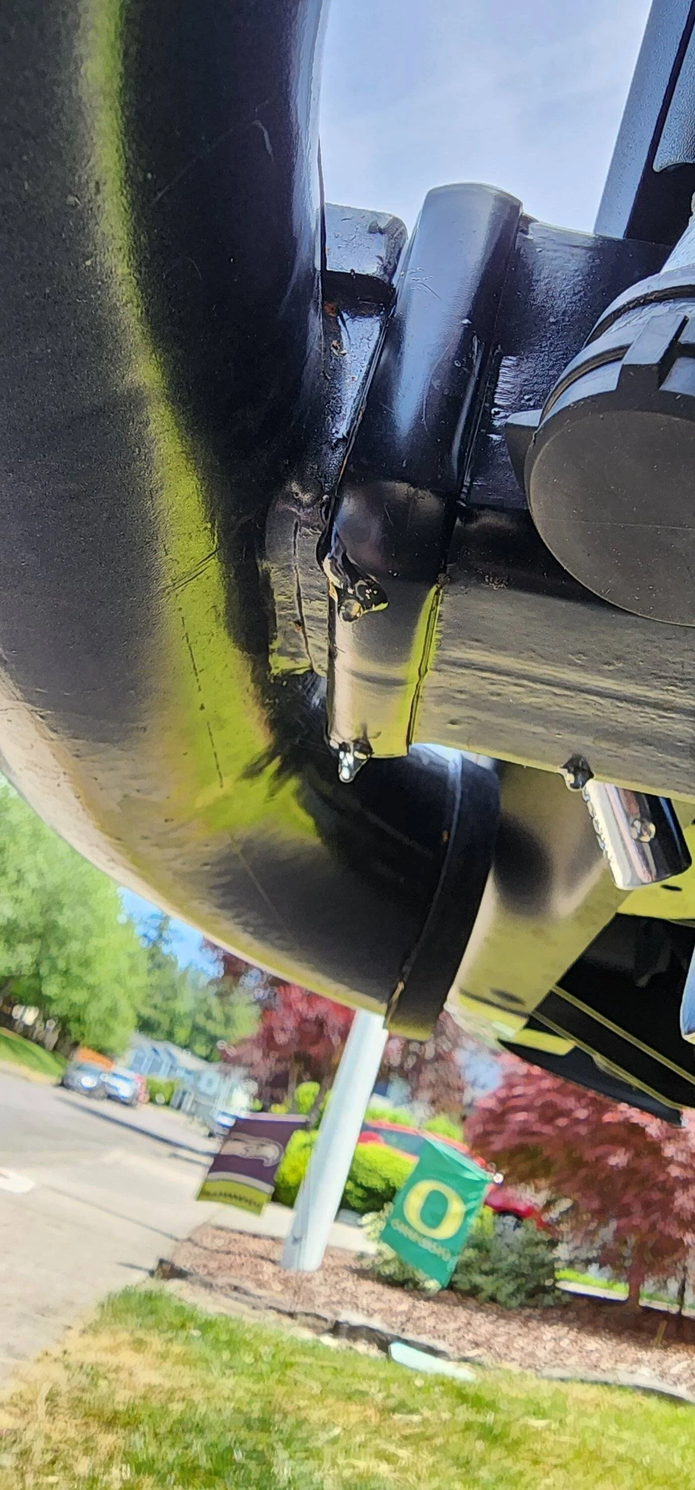

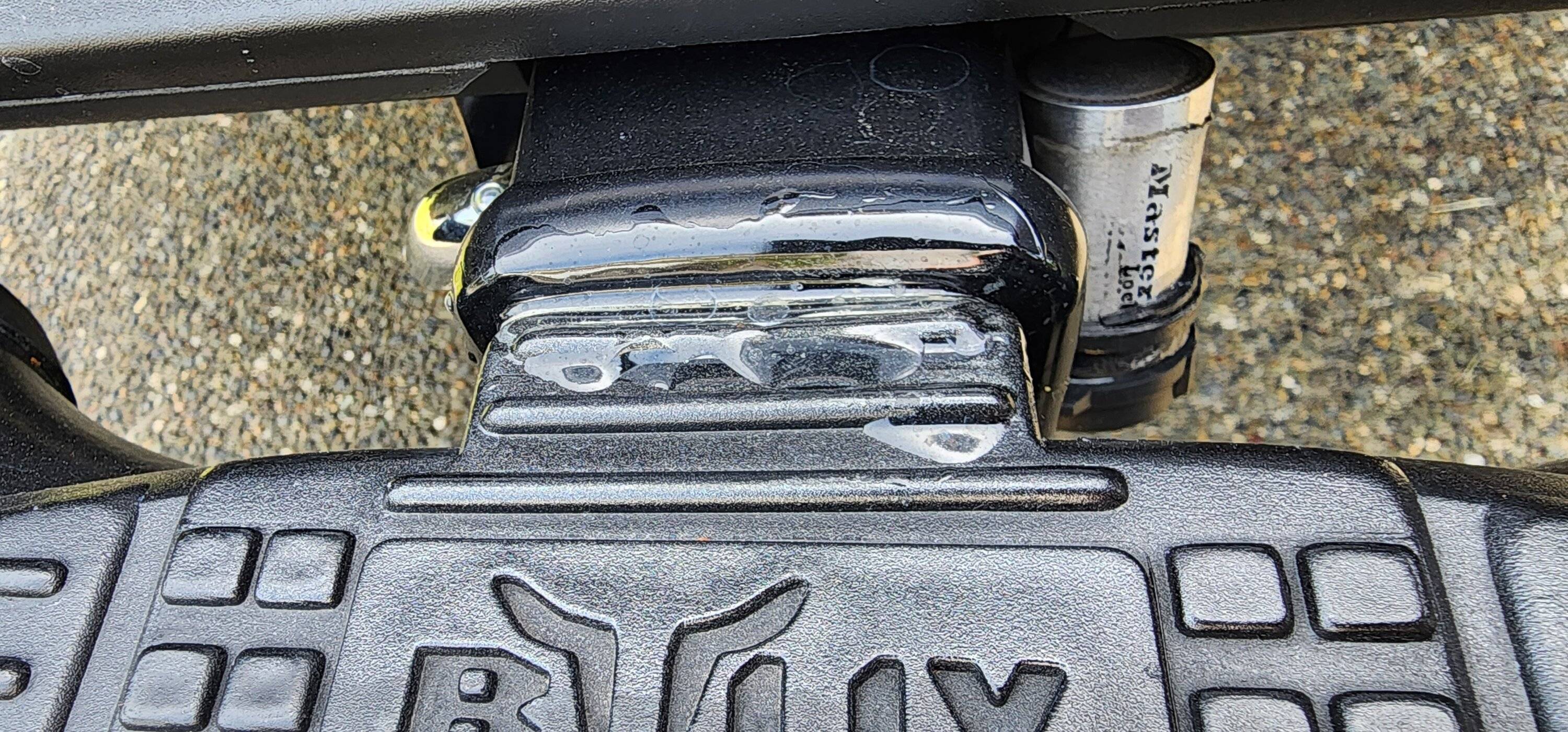

Epoxied trailer hitch step!?!? Why?

It looks to me like an obvious attempt to stop rattling. I hate that also and took steps to stop it, just not in this type of dumb ass way. ? I just tapped a fiberglass shim into the small space in the top and snapped off the extra, no more rattle.

Looking at it I don't think there is room for anything other than an anti-rattle pin. There's not much room between the step and the hitch.

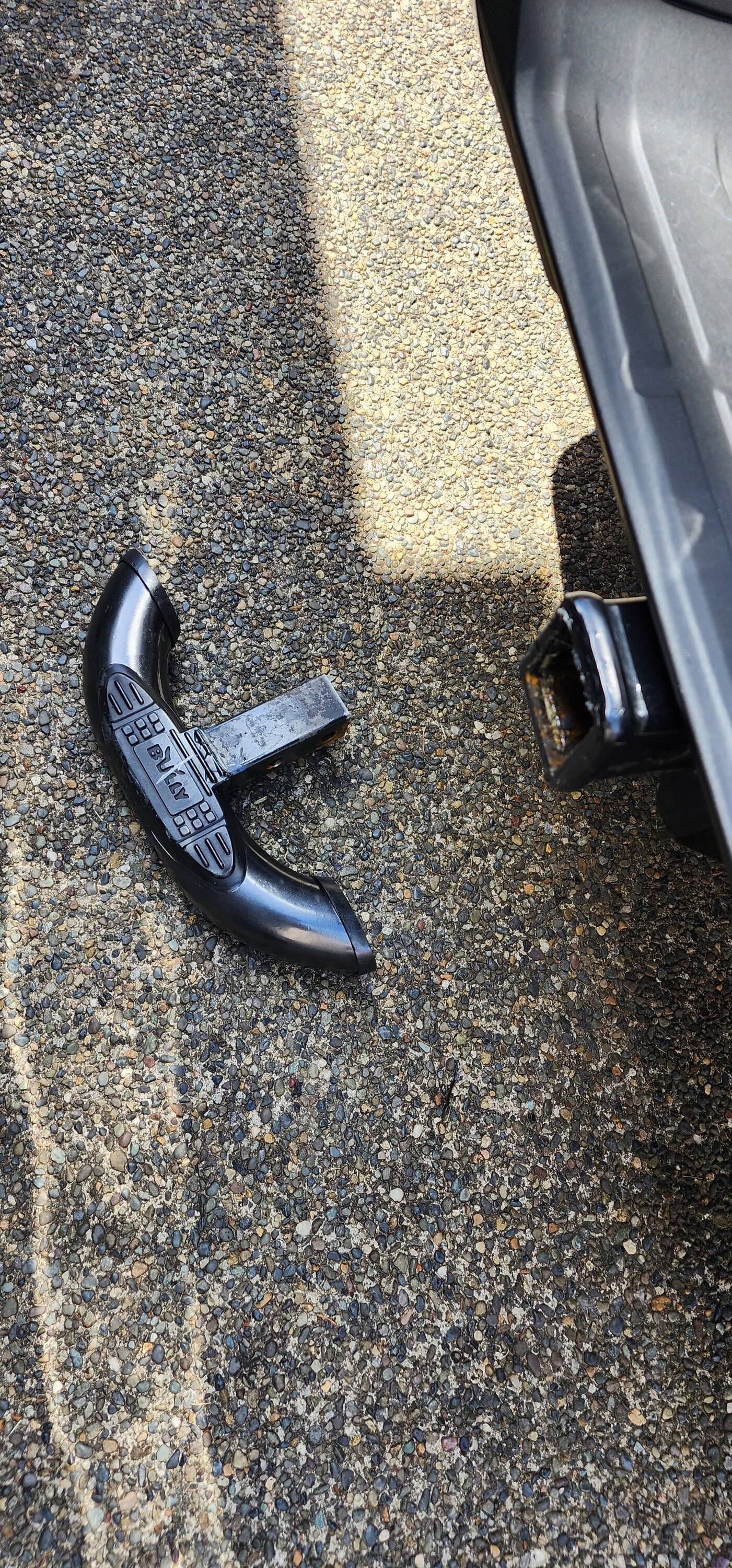

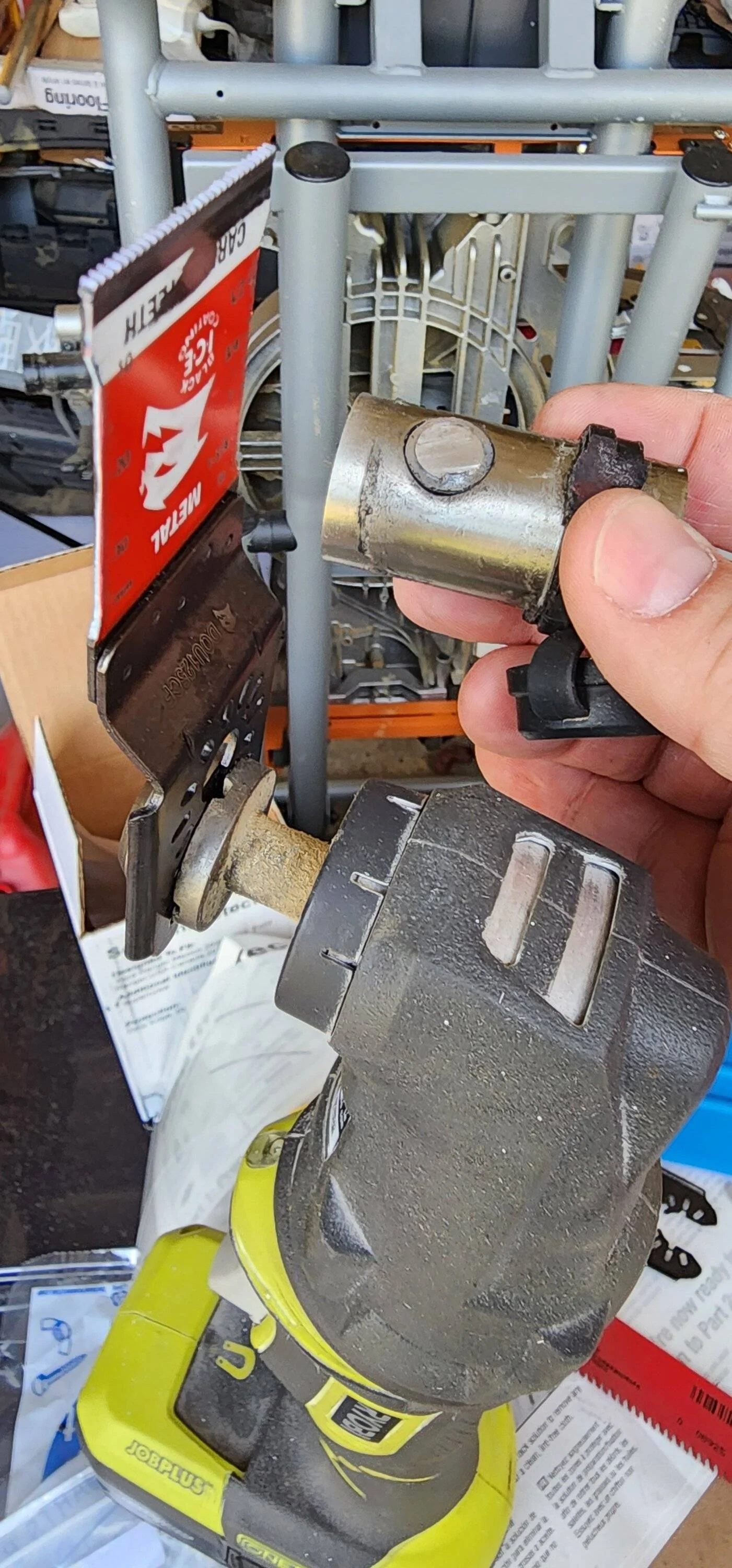

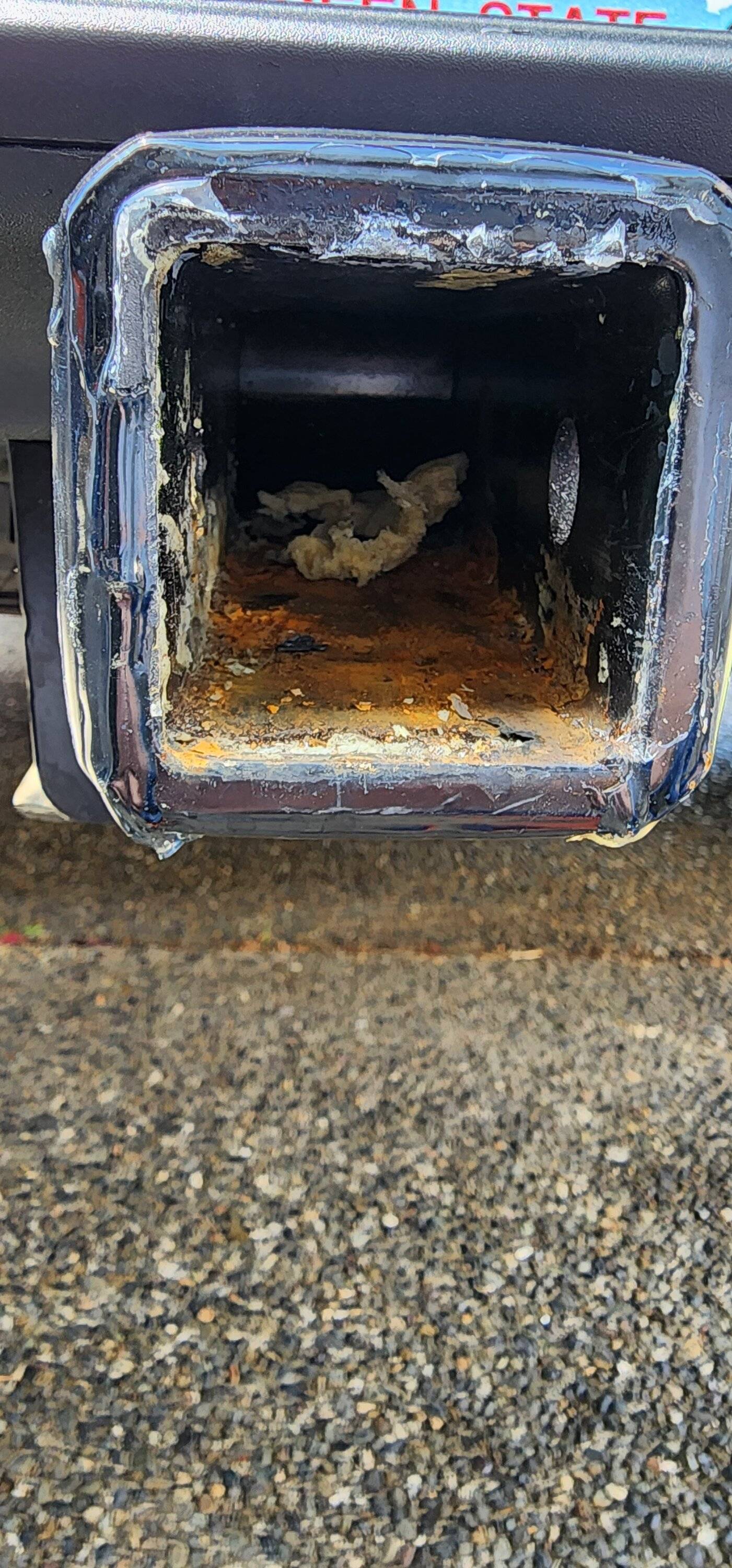

Well it wasn't as big of a pain as I thought it would be. About 5 seconds with the oscillating tool. Which was a bit eye opening. The pin was able to tap out way enough. The step required some pounding but I was able to wiggle it out.
