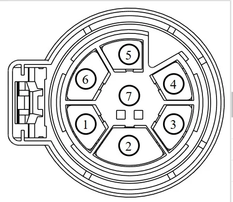

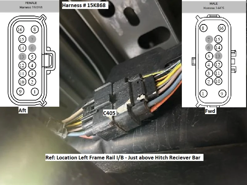

Ref- Associated Connectors that tie into the (Trailer-Connected Message)
Inspect for moisture and corrosion at these connectors
C4099 - Back side of 4/7 Connector
