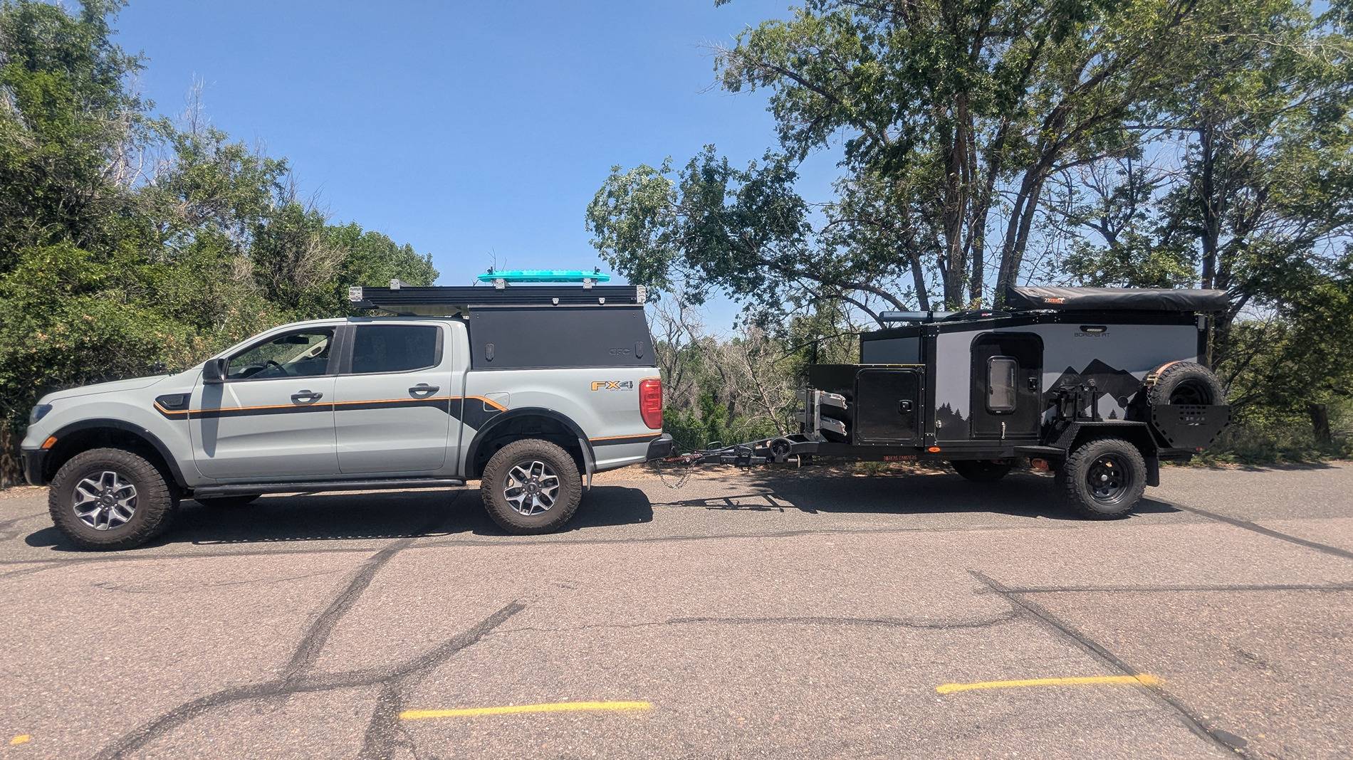

Also, from your pictures, it looks like the trailer is almost perfectly level with the truck. Being such a light trailer that shouldn't pose a problem......BUT....maybe try loading another few lbs to the front to give the rig a bit of heavier tongue weight.....shouldn't effect the Ranger at all, but may solve the problem.
