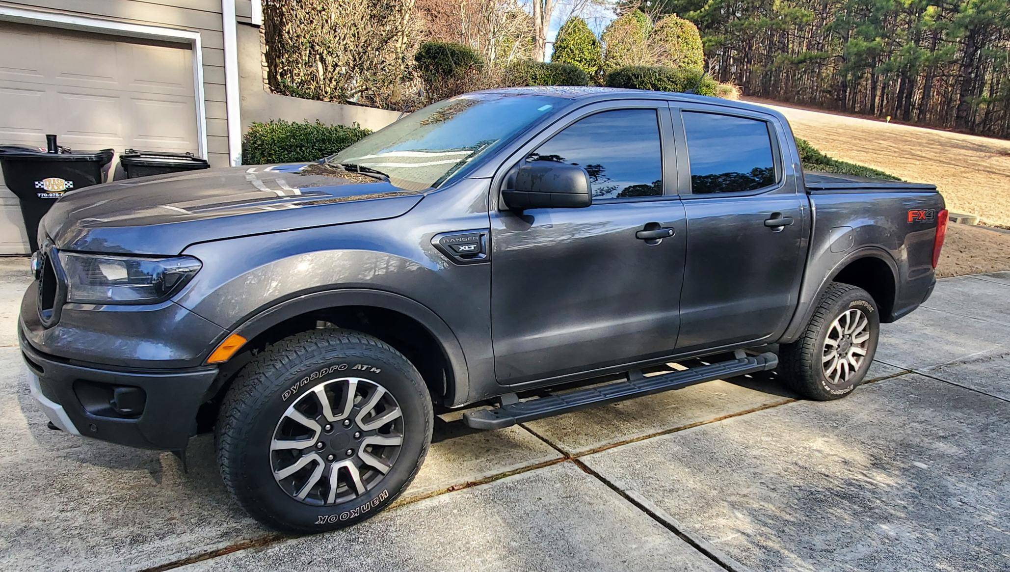

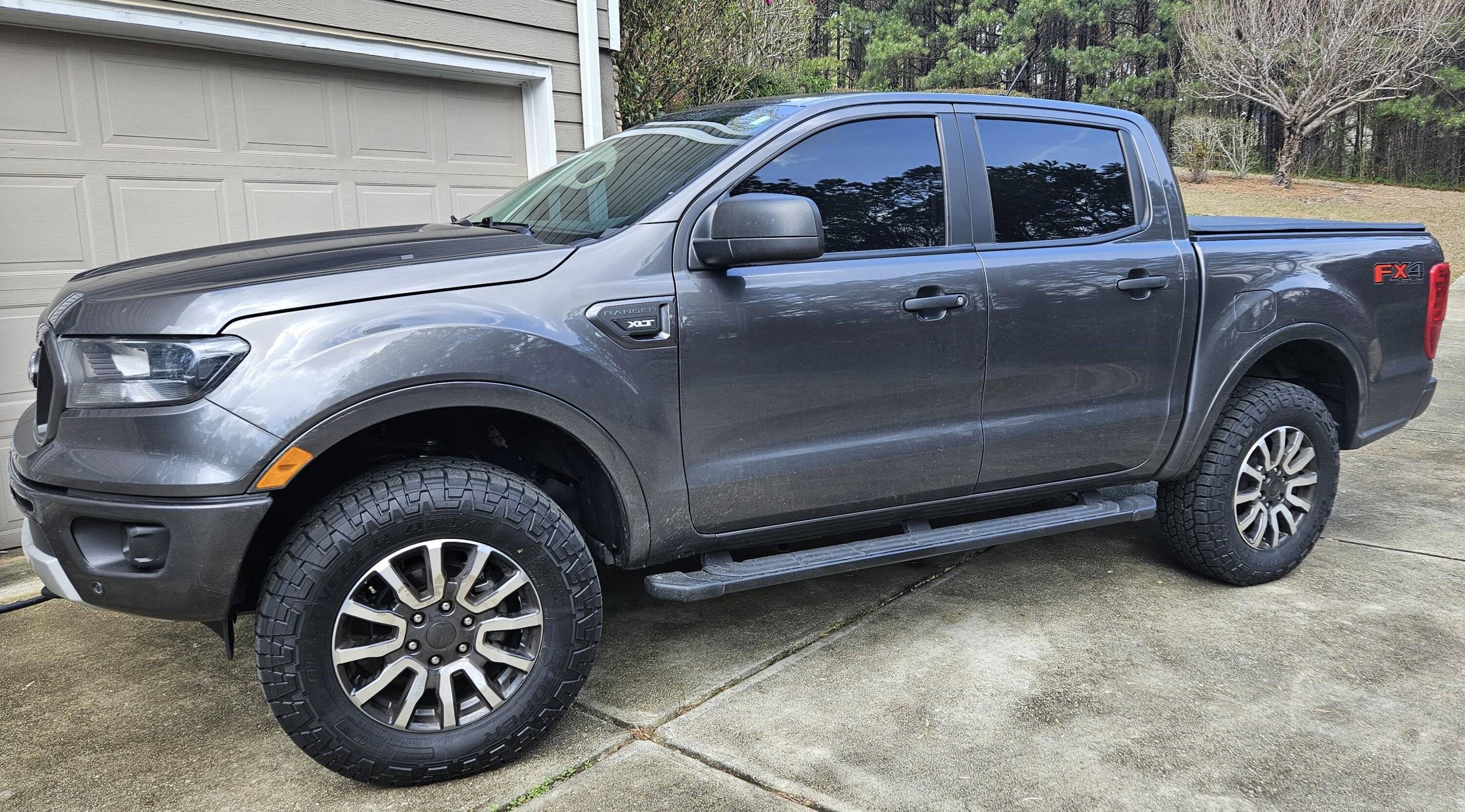

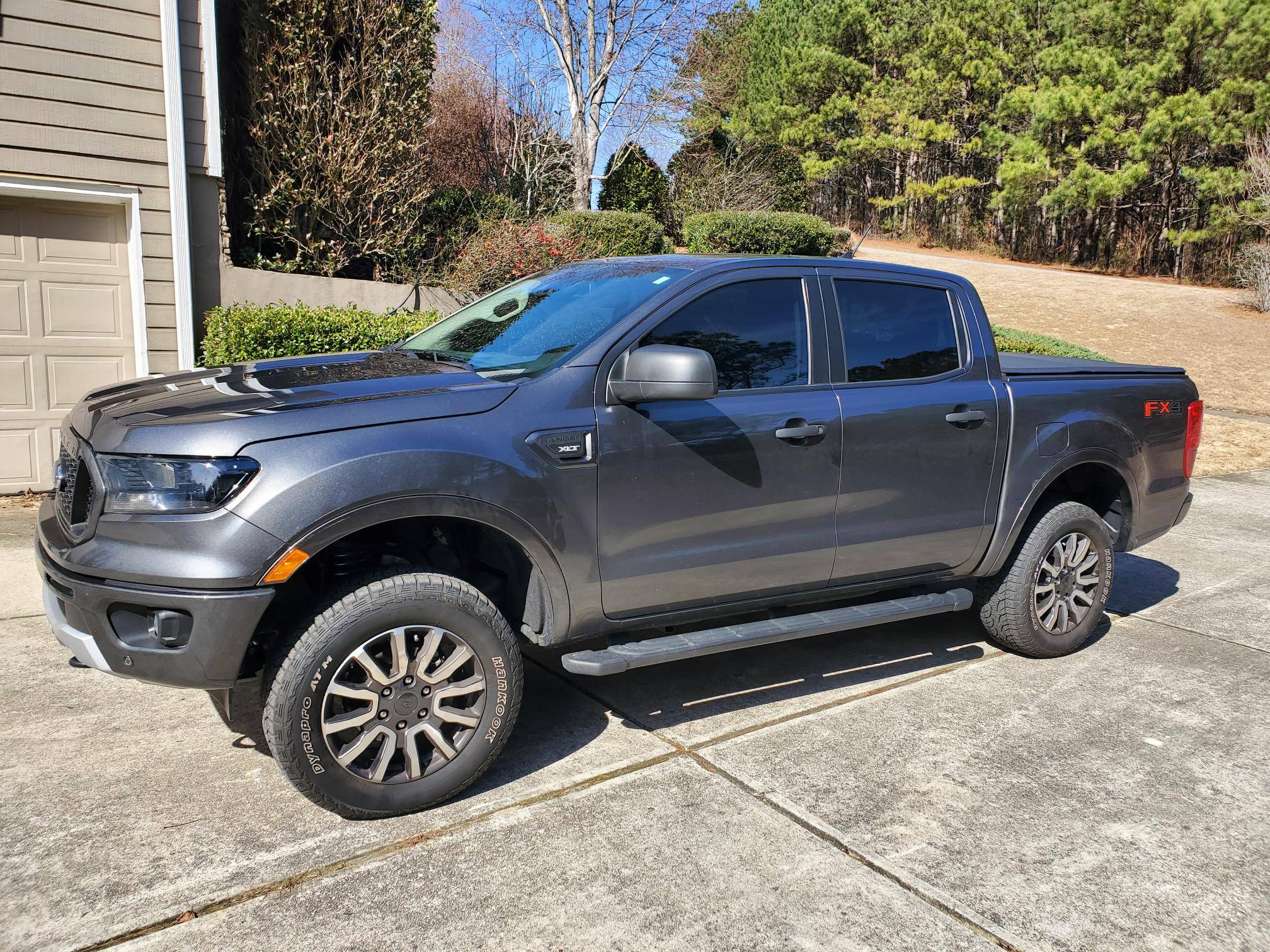

So, here's a before pic and after pic, with stock tires. Probably doesn't look a whole lot better without new tires on, but you can tell there's more room for tires in the wheel wells now.
Before:
After:
I haven't driven it much yet, but the initial feel is that body roll is gone, and it seems solid. It was a little odd the first time driving it, because with rake gone, I felt like I couldn't see over the hood.
I realigned the headlights, mostly, last night. They will probably need a tad more tweaking.
So, this was a bit of an ordeal, but, so far, I'm happy with the results.
