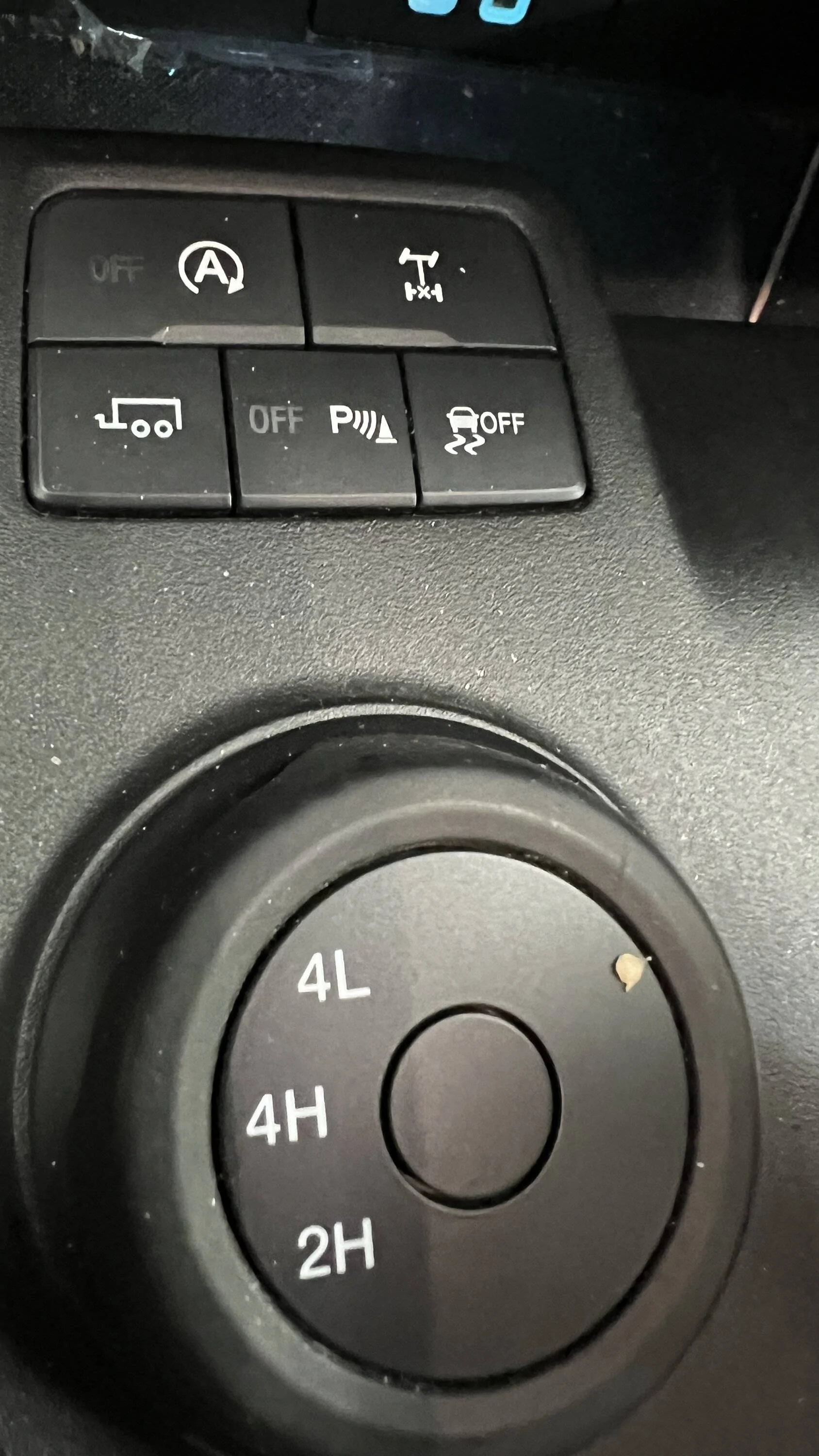

I had the same dilemma. Just activated the trailer button ahead of my shifter on the console. Magic!

Had the same problem. Looked all through the OM. Nothing. Nada
But the middle button on the bottom row in front of the shifter is the Parking Alarm Disable. On/Off.
We attach a bike rack in the trailer hitch to carry our bicycles. The Alarm was on constantly when in Reverse.
I pressed the button and like magic the alarm was quieted. On/Off works every time now.
