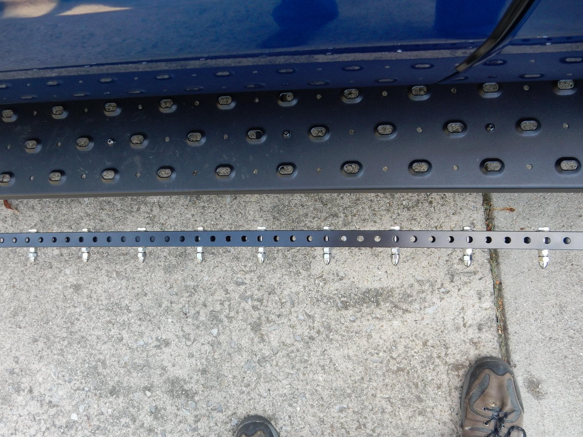

- I'm curious to see what it looks like when you are done.
Me too;)

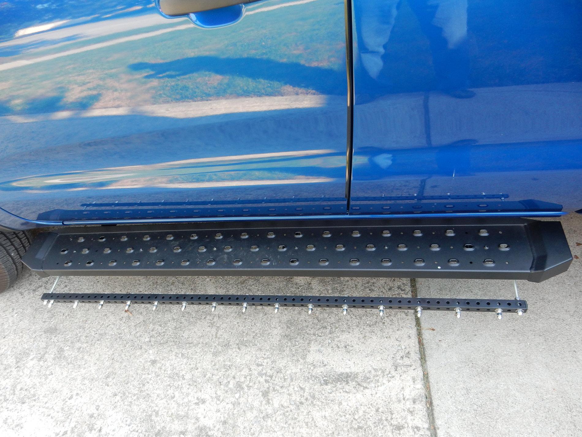

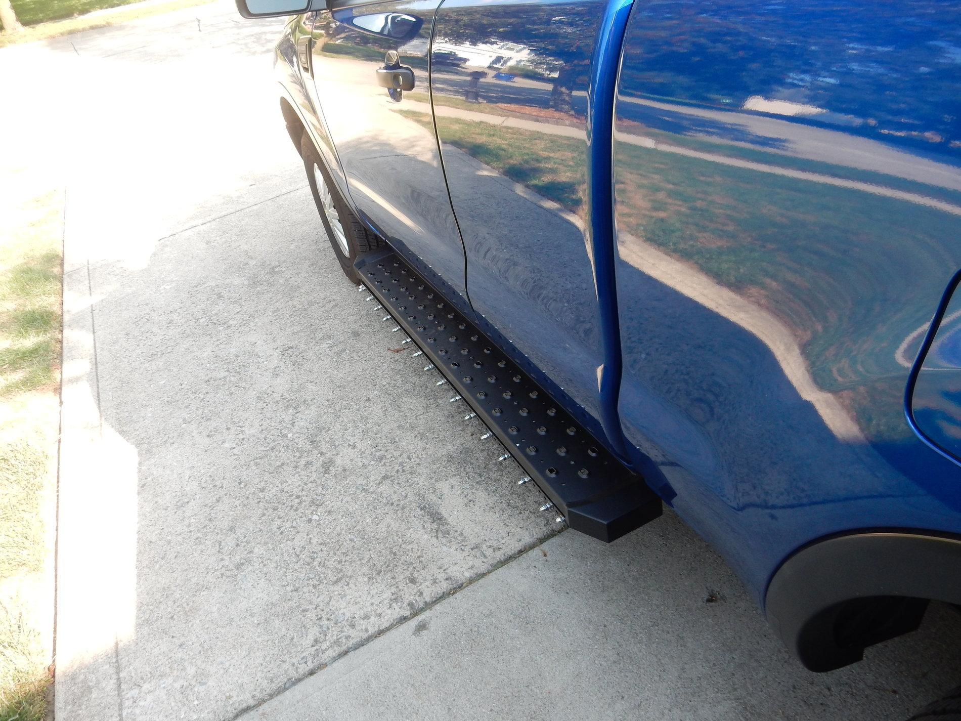

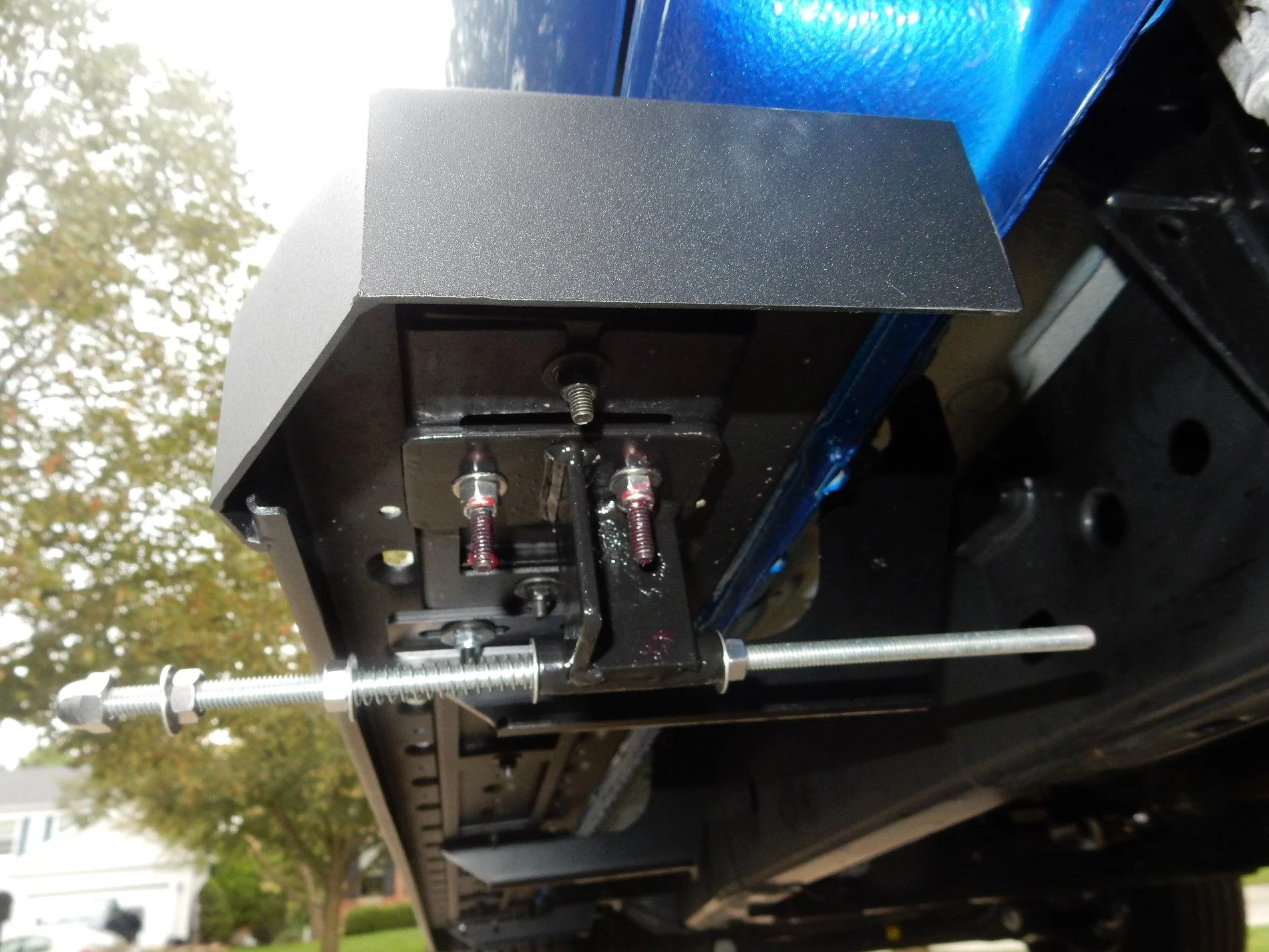

Pictures below starting with the normal ornament bar adjustment and ending with the Mad Max adjustment. (user defined) I am still missing some small parts from vendors - you can see two "normal" acorn nuts as opposed to the high crown acorn nuts in the following pictures.;)

Picture 1

Picture 2

Picture 3

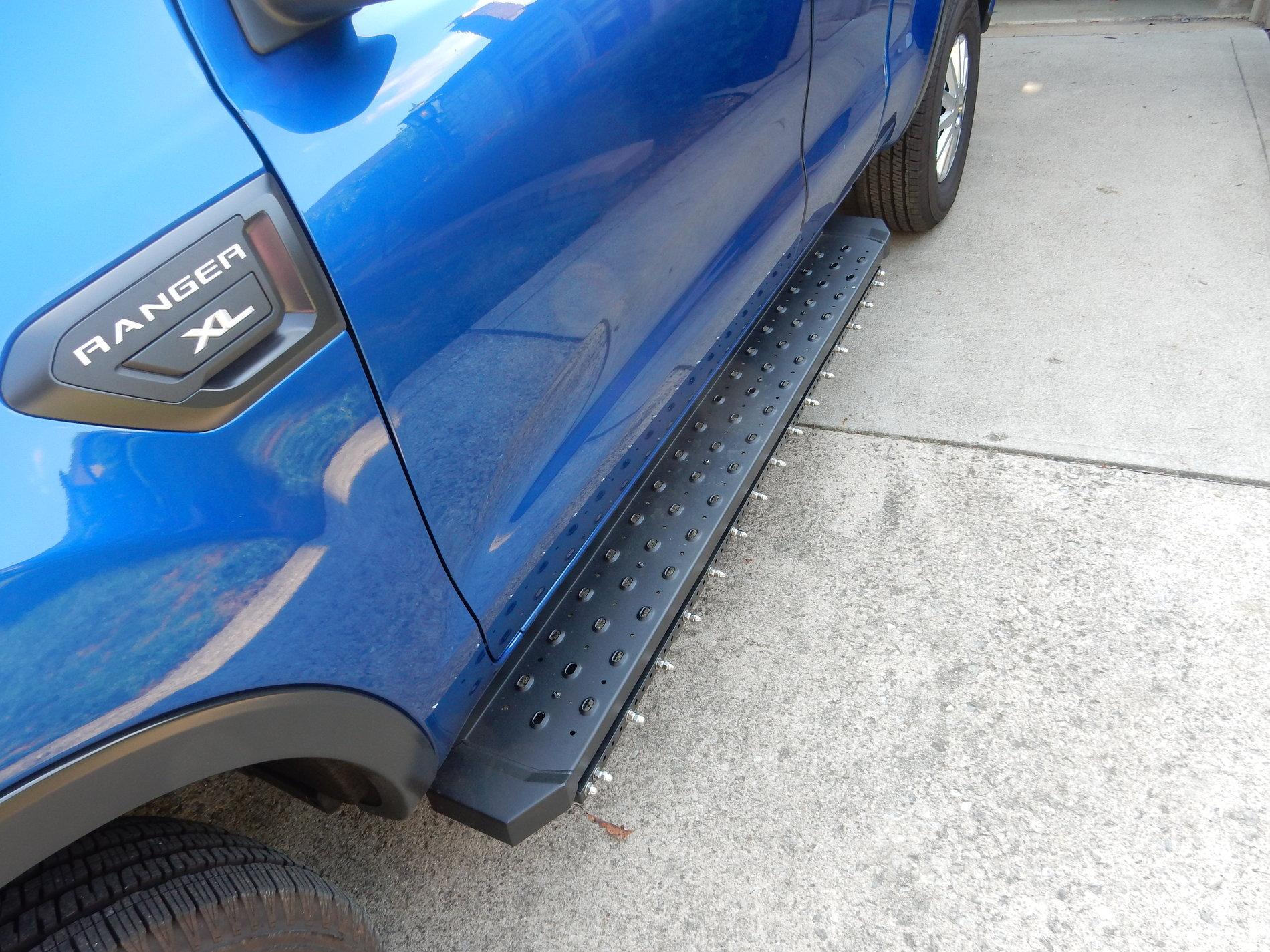

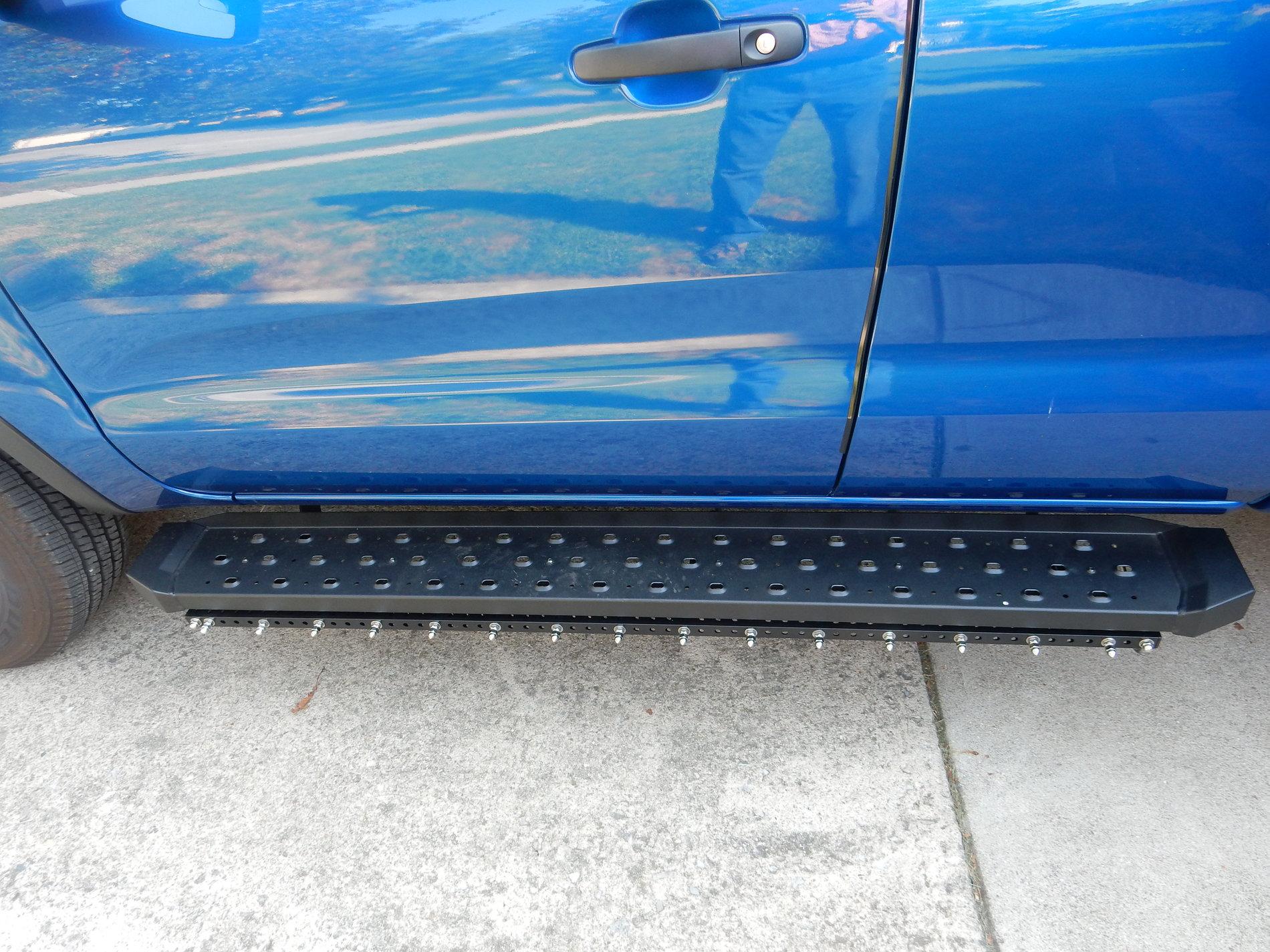

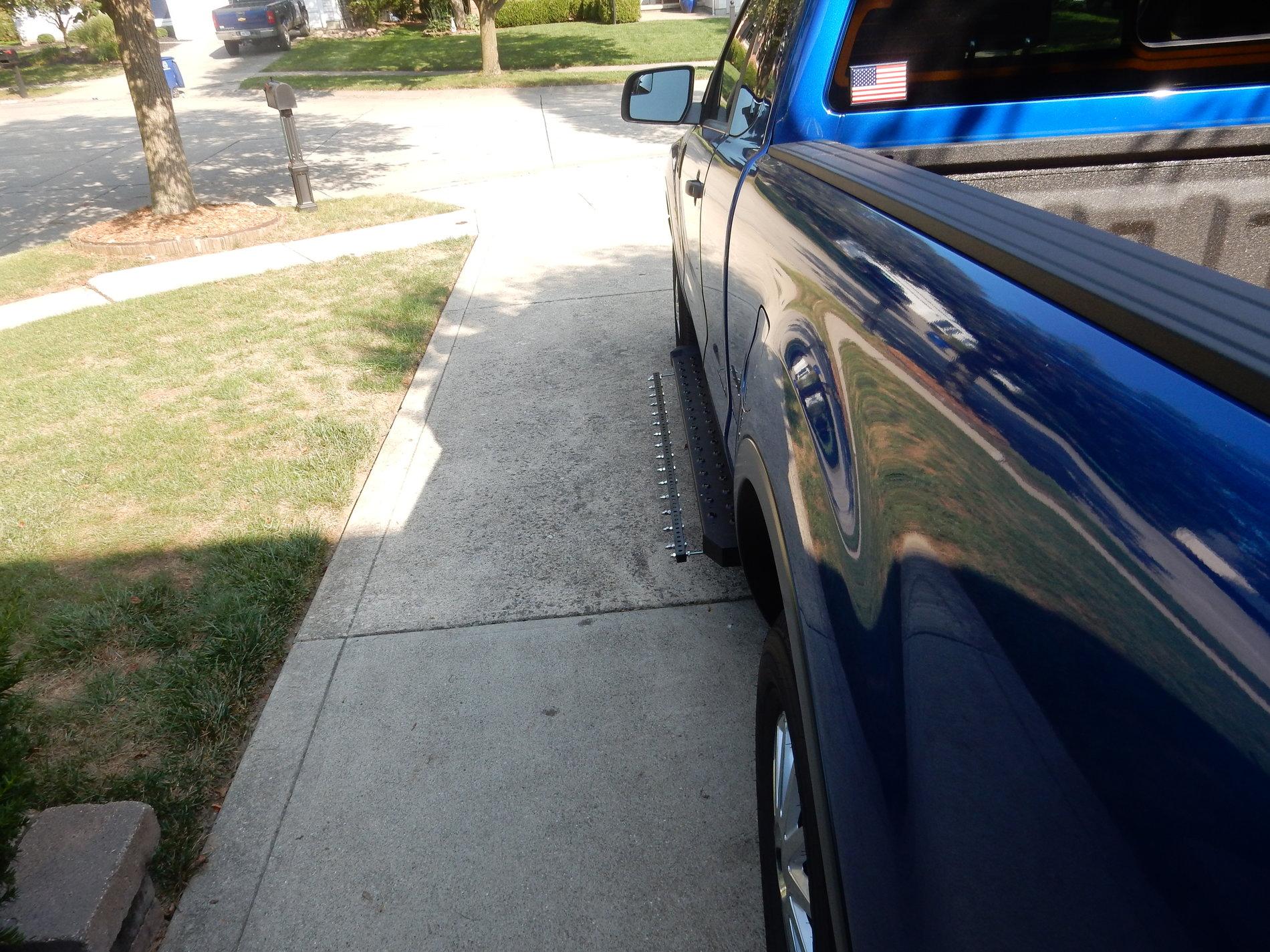

***********WARNING! *** WARNING! *** WARNING! ***************
The following pictures are very graphic of my Ford Ranger and if you think you might feel nauseated by viewing these pictures please immediately exit this thread and seek medical help and advice.
The pictures (below) might give an insight or some clue to why the careless door dingers are "NOW" very hesitant to park beside my lightning blue Lone Ranger with "special" shiny chrome ornaments.
I would like to take a picture of the look on peoples faces when they approach my new Ford Ranger, with the shiny chrome ornaments, to park beside it. I believe the look would be of extreme horror and fear. It would give them "a moment of pause" before deciding to pick another parking spot far, far away from my Ford Ranger.

Picture 4

Picture 5

Picture 6

Pictures #4,5 & 6 (above)
Shows the STX 600 Running Board with attached chrome ornament tubing "adjusted" for extreme and very aggressive door ding protection. I call it "Mad Max" door ding protection. It is very possible to easily "side swipe" other vehicles while driving BUT before that happens your left or right mirrors will fold and/or disappear first. :frown: Also, extreme care will be needed when entering and leaving from the Ford Ranger using "Mad Max" adjustment due to the "extended" ornaments far away from the running boards.
