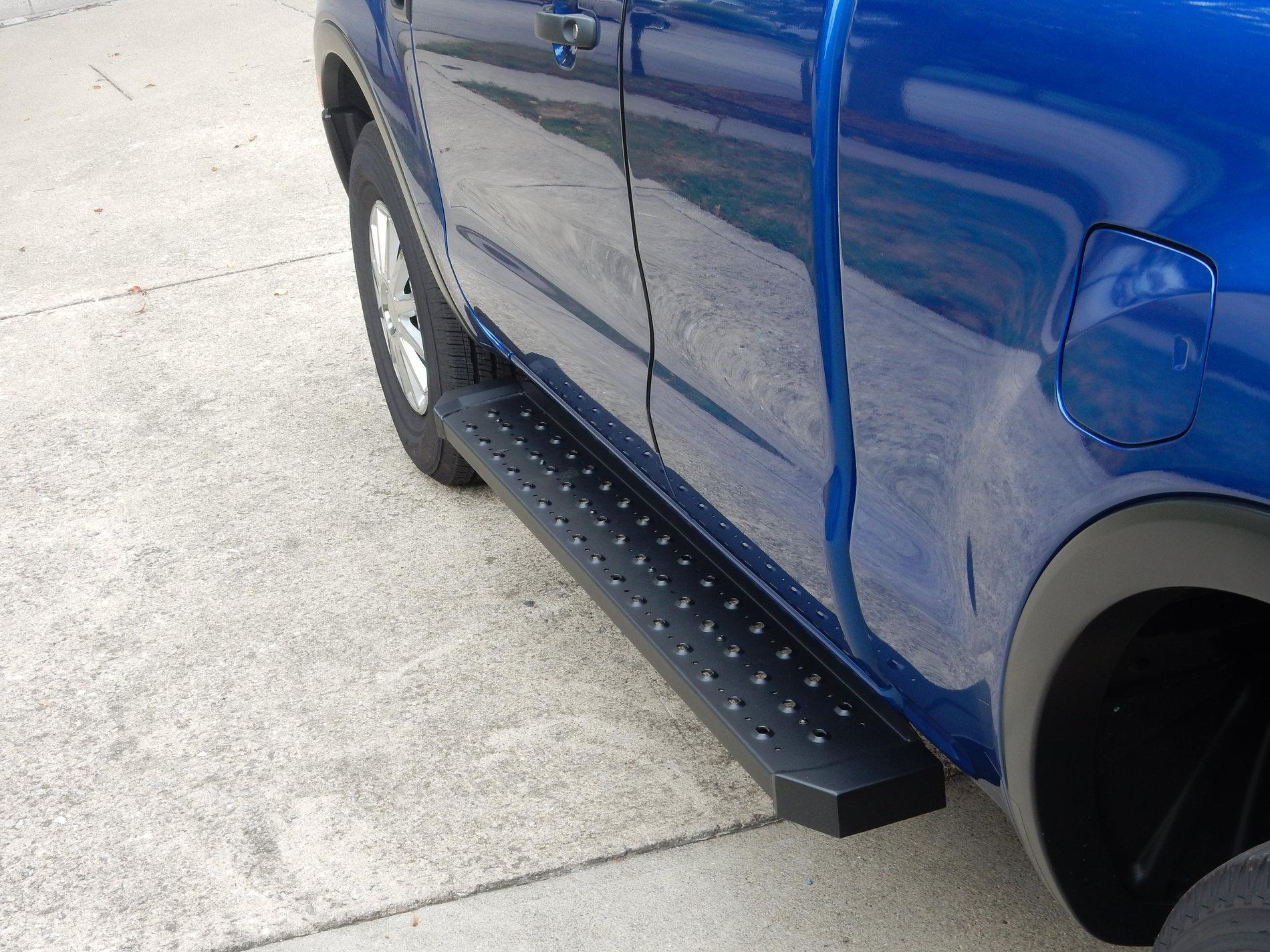

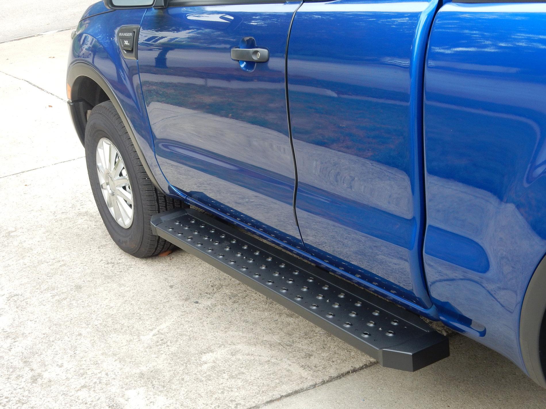

My SteelCraft Automotive STX600 Running Board additional installation notes, tips and suggestions:
#1. The installation instructions are the same for Ranger Super Crew and Ranger Super Cab.
The 6 pairs of bracket holes (3 pairs per side) are just in different "length" locations
on the under carriage for each vehicle trim. The instructions are "somewhat" well written but it takes
reviewing them many times to install the hardware properly.
#2. Take an inventory of "all" parts (counts) "before" installation. Check with your vendor for missing parts.
The Americans at SteelCraft knows how to count - there were no spares whatsoever! Don't lose any parts!
#3. Inspect the Ranger undercarriage (no vehicle/Ranger lift needed - for most people) for the 6 "pairs" rubber/plastic hole plugs and remove/pry with a screw driver. Also, check all the FMC/Ranger threaded holes pairs for proper bolt fit.Just insert and screw the bolts in the holes for proper fit (10mm-1.5 x 25mm) before attempting this full installation.
#4. There are three types of brackets for different contours of the under carriage.
Make sure you have the right ones for the right/left locations, and the front, center and back for this installation. Please note: The brackets are stamped with DF, DC (has hole in bracket) & DR also PF, PC (has hole in bracket) & PR
#5. Bolts "should" be torqued to "grade" bolt spec. The instruction manual has none? What the $%#@?
The vendor probably did this to save time and not to confuse the DIY type. Professionals always use torque wrenches. I came up with my own torque values for the 8.8 grade bolts eg 6mm x 1 and 10mm x 1.5. If you don't have a torque wrench then just follow the "normal" installation instructions but on occasion, after running your Ranger, check all bolts for tightness.
#6. I did replaced the 6 mm x 1.0 mm x 30 mm bolt "regular nuts and split lock washers" with 6mm x 1.0mm metric hex stainless lock nuts with "nylon" insert so they will never not fall off my truck! (Quantity count 12)
#7. The installation manual does NOT require/reference to any thread locking Loctite - What the $%^#@?
You have a moving vehicle that vibrates a lot but there are no vendor instructions to apply Loctite to the fasteners - truly amazing! The vendor, again, probably did this to save installation time and not to confuse the DIY type. My preference is "blue" Loctite on the bracket bolts. Blue Loctite is easy to remove.
Red Loctite is OK but is NASTY to remove. Read about the two common Loctite types (below) and you make the choice.
Loctite® Red thread locker is the highest strength. This product cures fully in 24 hours and is available in both a liquid and as a semisolid anaerobic. The red products are so powerful that they require HEAT to be disassembled.
Loctite® Blue thread locker is of medium strength. Again this product cures fully in 24 hours and can be dissembled with hand tools.
#8. All bolts should be "fairly" loose on the running boards/brackets until you "level", flush and position the brackets and rails to your liking. When OK, tighten all bolts (without applying Loctite) and make sure the running boards/brackets are all secure and tight. When satisfied with the running boards, I would go back to "each" bolt individually, remove it, and add Loctite to the bolt threads and then tighten/retorque to spec. The last thing you want is the fastener hardware hitting someone at 60-70 MPH or worst yet your new running boards falling off.
#9. I pulled the running boards out, in the slotted brackets, as far as possible away from the Ranger to "gain the most distance" for best ding protection.
#10. Metric sockets needed - 16 mm for 10mm x 1.5 bolts and 10 mm for 6mm x 1mm bolt plates.
#11. This DIY STX600 Running Board installation with 24 bolts and nuts will save you hundreds of dollars if you had it done by someone else. Take your DIY time and save money. My installation time was only ~ 2 hours in leisure time with many liquid refreshments breaks.
#12. These running boards are sharp and "pretty" on my XL SuperCab. The vendor did an excellent job of engineering them for the new 2019 Ford Ranger. (Both cabs) The installation was extremely easy to do with only one person. The cost for these running boards cannot be beat compared to the competition!
After all, these same running boards were also designed for the F series trucks.
Please note: There were no installation problems with this SteelCraft STX600 Ranger Running Board(s) ,made in the USA, whatsoever.
Disclaimer: Not responsible for any mishap(s) from installing these DIY Running Boards!
The manufacturer just design these Running Boards for the 2019 Ford Ranger so engineering/design problems still could/might exist! I have no financial interest in SteelCraft Automotive nor do they pay me for the project plug but they do have quality, inexpensive products for the 2019 Ford Ranger! If you read something that is wrong then "it is no way my fault !!!!"
The installation of the extra wide STX600 Running Boards on the 2019 Ford Ranger is sufficient in stopping "most" door dings but having chrome ornaments - "extended ornament attachments" are even better!
Now comes the hard part in this project - the design and installation of chrome ornaments on the new SteelCraft STX600 running boards for the 2019 Ford Ranger - stay tuned for further project updates.
My installation pdf for supercab

Pictures on the way;)
Notice the Meguiar's Hybrid Ceramic Wax shine;)

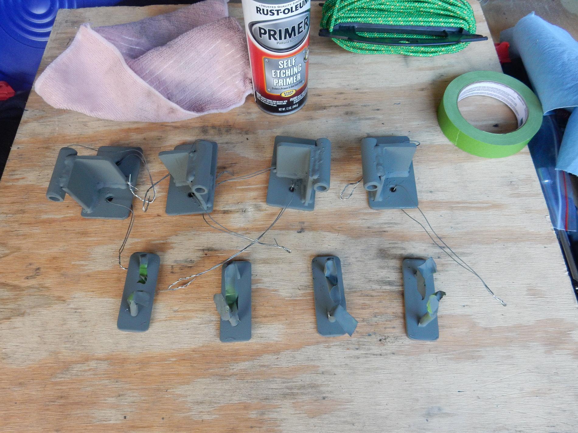

Finally, I designed the brackets for under the STX600 running boards to hold the chrome, acorn nuts, ornament, aluminum perforated tubing in place. I had to pick up raw steel from a local metals supermarket and then had the materials welded by a local welding shop. There are four bolts plates which holds the four ornament brackets under the running boards. The running boards "underneath" has universal channels to easily attach brackets. All bolt plates and brackets were made from A36 3/16" steel and welded so there is no way that these brackets will fail and fall apart from the Ranger.;)
The following picture has the four bolt plates and four ornament brackets. I am in the process of painting them (primer/base coat) for exterior use.
