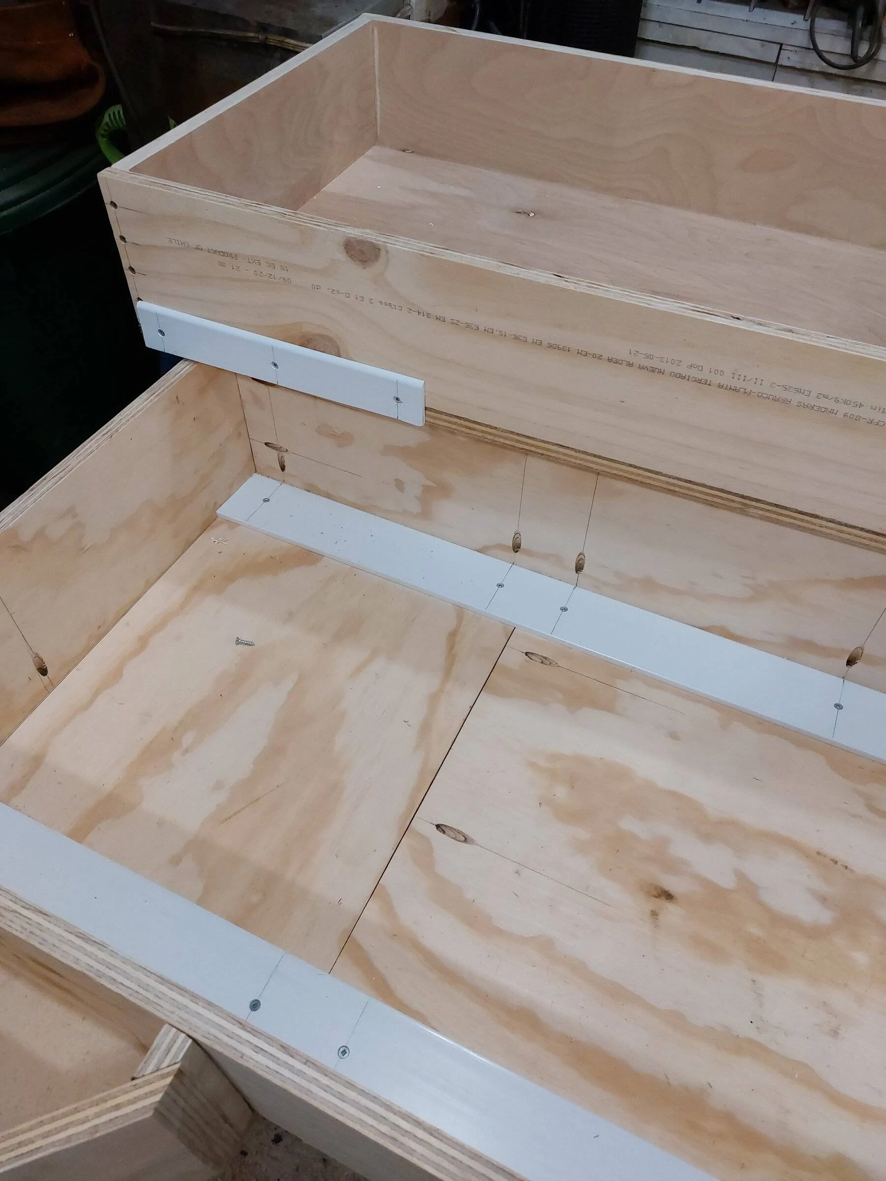

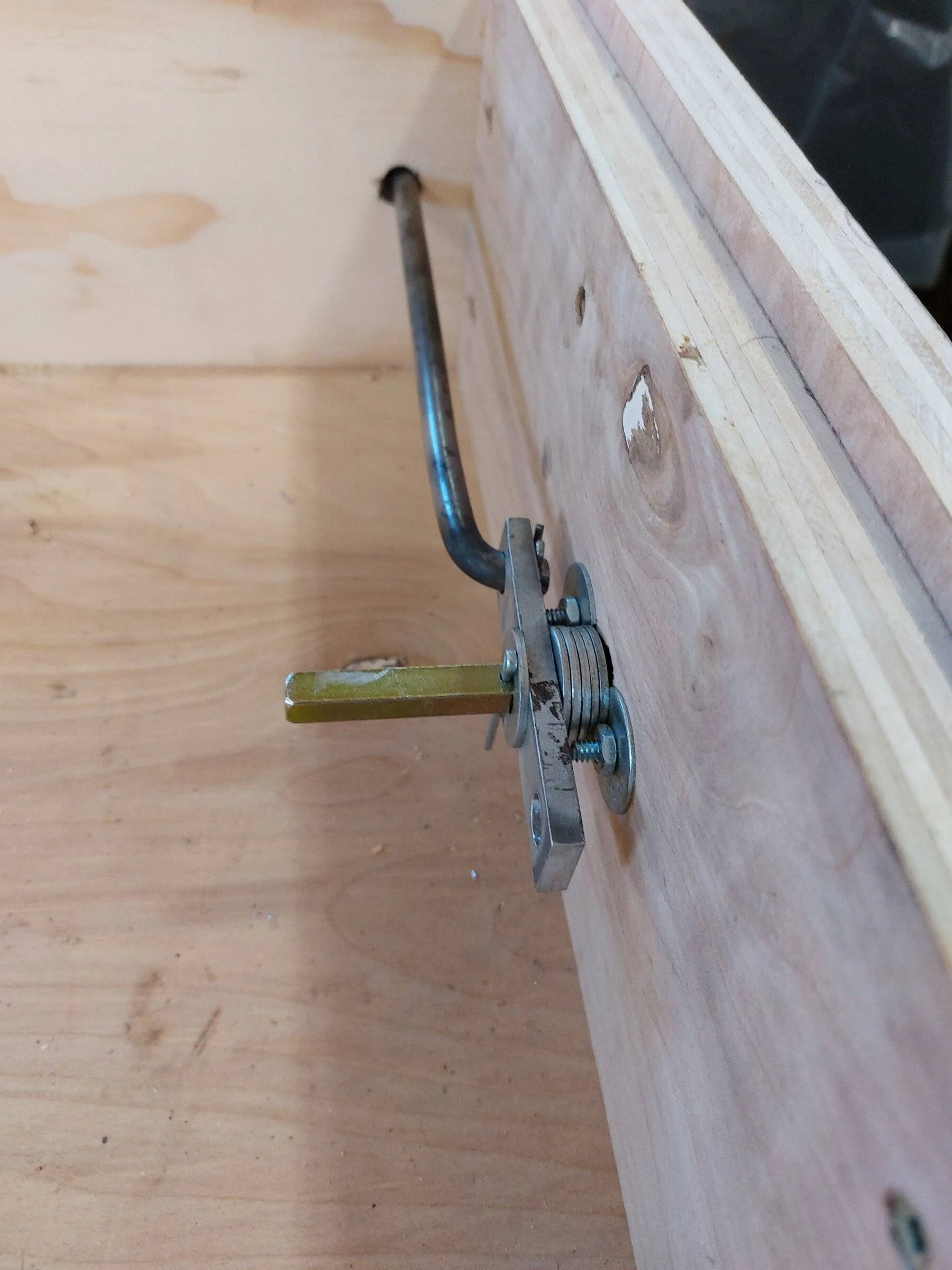

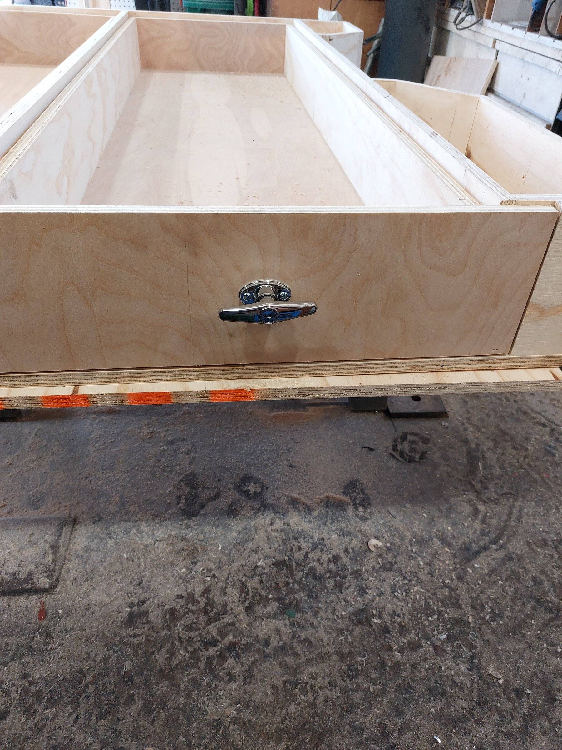

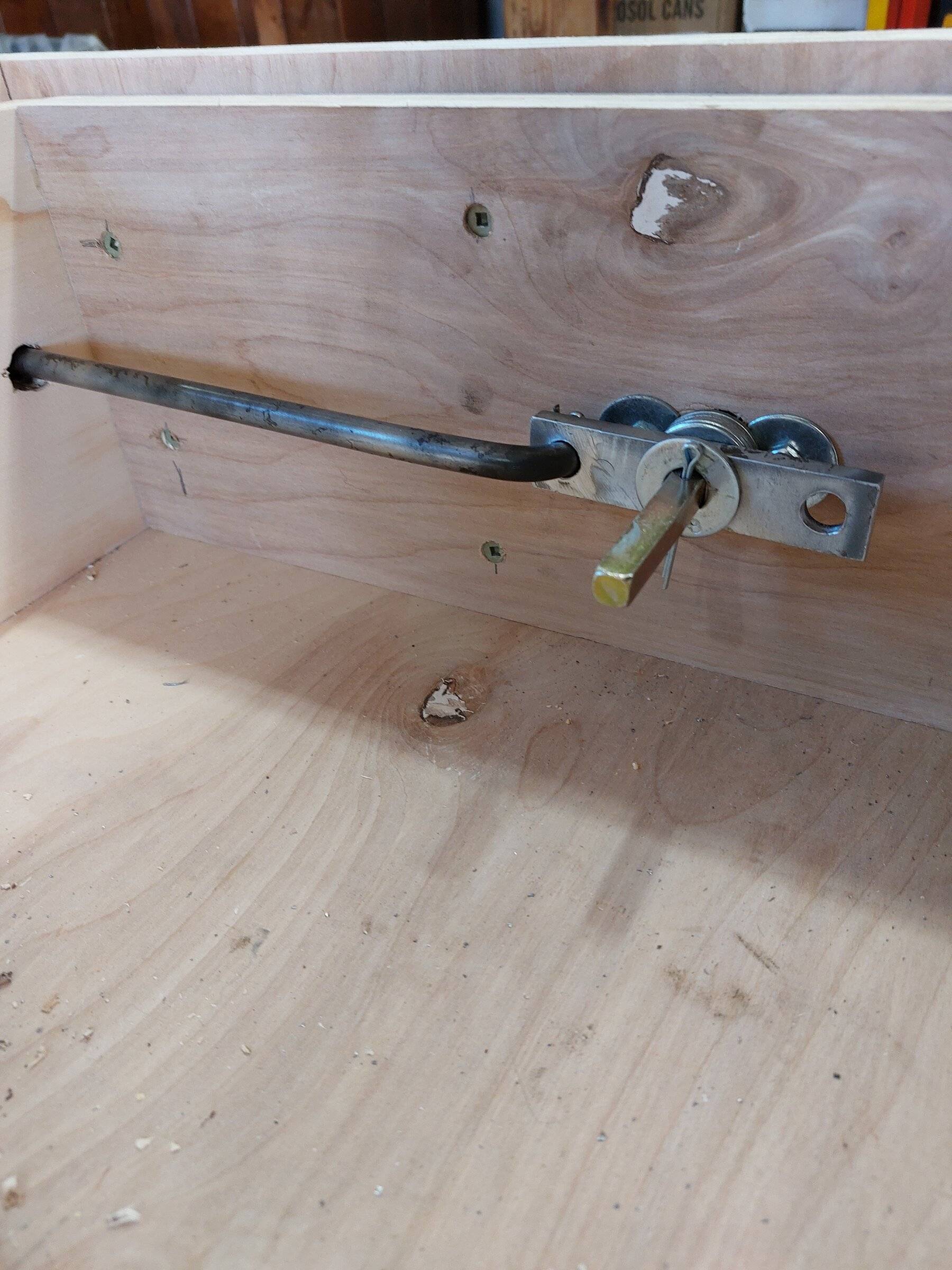

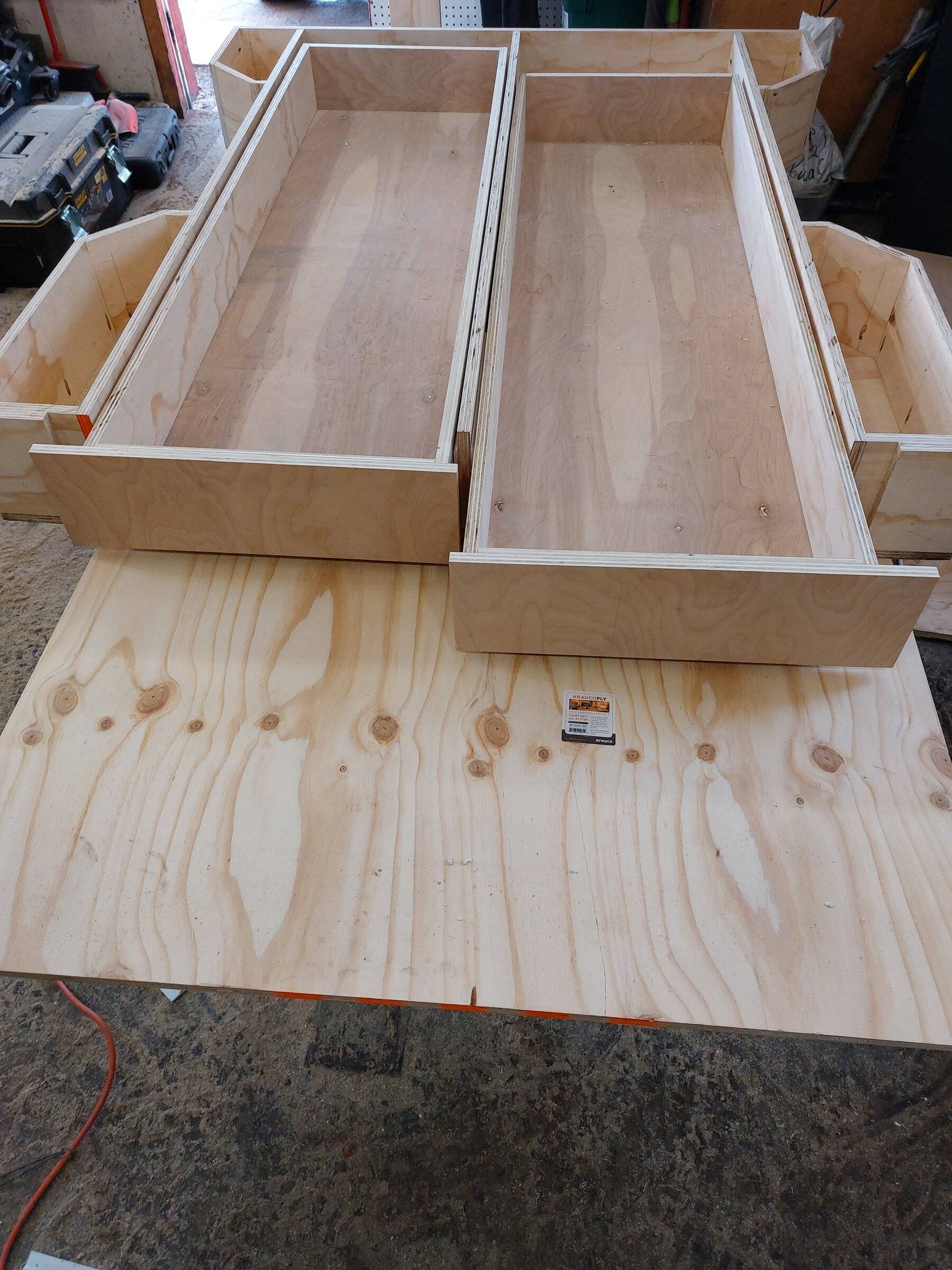

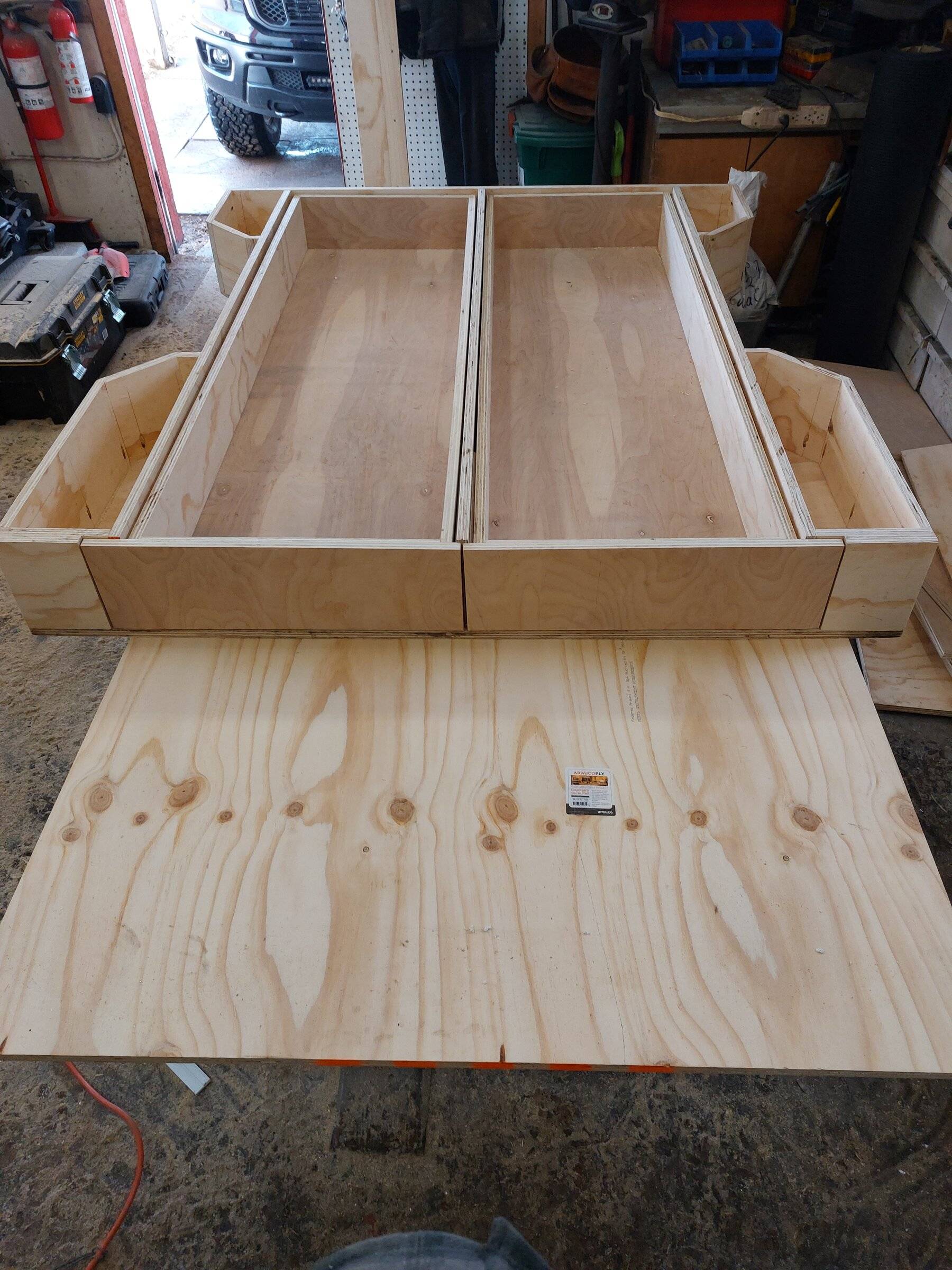

Got the little slides attached to the sides of the box and the back of the drawer. Attached the drawer faces, now onto the latch mechanism. Am copying a YouTube video with the slide setup and latch so not my design.
This is looking good. I also can't wait to see finished. Big improvement over my in bed storage boxes, but I have no need for draws. :like:

That would work great as well and likely be stronger, the pocket holes are fast and cheap though and if you go overkill on the quantity plenty strong.
If you have to take it apart before you reinstall it put toothpicks in the hole's with a little wood glue & break them off & when you reassemble you have a new hole. :like:

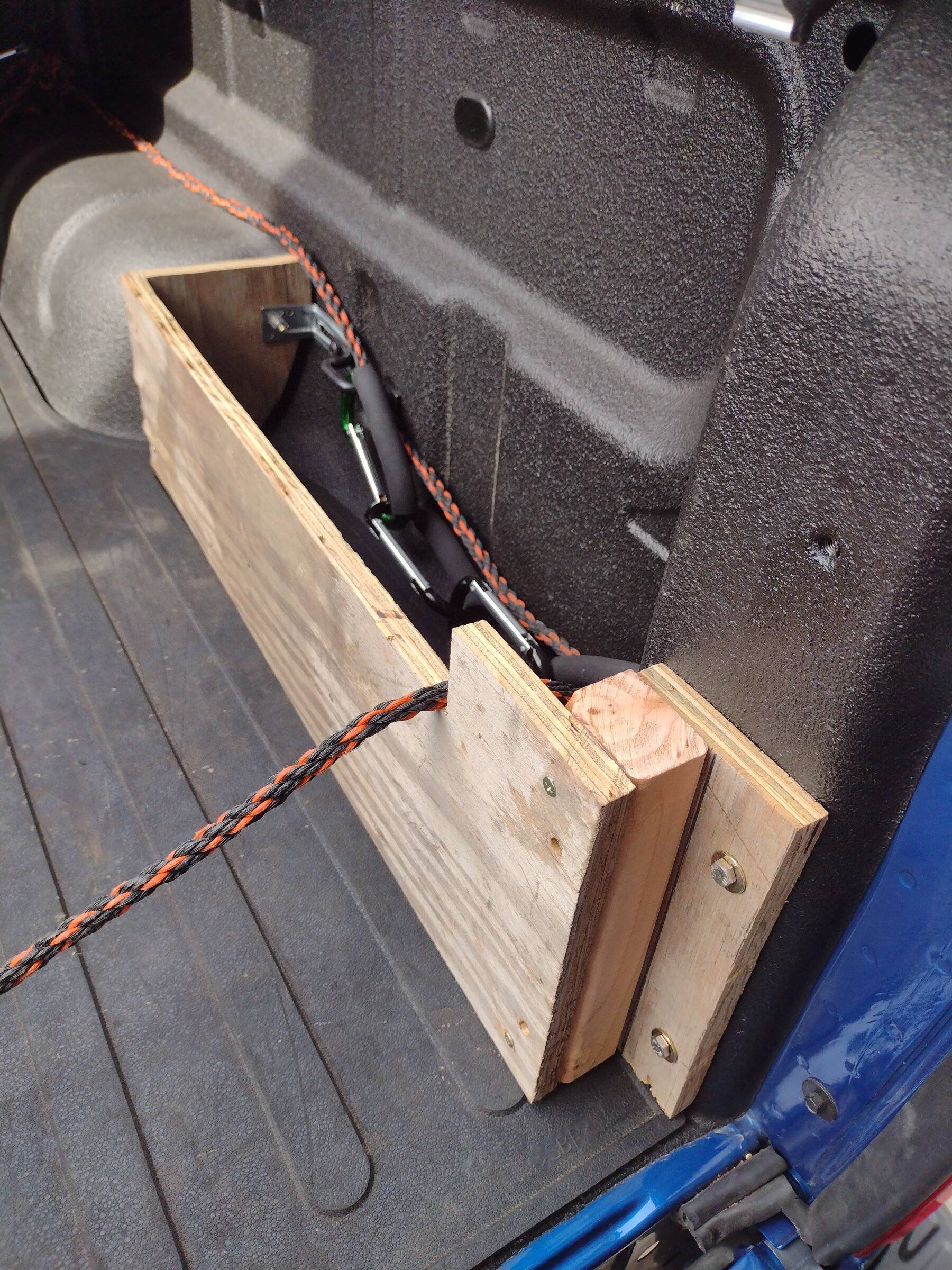

I was thinking of doing this on the driver's side but the whole length of the bed and with cubby holes. you have easy boxes that could made with scraps and a couple bolts... genius

Don't steal that's not nice. You can borrow but make sure you post pic. so if you improve the idea I might have to borrow from you. :LOL:

I like the angle cut plus the open back ,and bottom , I may want a lid on mine , in case I need to haul dirt/sand/gravel. .. Haven't really checked it out back there much , we went back to winter here in WV , snow at the moment...
