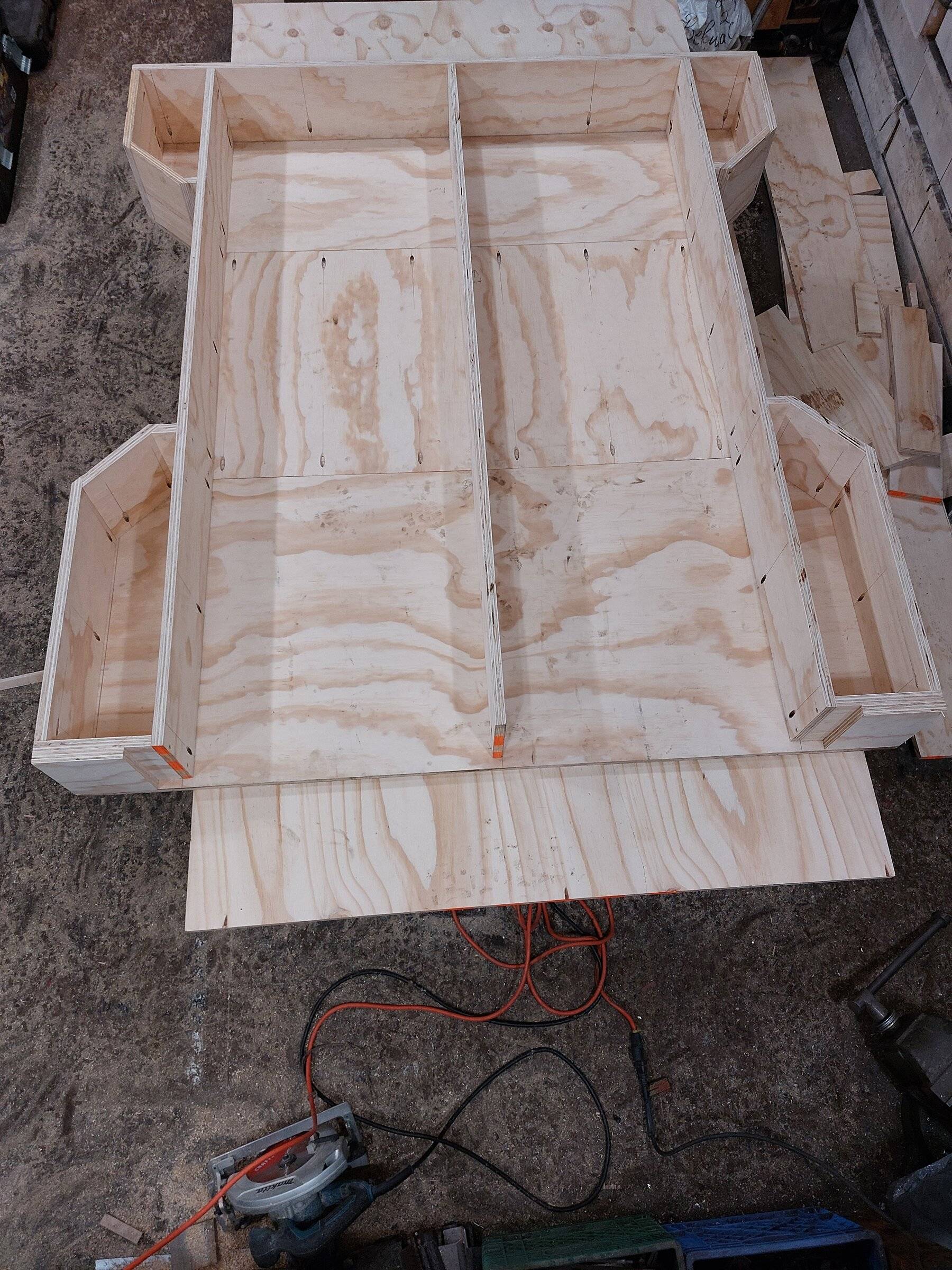

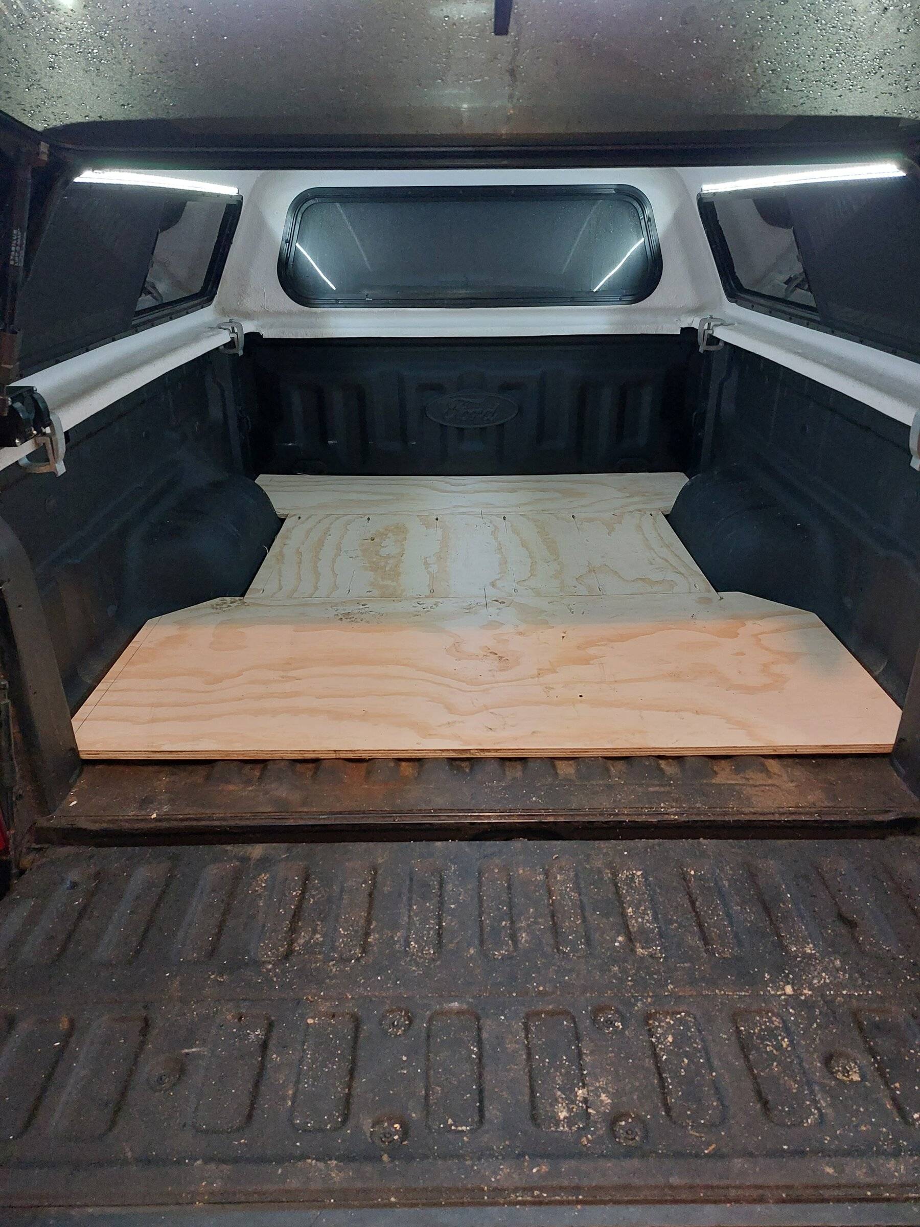

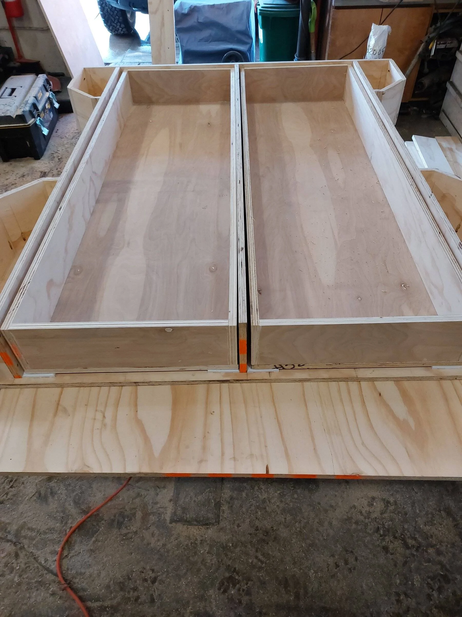

I've been picking away at building a rather redneck set of drawers for my truck. Didn't like how tall the Decked system is nor that it wastes all the space in front of the wheel wells on the 6 foot box. This is what I've come up with so far. All held together with pocket screws as it needs to be taken apart and reassembled in the bed since it doesn't fit in any other way. Just going to use thin plastic for sliders to save some money after buying the rather expensive plywood. Will update as I get more done.
Instead of pocket screws how about T nuts? Machine threads and easier to get to.
That would work great as well and likely be stronger, the pocket holes are fast and cheap though and if you go overkill on the quantity plenty strong.
True, I was just thinking about the ease of dissassembly.

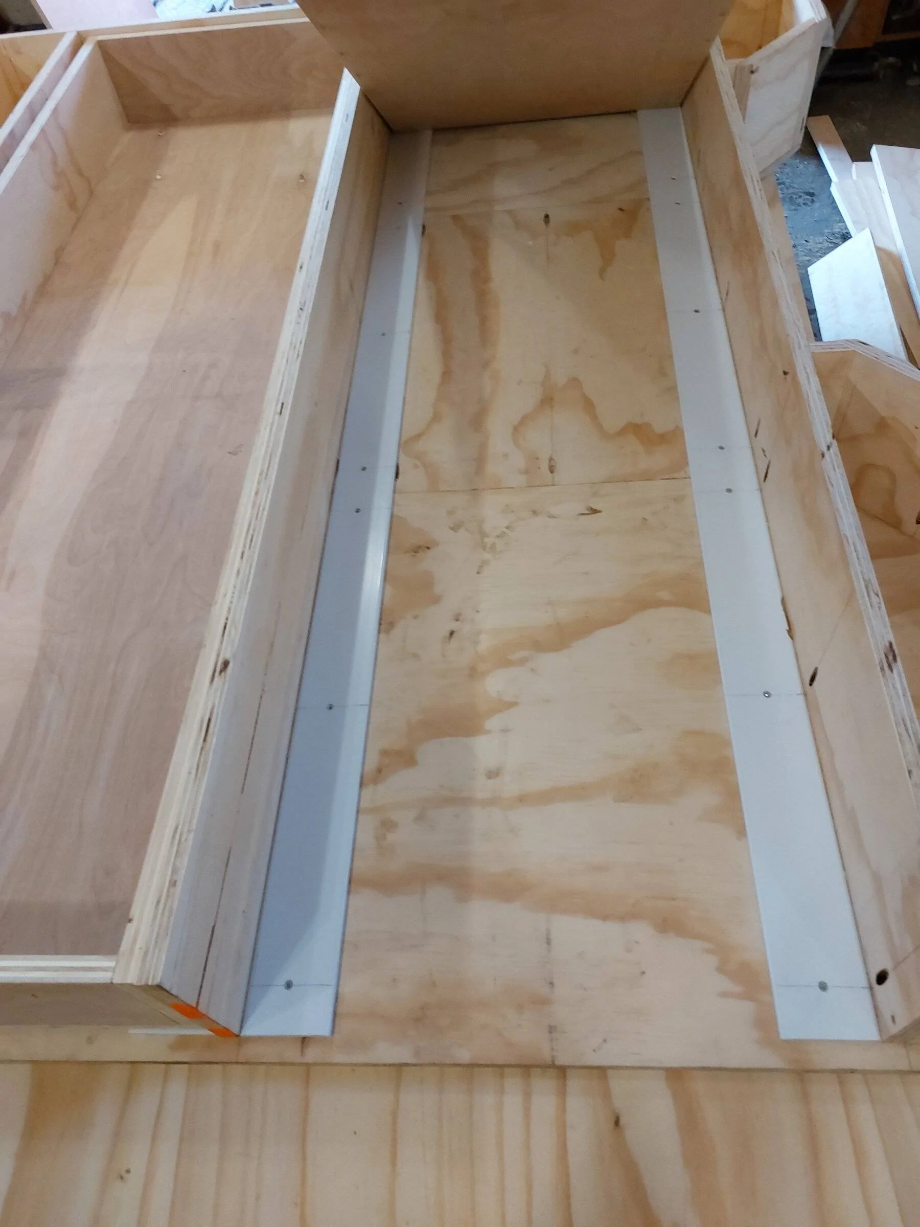

I like how this is coming together and that you’re using sliders. I’m trying to figure out if that plastic is a simple baseboard moulding, sash trim, or something else. Those reliefs that are cut into the back side are sure making me think. Can’t wait to see more of this project. ?
It's plain vinyl baseboard, 1/4" thick at the thickest point but it's not flat so makes for a tiny contact patch. Not as slippery as I had hoped but once I sand and wax the bottoms of the drawers should be alright. I wanted to use Teflon or HDPE around 3/16" thick but didn't wanna have to wait for it come in and it's special order everywhere.

It would be great for that and also longevity, by the time I take this all apart and reassemble it again in the truck the screws won't have near the bite as the first time. So unless you went to a heavier screw next time it likely can't be taken out of the truck again and put back in. I may take the cap off and enlist some help to see if it can be wiggled into the bed that way. Would be great if it could
These guys have UHMW HDPE available. It's a LOT cheaper than PTFE, and usually better for bearing slides. It's almost as slippery, and doesn't cold flow like Teflon.
https://www.onlinemetals.com/en/buy/plastic-sheet-plate-uhmw-natural-virgin
