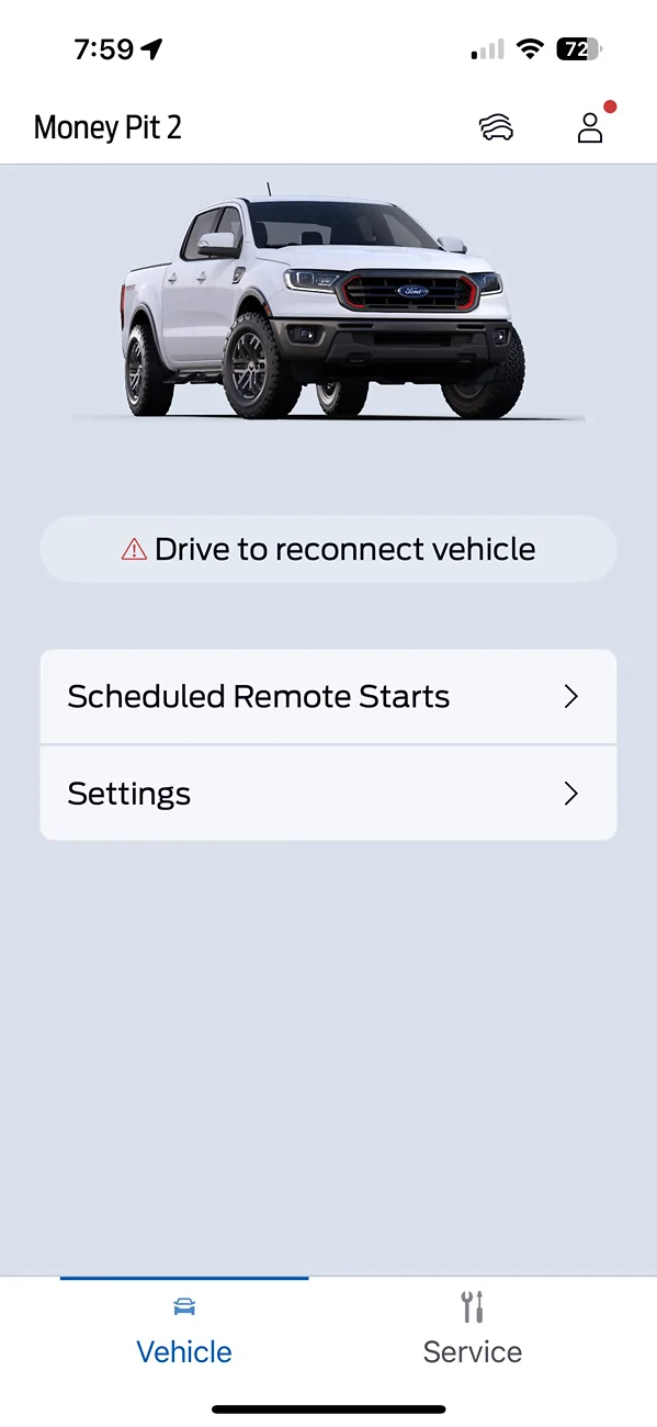

Welcome Colin! I can relate to the "Money Pit" as that's what I've called both my Rangers. I'm on Money Pit 2 right now. 😁
