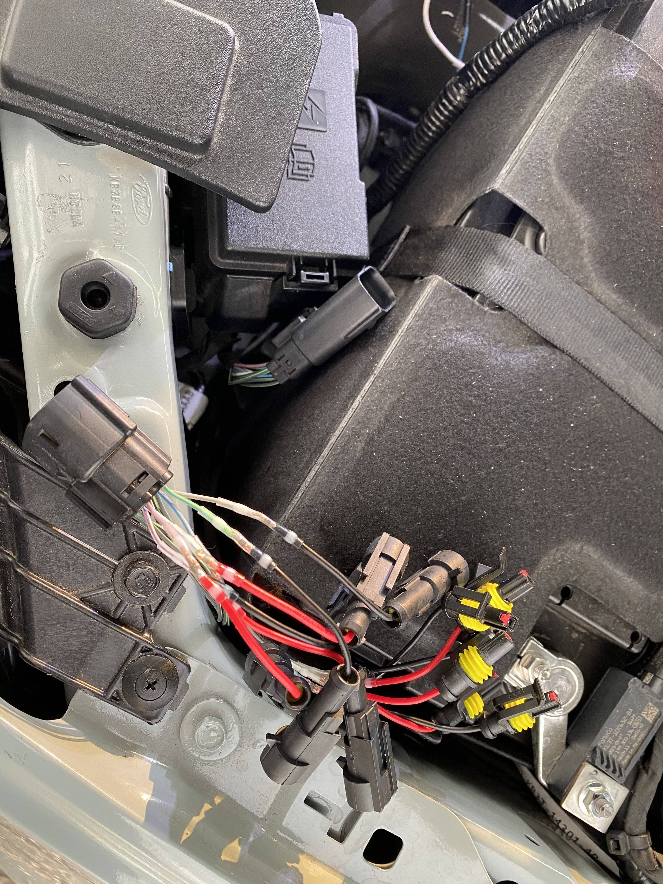

You can add connectors in-line to change which output each switch controls. Then you choose the order.
Bad idea. Look at the wires coming from the upfitter box. The are different gauges. The thinner wires are not intented or able to support the heavier load. Good way to have a vehicle fire or at the very least a blown fuse.

Lots of options for the switches. Just make sure to not excede the amps per switch. It's 25, 15, 10, 5, 5, 5 amps in the switches from left to right.
Actually, mine is a good idea. I am changing the input side. I interrupted the wire between the switch and the relay. The circuit and its rated output remains the same. No blown fuses, and certainly no fire.
