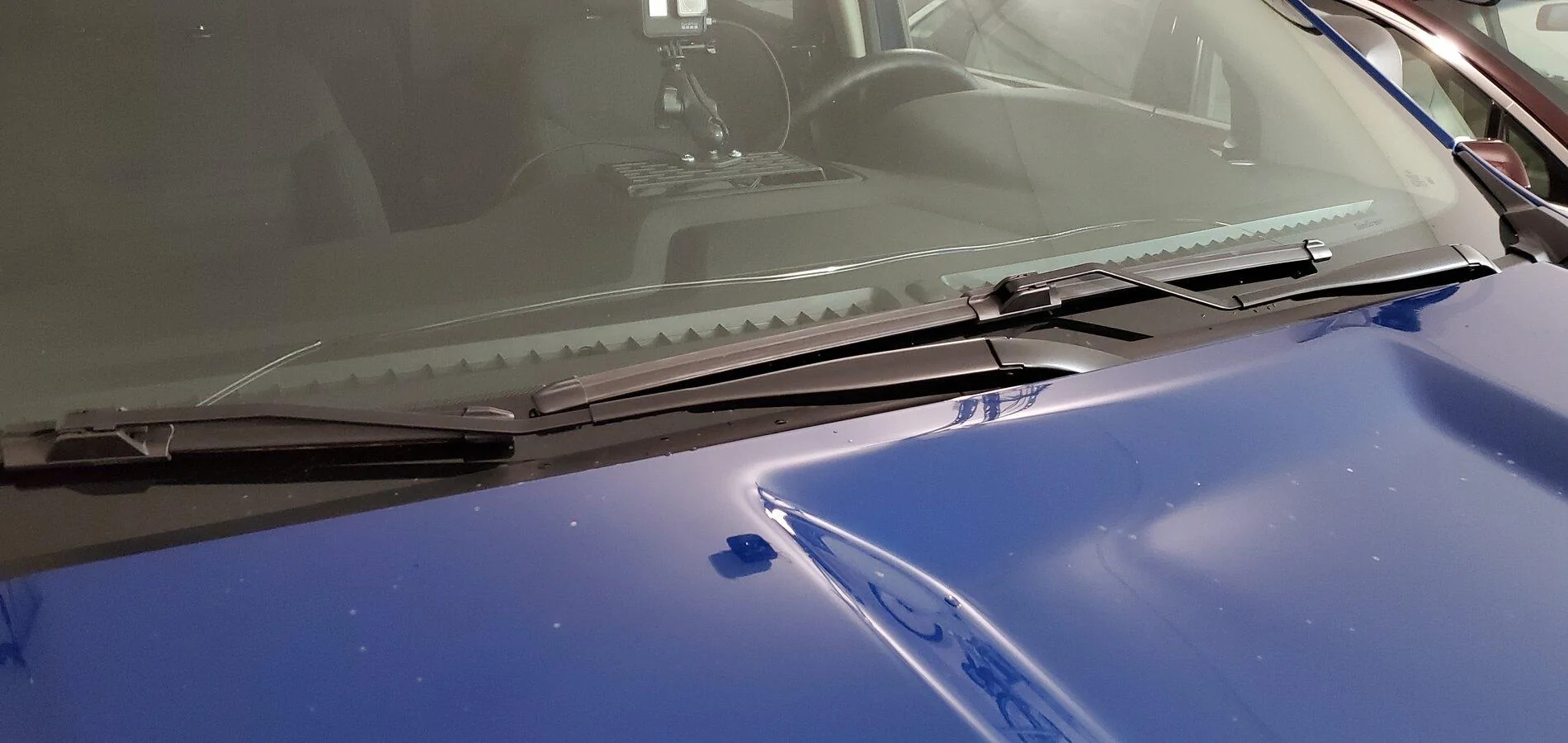

On my drive home this morning I had my defroster on set at 67 degrees and low fan speed due to rain and the windows kept fogging up. Half way home I noticed a crack in the lower left side of my windshield that went from the driver's side all the way to the passenger side. Stopped at my local Ford dealer to submit a warranty claim. Waiting to hear back from the dealer. Has this happened to anyone else? My truck is just over 6 months old and has 14,280 miles on it.
Mine started cracking almost exactly like that this week. I had the defroster on to clear ice off the windshield. I didn't scrape but just let the truck warm up. I have less than 7,000 miles on my 2021 Ranger.
When I first noticed it, I didn't see any dings or stars. However, I have found one below the level of the hood and below the wipers. It was not there when I first found the cracking but only showed up a day or so later.
There is no ding or paint scratch where a rock might have hit the hood of the truck first.
Thank you for posting this as I came here to see if I was the only one which I guess I'm not.

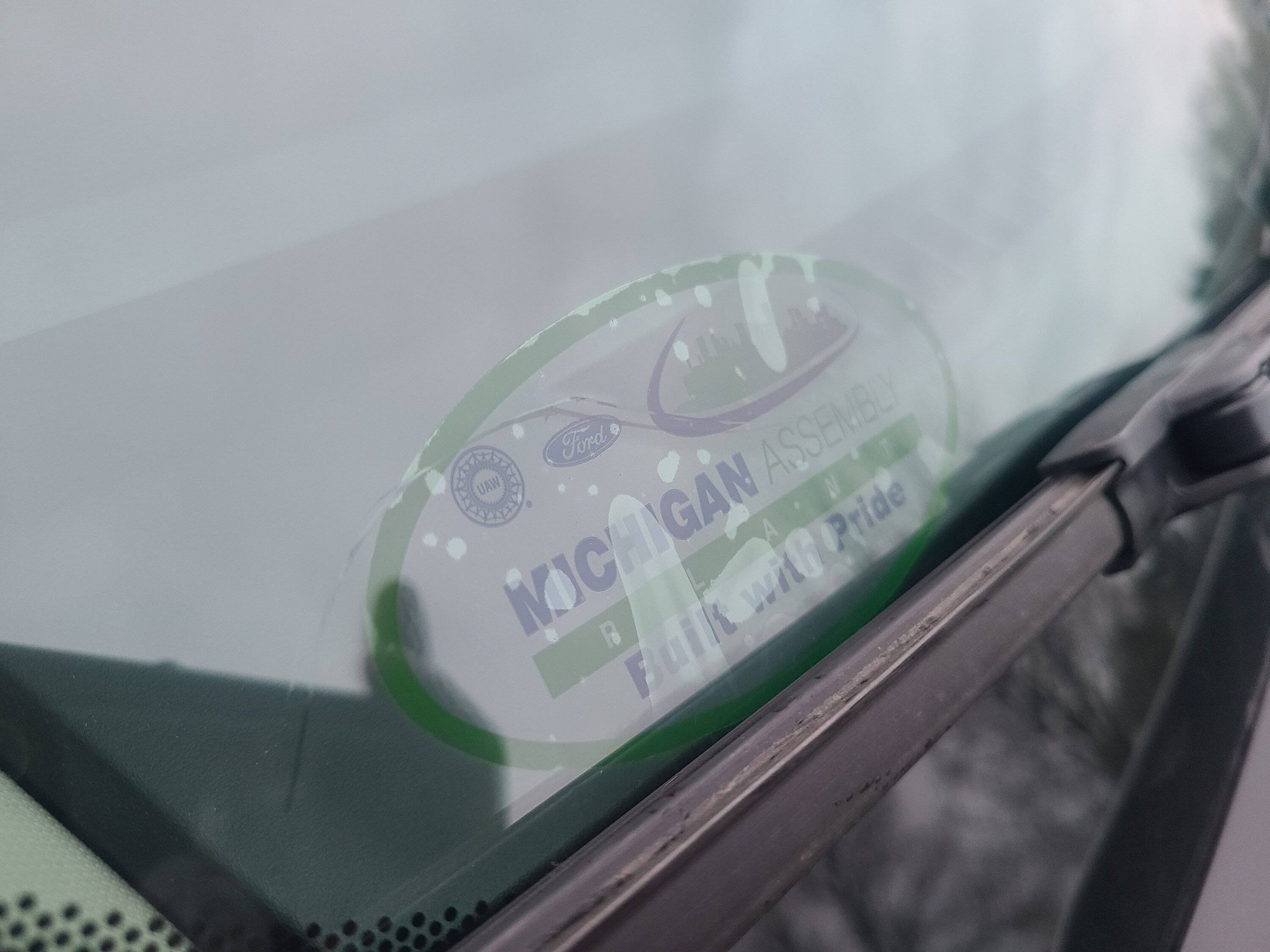

I just noticed the same crack on my windsheld today. Starts at the left edge & runs almost all the way to the right edge, just past the green decal.
It's under 10,000 miles, there is one spot that looks like it may be rock chip, but I'm very skeptical. Chip is tiny & just barely a surface damage(like 1mm deep?). I don't know anything about glass, but I can't imagine something that looks like a scrape cause the windshield to crack like that. Honestly I think the chip came from the crack, not the other way around.
Either way, what I think doesn't matter. I'll see what my Ford service advisor says & worst case scenario, it's auto insurance deductible for me. Weakest windshield I've ever seen. Disappointing.
