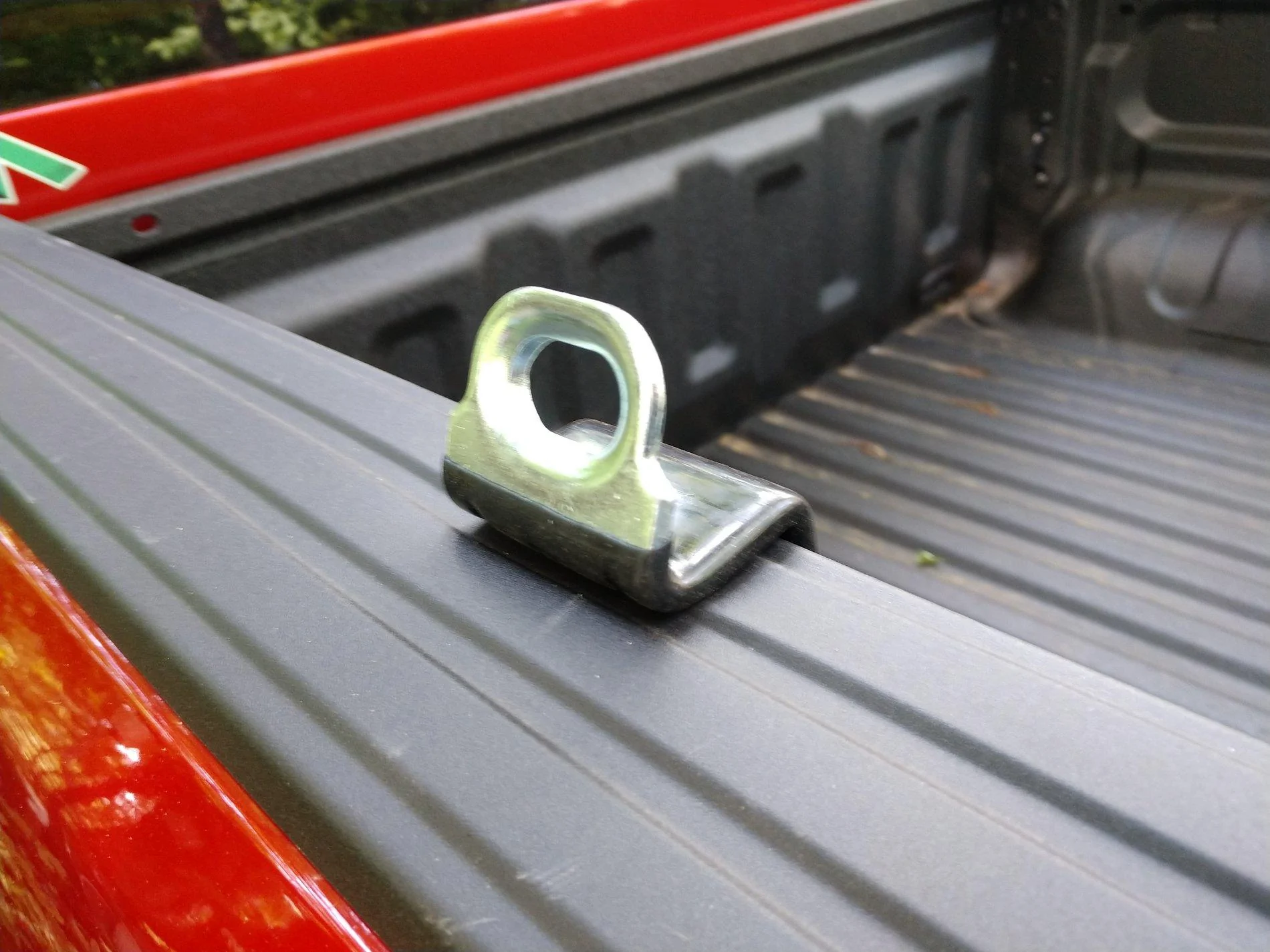

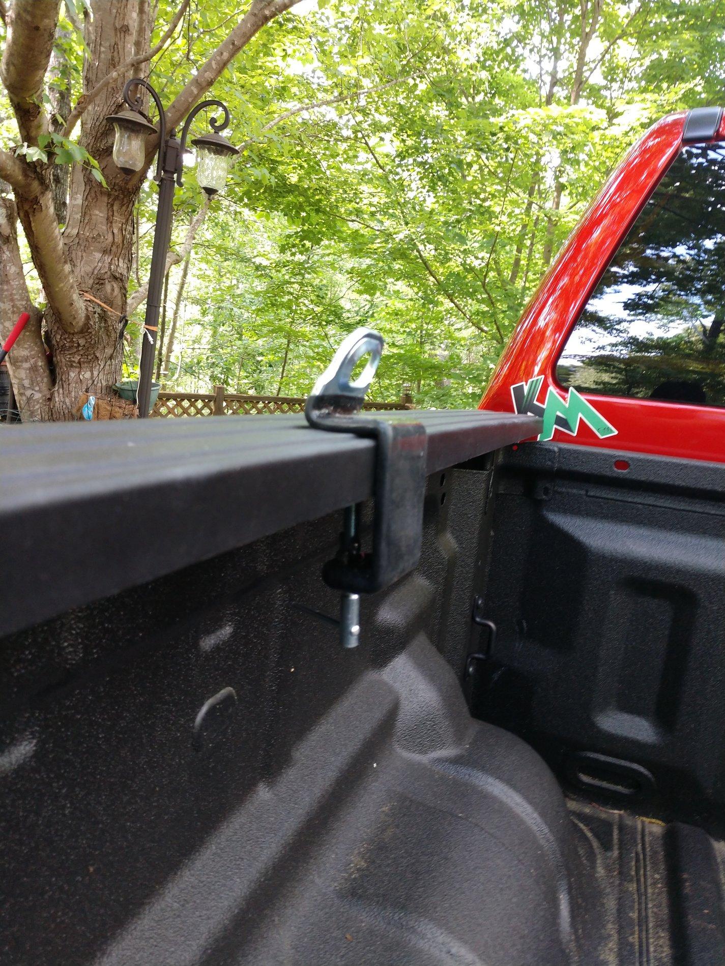

Got these in anticipation for Decked (Which I just ordered today). Got two to test. We usually don't have heavy loads, so should be sufficient for our needs. The whole thing is pretty substantial, and the weakest part is the actual bed rail of the truck.

Oh cool so is that drilled into the rail???

No just a clamp
And my wife made me put a felt tab on the metal clamp part underneath to prevent cutting into the rail with metal to metal. It actually is holding. I will post pics when I install decked. Hopefully we just keep them off until needed (guess we can store in the side cans), but not too awkward looking on.

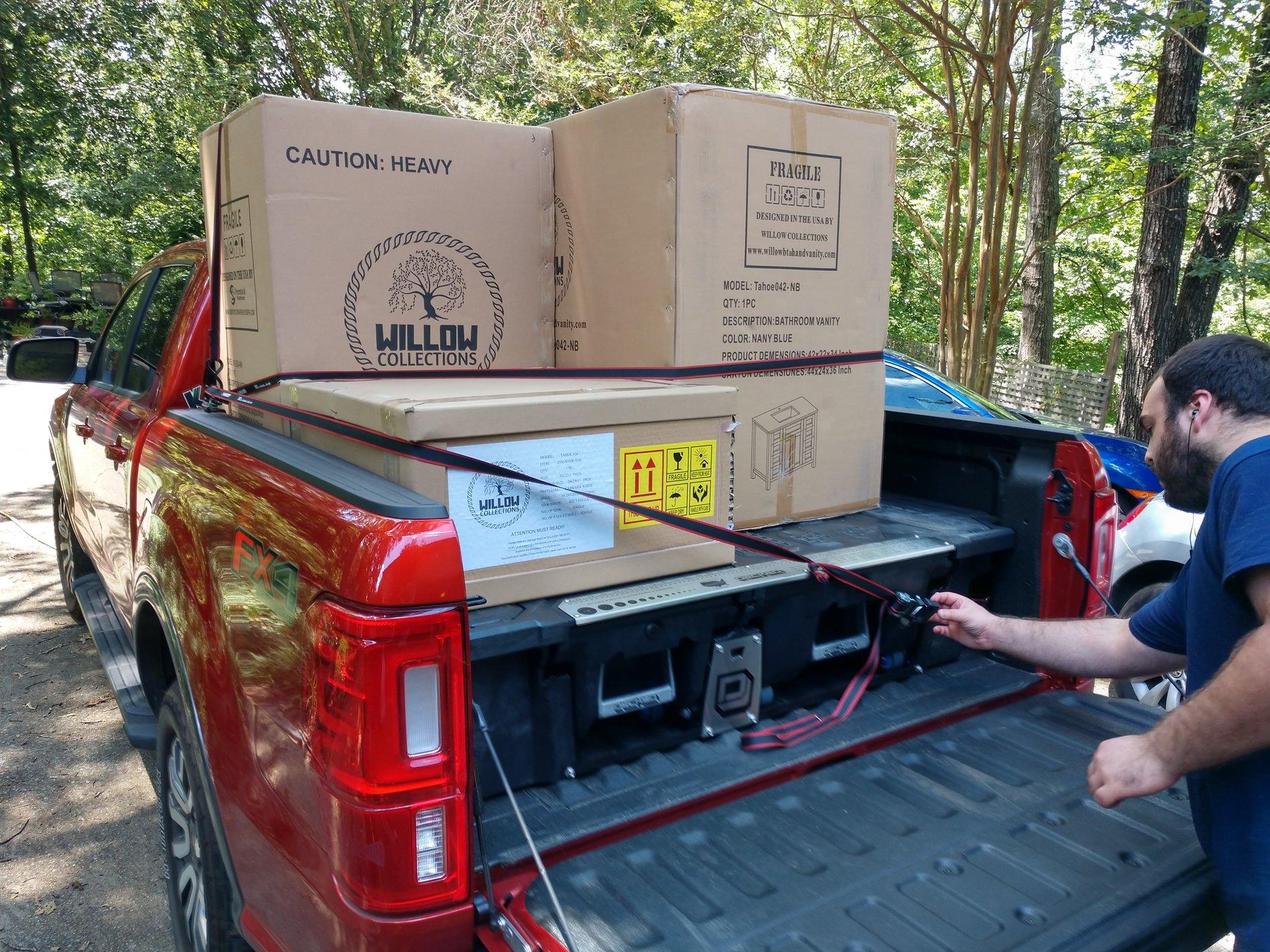

Our First bed load after installing Decked. The tie hooks we bought (above) worked perfectly (though we only had 2 cause we forgot to pack the other 4 we bought). You can reach the oem hooks at the tailgate end fine too, which is what we did. The load did not move an inch for a 40 mile trip.
Though I was concerned about hauling the cabinets since the Bed surface is higher, the decked system actually let us fit the boxes better since the entire bed area is flat over the tire wells. The bed is deep enough that there is still decent sidewall to secure loads against. Without the decked we may not have been able to get the whole load in one trip with the ease and less risk of damage that we did. It all stayed flat and secure.
I bought D rings I want to install in the existing holes in the bed at the cab end and the tailgate end (used for the swing boxes) for additional tie options.
So we are more than happy with the versatility Decked gives us.

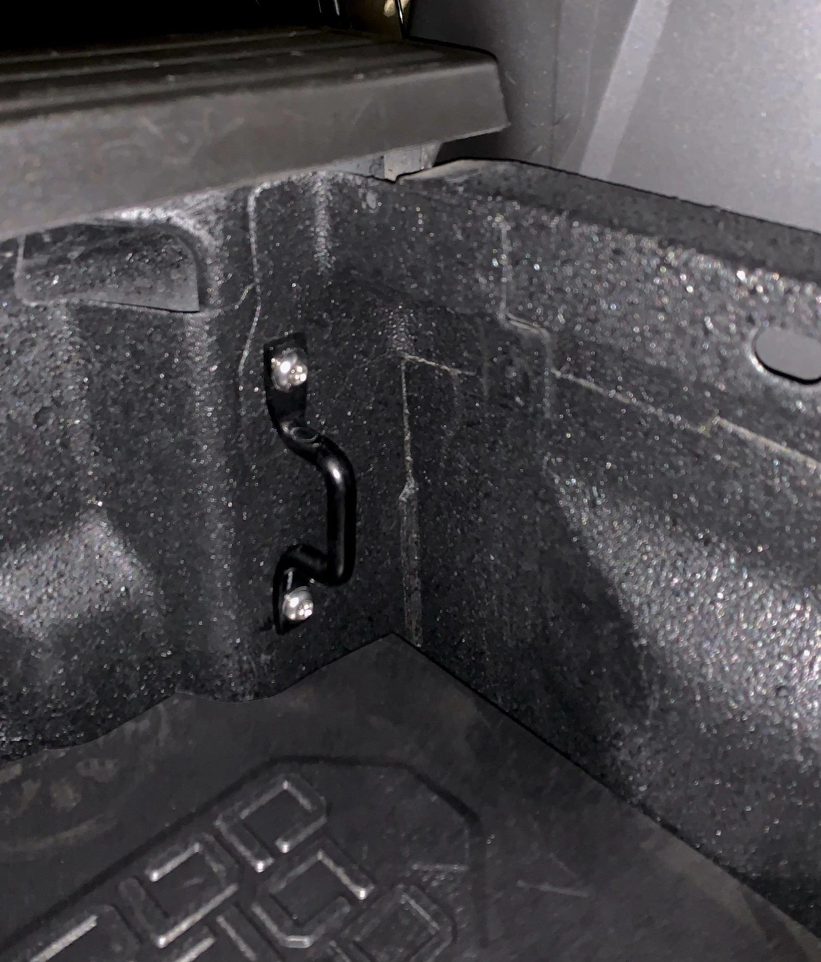

We put in the D rings. Had issues identifying bolt size, mainly due to bed liner over spray. Turned out better than expected. Top holes by cab used M8x20. Top holes on tailgate end, used M6x20. Painted with spray can bedliner. No rattles heard when driving.

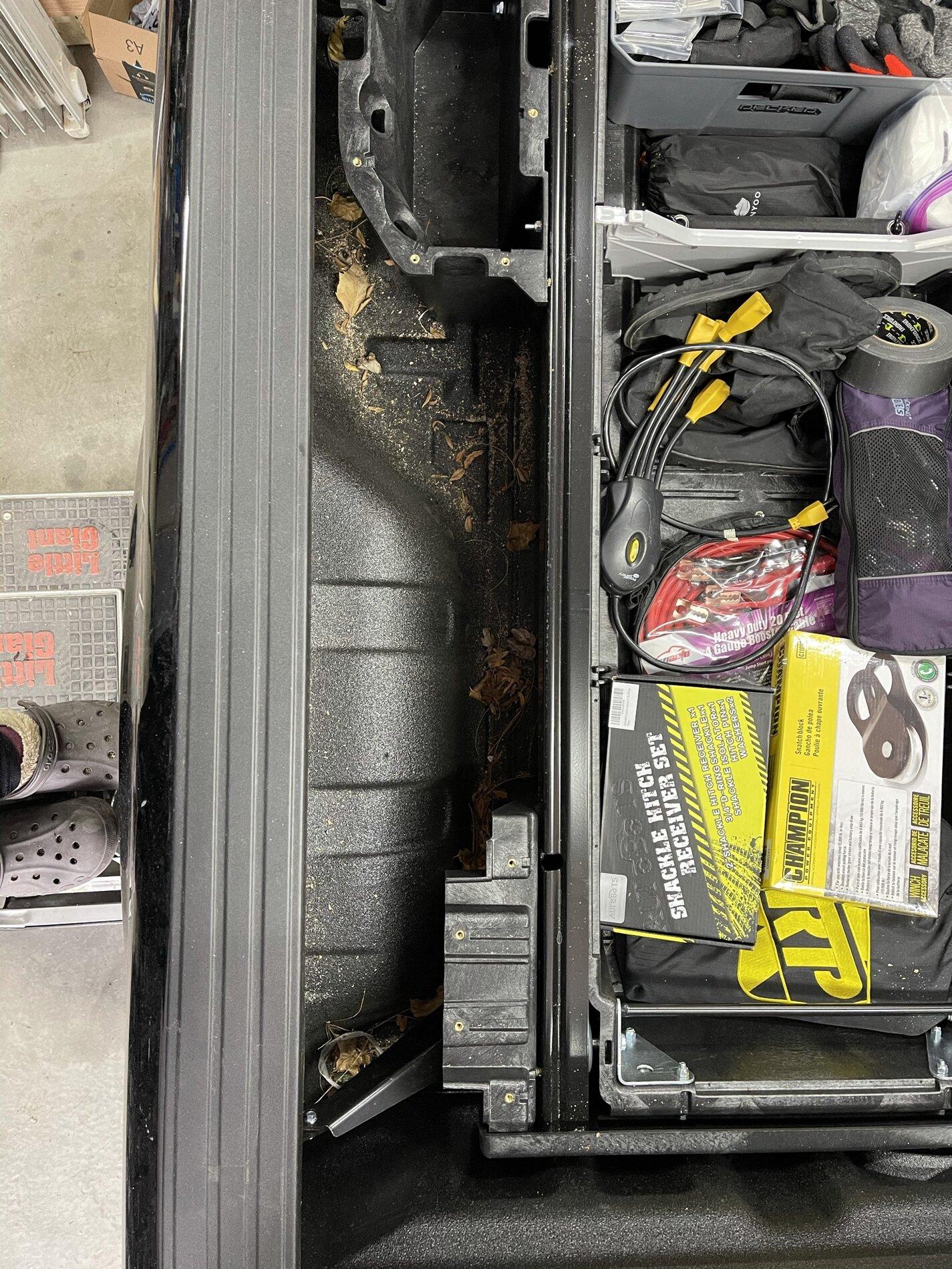

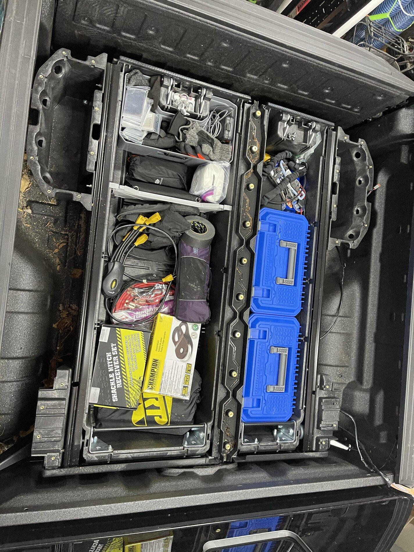

I removed my decked system today, to get ready for RSI smartcap install. Here's a pic of how much space you lose and how much garbage gets in bed in 3 months (garaged every night)
I still like it, but thought it my be informative for some to see usable/lost space

Those photo's are great at showing the unusable space.
Did you have a tonneau cover or something similar, or was the bed just open?
