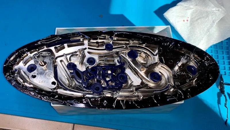

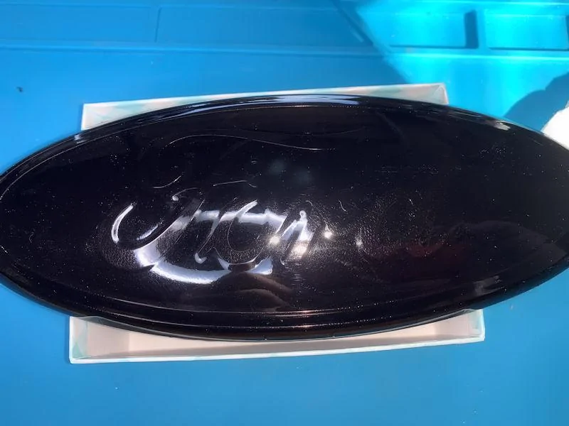

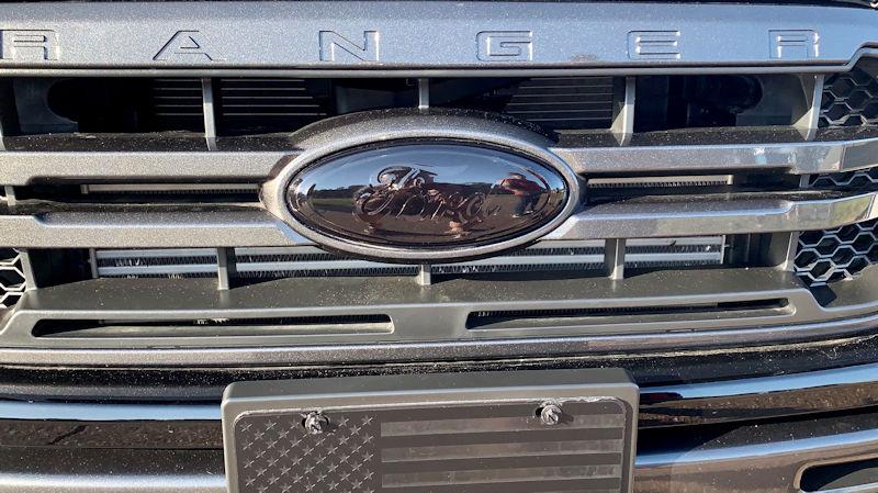

(Figured I'd move this here, had in wrong section sort of)....)...Decided to de-badge some stuff so tried a cheap experiment. I removed the front emblem and wrapped it in self healing headlight wrap. Didn't want to invest in one of those on ebay because not sure I'm keeping grill.
Came out pretty good. After trying twice to do it on the truck and failed, I got fed up and removed the whole emblem and did it on my bench. Your preference if you want lighter stuff. This darkness makes the chrome and blue disappear. Hard to get a decent picture.... excuse dust and finger prints.

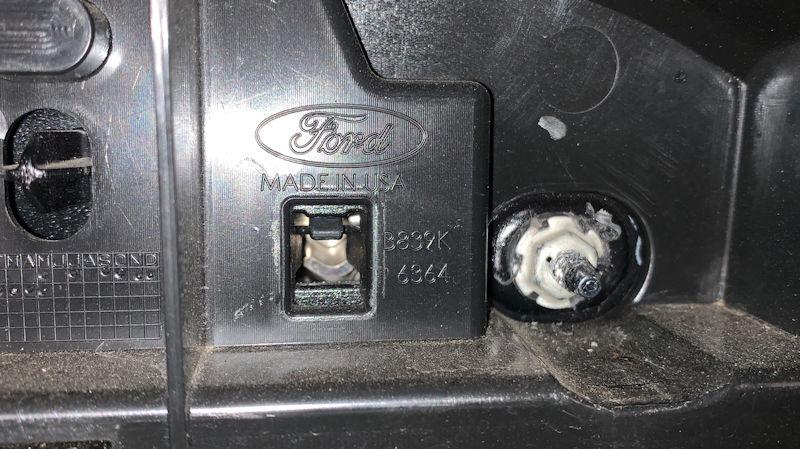

John,
Were you able to remove the emblem with out taking off the grill? If so, curious to how you did it (what tools you used, etc.)

Yes.... Just had to remove the top bolts holding the grill on so you can just pull it toward you a bit. Before that though, you have to remove both shrouds. Top and next one down. All you need to get emblem off is a small socket. The new chincy nuts hold the emblem onto a plastic stem behind grill.. So don't strip putting nuts back on. Put a dab of silicone on stem just to make sure nuts don't slip off. So, socket set, flat screwdriver, plastic removal tool and a lot of patience.Just basic tools... :whew:
I was able to take a snapshot from behind by sticking my phone in there. There are 2 of these nuts. I got a shot of the one side. Other side pretty much the same. $13 bux and scraped up hands and viola.... ;)

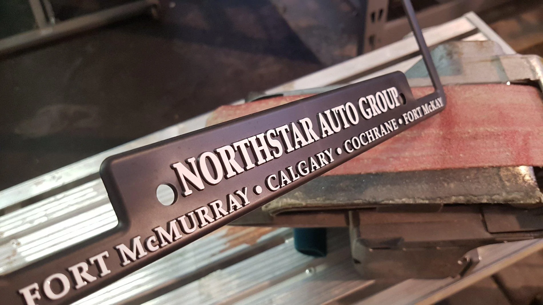

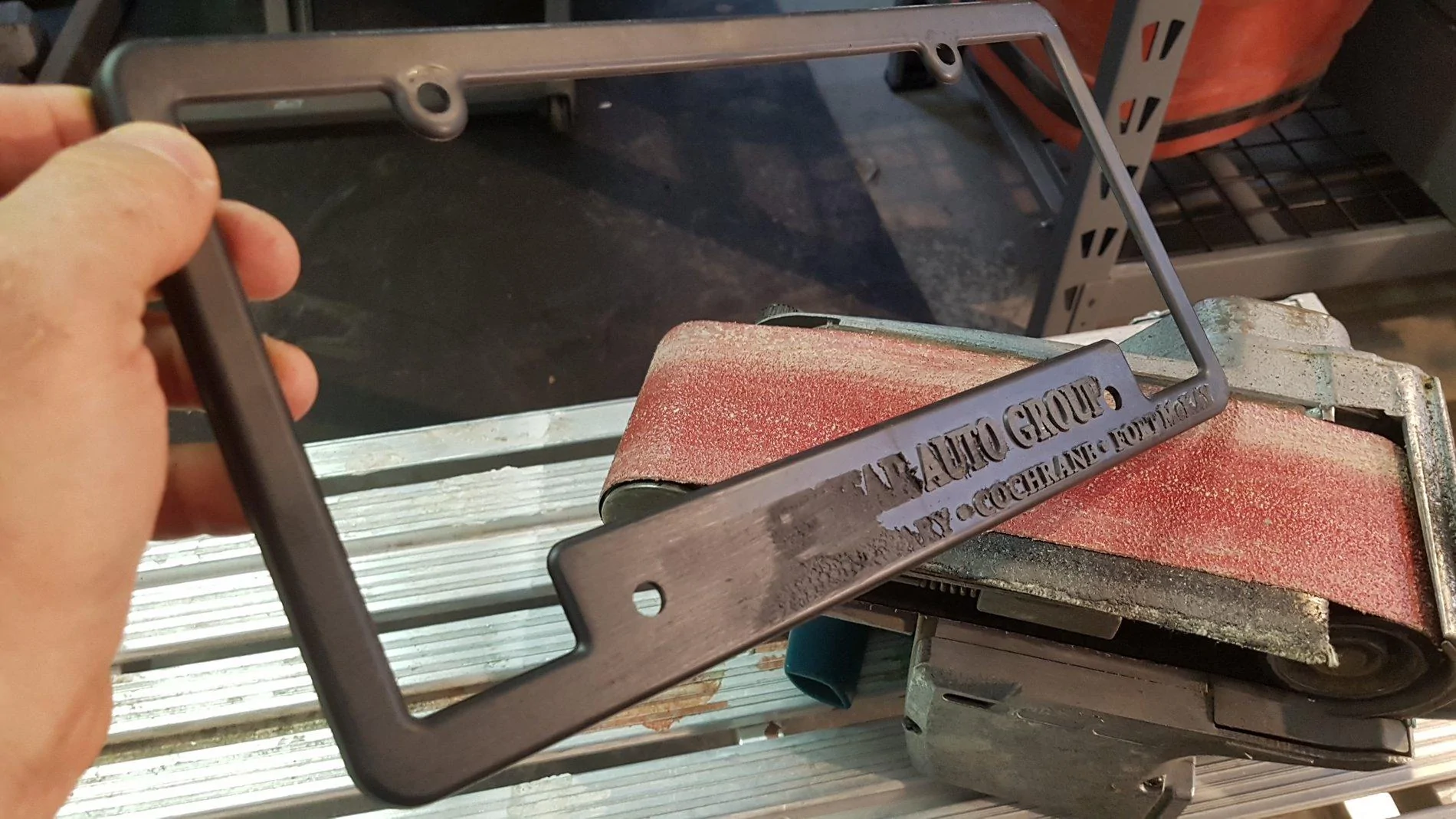

Little more de-badging today. So long dealership lettering on the license plate frame. Since I'm a cheapskate and didnt want to spend the few bucks on a new black one, here it is. I probably could have just used a black sharpie or something, but instead I took my belt sander to it.
That’s actually a pretty good idea! Who cares if it’s cheaper, it’s better than tossing it in the garbage and buying a new one!
