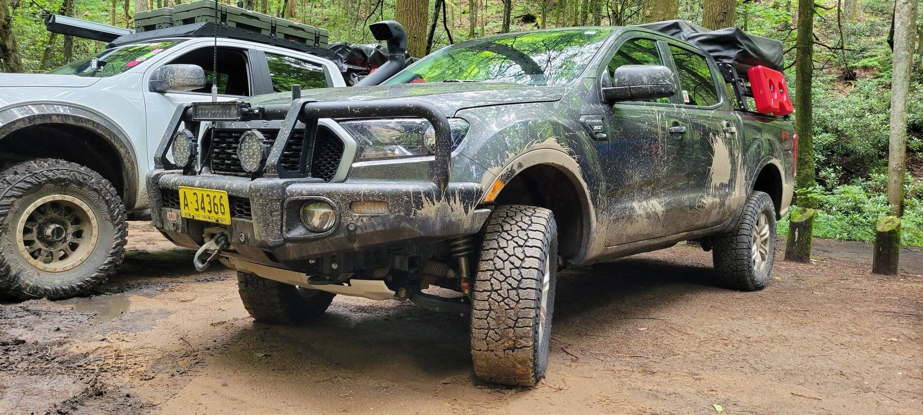

Mine cost roughly $2000 to have removed.
Well, I had to pay for the ARB bumper, and the winch. Once I installed that with the help of my friends, all I had to do was unbolt them and throw them in my garage. It took 5 minutes. ?

On the Ranger, in the front of the wheel well, there is a frame extension in front of the wheel. There is also one behind the wheel, and they trap the wheel in front end collisions. People remove them to fit bigger tires. I actually removed mine for the front approach angle benefits.
