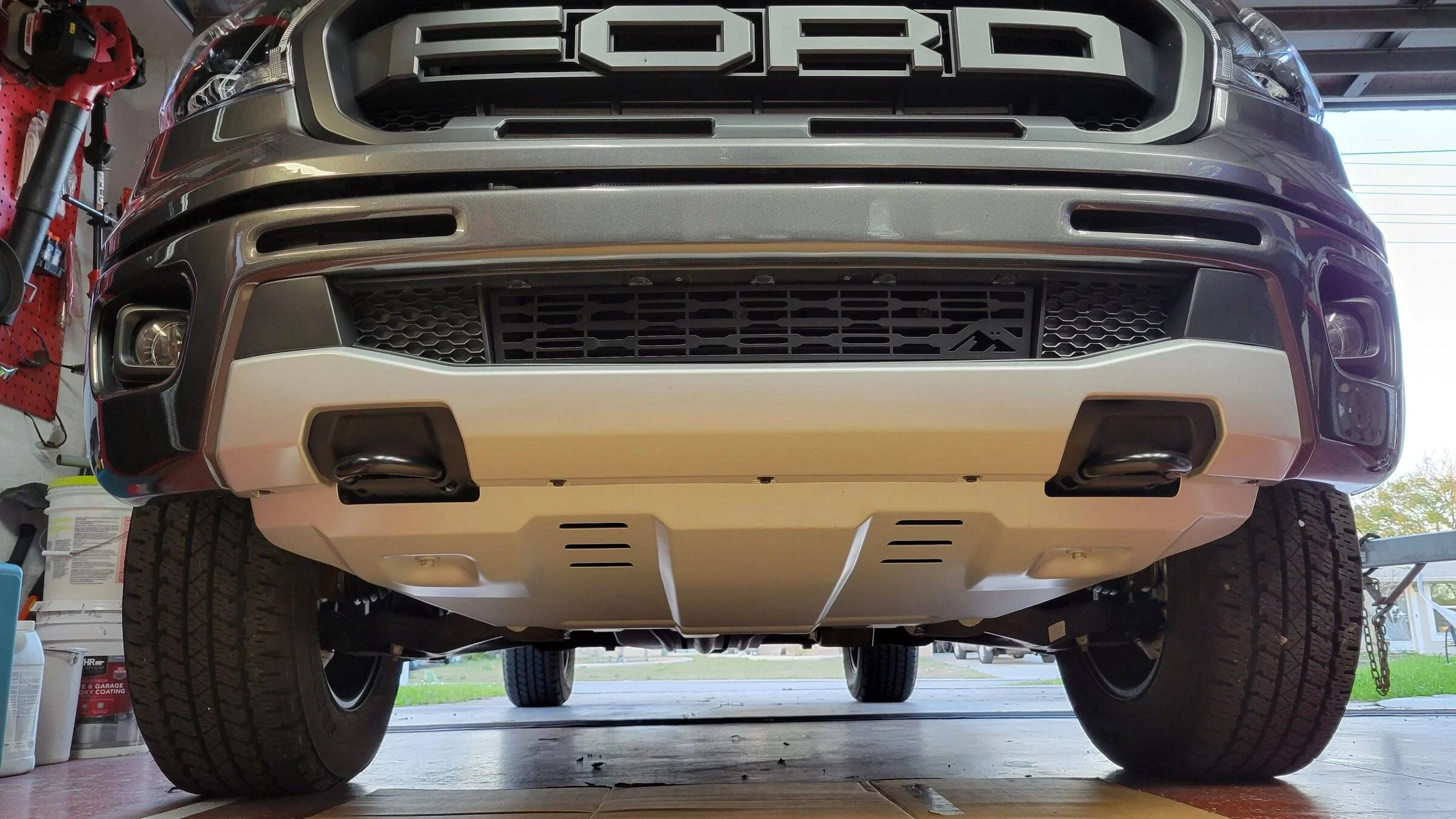

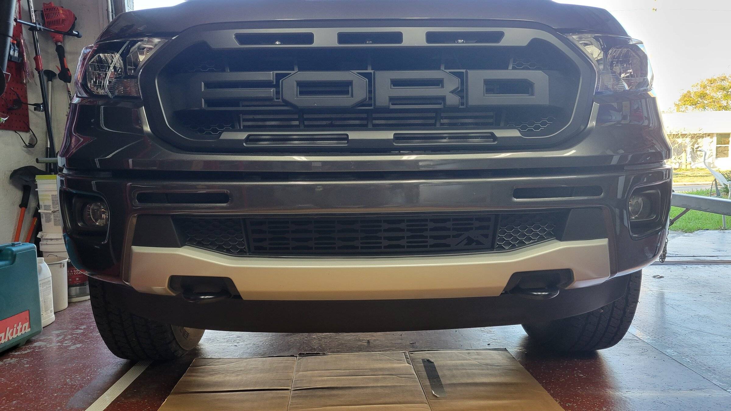

I removed mine too and installed the FX4 skidplate. It was pretty simple and went as Duke described above...
