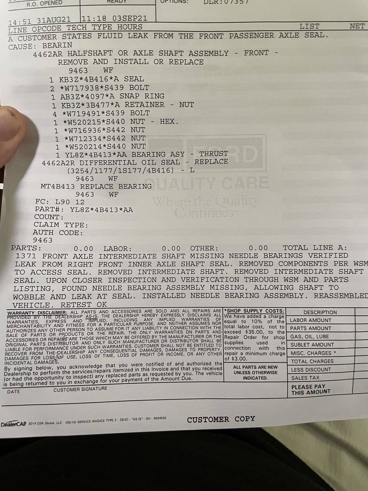

Hey guys!
I posted a thread a few days ago about having a front axle seal leak. Well I took it to Ford and they fixed and returned my truck. The needle bearing was missing completely from factory assembly and they replaced it and told me everything is fine. Truck is a tremor with 1300 miles on it. Has not been offroad yet.
i need someone to chime in here that’s smarter than me with this stuff. Could this cause damage to my front dif? Truck drives fine and shifts in and out of 4wd with no issues.
what the hell is a needle bearing anyways?
to the engineers or people who know this stuff that chime in thank you in advanced.

If it ran without long enough, then yes. I would guess that not using 4wd allowed it to run as long as it did. The seal most likely kept it centered well enough until it wore as evidenced by the leaking. The axle spline and carrier internal spline might also see wear but it was probably caught before being damaged.
The old dodge dakota front axles had bronze bushings and know of one that wore to the point where the bushing was destroyed and the housing was damaged. The owner epoxied a new bushing in place and the truck is still going strong.

Yes, serious but the bushing only supports the axle shaft. So the axle with CV joints slide into the housing. The splined end is supported by the differential carrier and the end closest to the CV joints is supported by a bushing or bearing in the axle housing. The opposite end slides through the spindle and drives the wheel. So the spindle supports the vehicle. The differential housing with the axle housings just hang there. And the CV joints are to allow movement of the suspension and steering in relation to the fixed differential/axle housing.
My point really is that the bushing was so worn out that the housing was also worn and wouldn't allow for a bushing to be press fit as it should. So, the owner epoxied the new bushing in place and the truck is still in use. The only damage was to the bushing, housing and seal. The owner re-used the axle. I think this was like 12 years ago or so.
All this tells me that it takes quite a bit to damage the components beyond a simple repair.
And I agree, using a bushing was a really cheap way doing it.

Nothing wrong with bushings. Remember Ford twin I beam and others. Needle bearings are better and more expensive. Covered wagons had leather and fat grease. Bushings are used on connecting rods, crankshafts, and more. You have to assume that the bearing surface on the axle was not damaged.
Covered wagons went at 5MPH, bushings in engines internals are force fed oil under pressure and apart from startup should never experience metal on metal contact.
Axles rely on splash lubrication like most needle roller applications, apart from sealed bearings.
Still there probably wasn't probably a lot of damage as the seal probably held it centered.
But contrary to earlier posts being in 4WD or not makes little difference the front end in these units turns all the time anyway.
