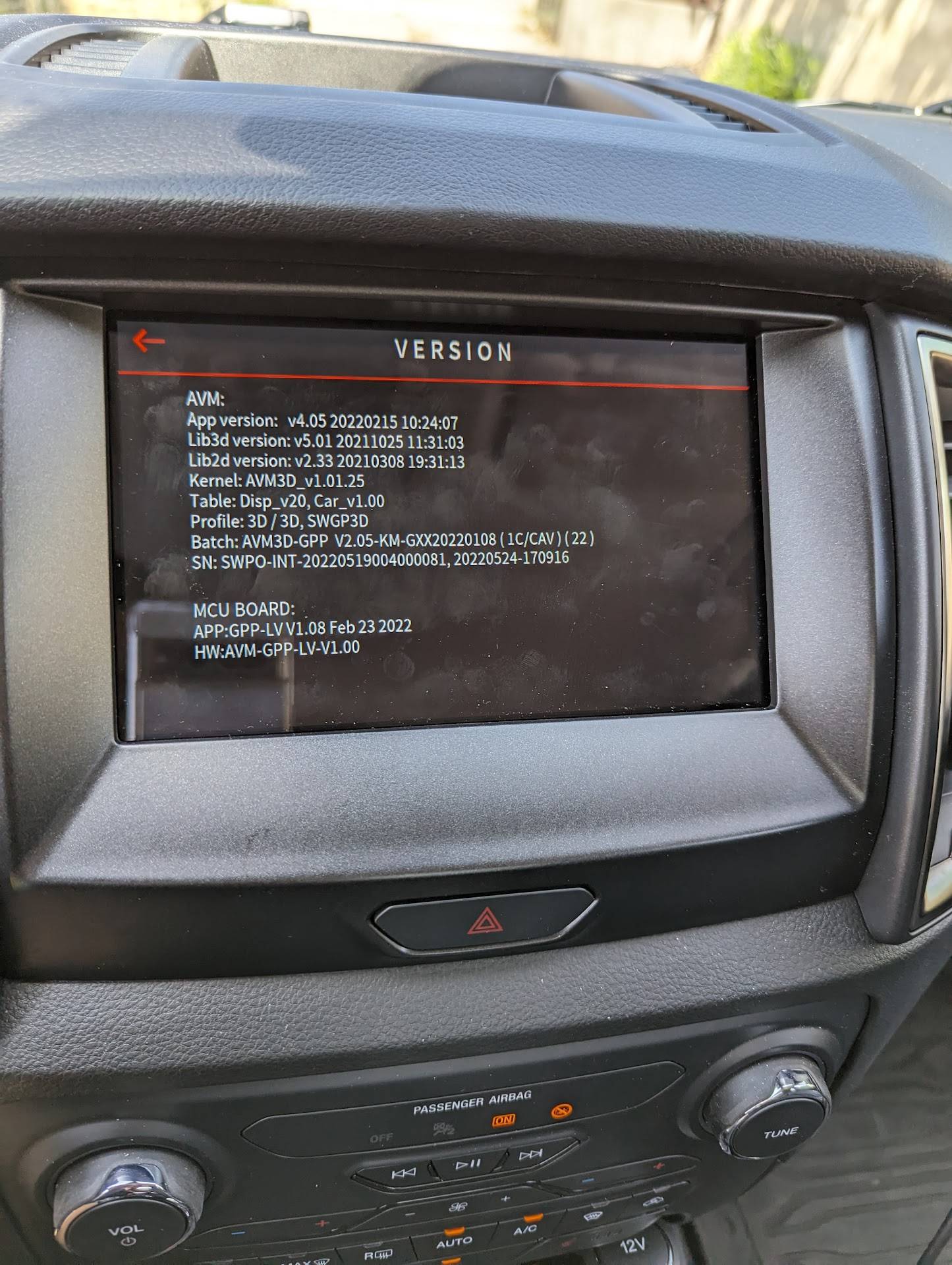

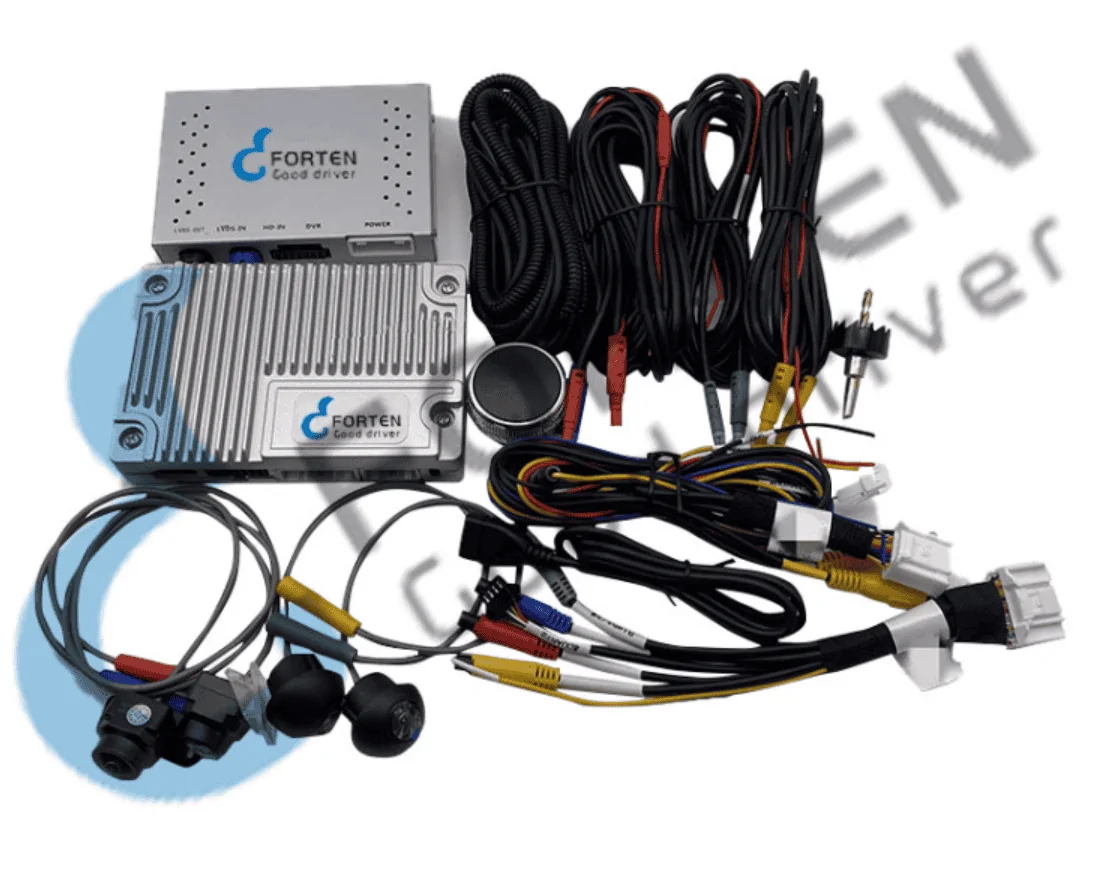

I installed a 360 camera system to my ranger. A camera image processing box and a recorder box are installed behind the sync 3 head unit. The video from sync 3 controller and from the camera image processing box goes to the recorder box , then the recorder box forwards one of the video streams to the touch screen. I attached 2 photos of devices info.
Now the summer comes and the screen goes black frequently. After black screen it can recover by itself. I suspect it is caused by overheating.
What cooling solution shall I install to the head unit and camera controllers? I'm thinking to install fans with heatsinks used to cool a computer and a fan speed controller. Is that enough?
If it is not the heat problem, how to diagnose further?
