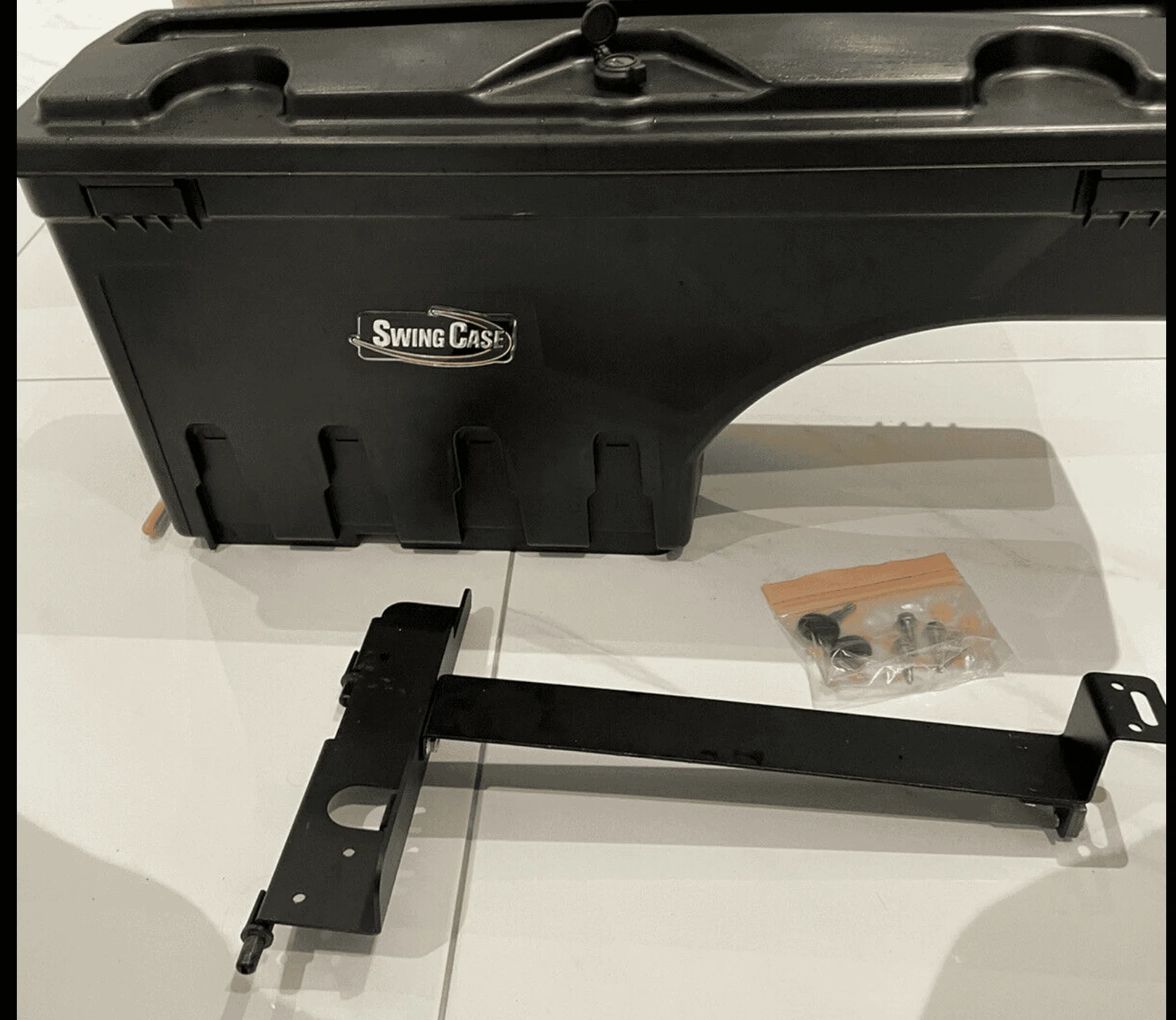

The ones I have seem to have the same bracket on the case itself, but the truck-side parts look like this:

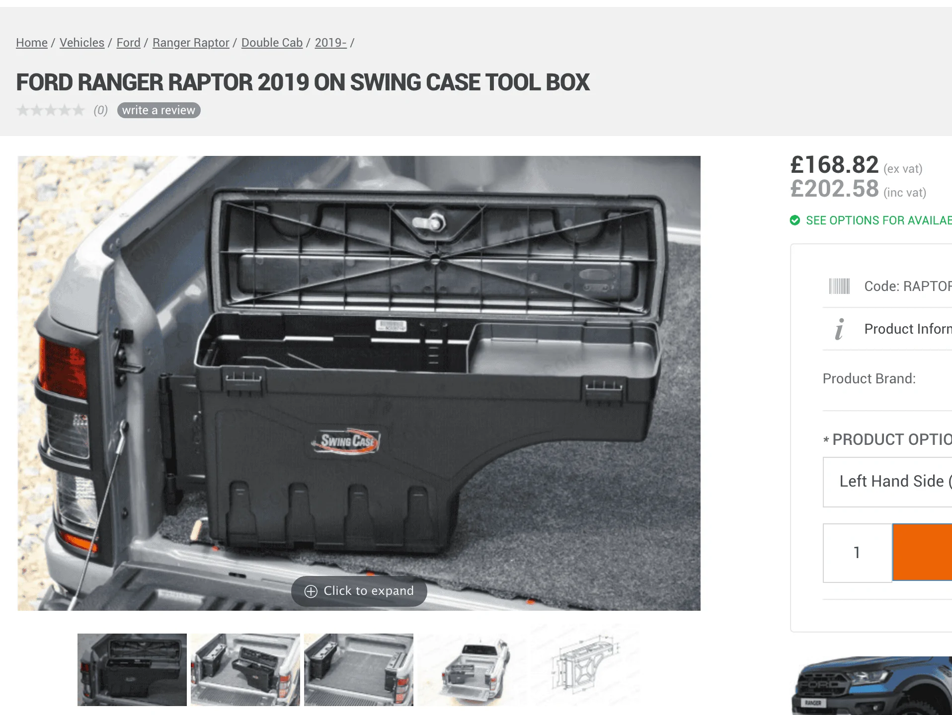

When I look at places in the UK selling the cases, that's the style they seem to be selling. What's weird is that there is one place that shows them installed on a Raptor and the bed is the same as the red one above, and they seem to have drilled into the bed and left the standard holes unused. Although I don't think it's possible to properly mount the front end of the bracket to the tie-down with the vertical slot-type bracket.
I don't mind making a plate for the bedside, but I think I may struggle to get a homemade hinge working as well as I'd like.

Do you have the holes in the bed that are used to install the bed extender?(shown below).
Based on the bottom picture you sent it looks like that bracket secures into those vs the tie down point.
Yeah, I have those those, and they are what the US cases use to mount the case. The cases I can see in the UK don't use those holes and have brackets that rely on screwing into the side of the bed in front of those factory holes, as in the picture of the grey Raptor.
It's not just that I don't want to put unnecessary holes in my new truck, it's also that if I'm going to put tools and gear in the cases, I'd rather the cases bolted into factory -nstalled threaded inserts, rather than just self-tapper'd into sheet metal.
Looks like I'm going to have to fabricate my own mounting hardware completely from scratch.

I did manage to get in touch with Undercover. They can supply the brackets (SC206D/P are the ones I needed - the ones I had were SC204D/P) at around $73 per side. Problem is I couldn't get them in the UK. I'd have had to order them in the US, have them shipped via a forwarding service, then get stung for import tax and duties etc.
It cost me a Saturday but in the end, I got a piece of £20 3mm steel plate and replicated the correct brackets with an angle grinder, some filing, and careful hammering. Transferred the latch mechanisms over from my incorrect brackets and I now have perfectly working Swing Cases :)
