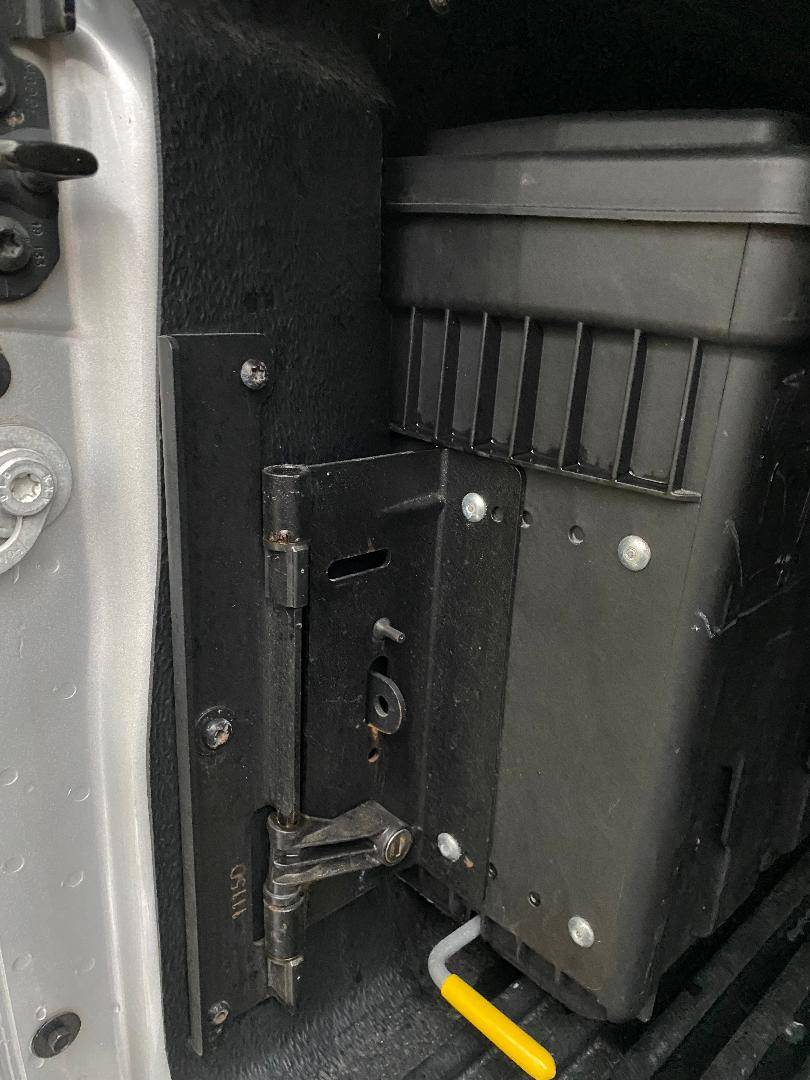

I received a swing case from Xmas for driverside. I was wondering if anyone installed one with the plastic bedliner? It wants me to trim the bedliner but I'm not sure how much to cut off. Would appreciate pictures if anyone could provide.

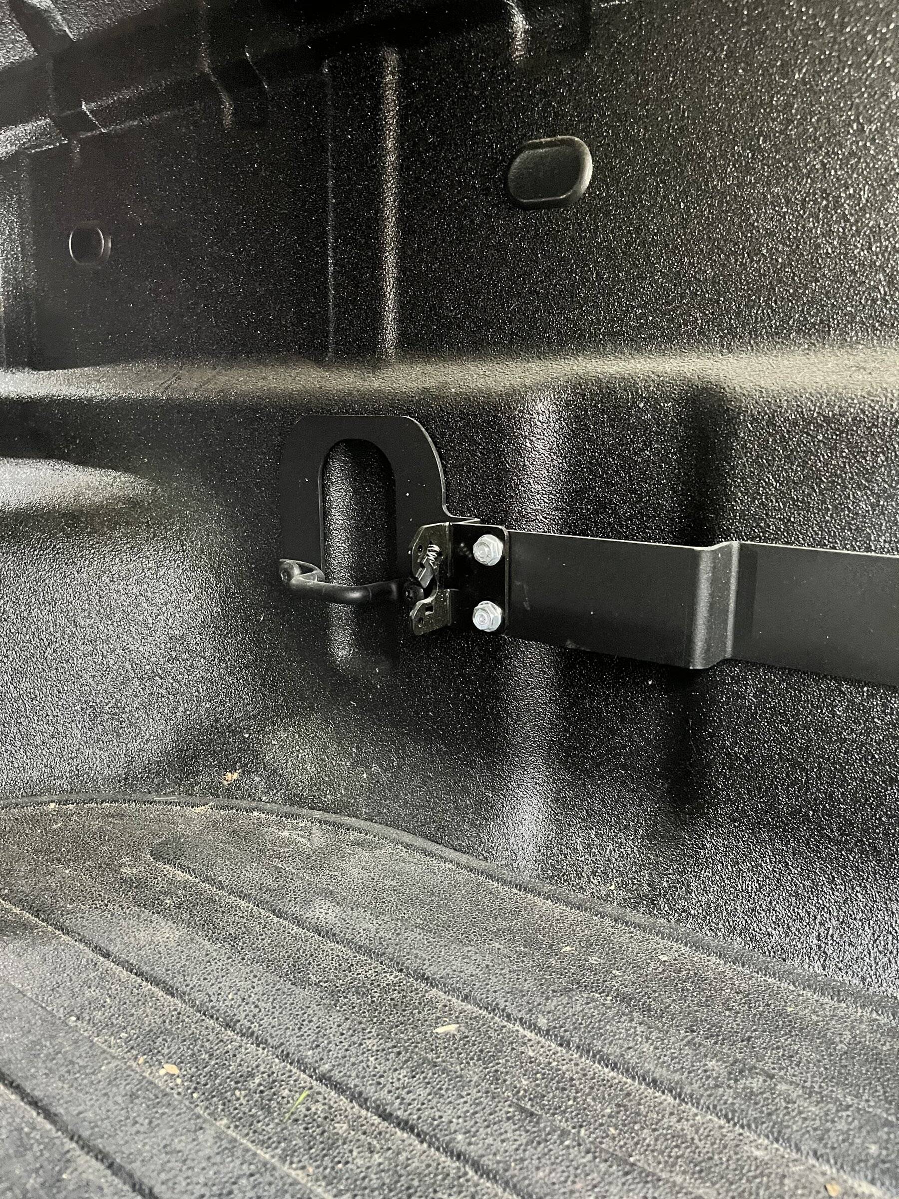

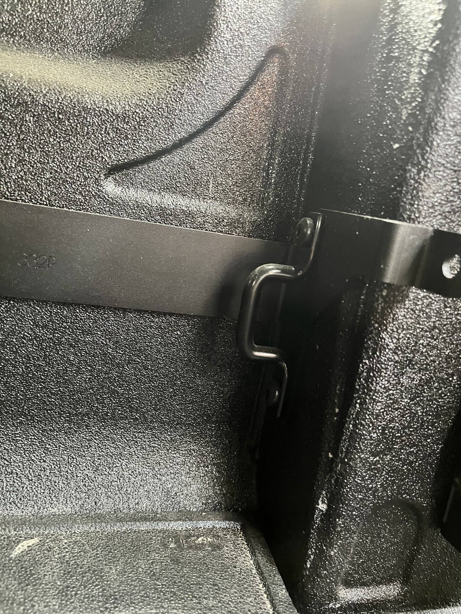

I didn’t have to trim anything on mine. I expected to have to but it just for fine. I have a Ford liner that came with the truck so don’t know if that mattered at all.

Took a few. Not great quality but you can see right on top of the liner. It already had all holes pre-drilled to add the box.

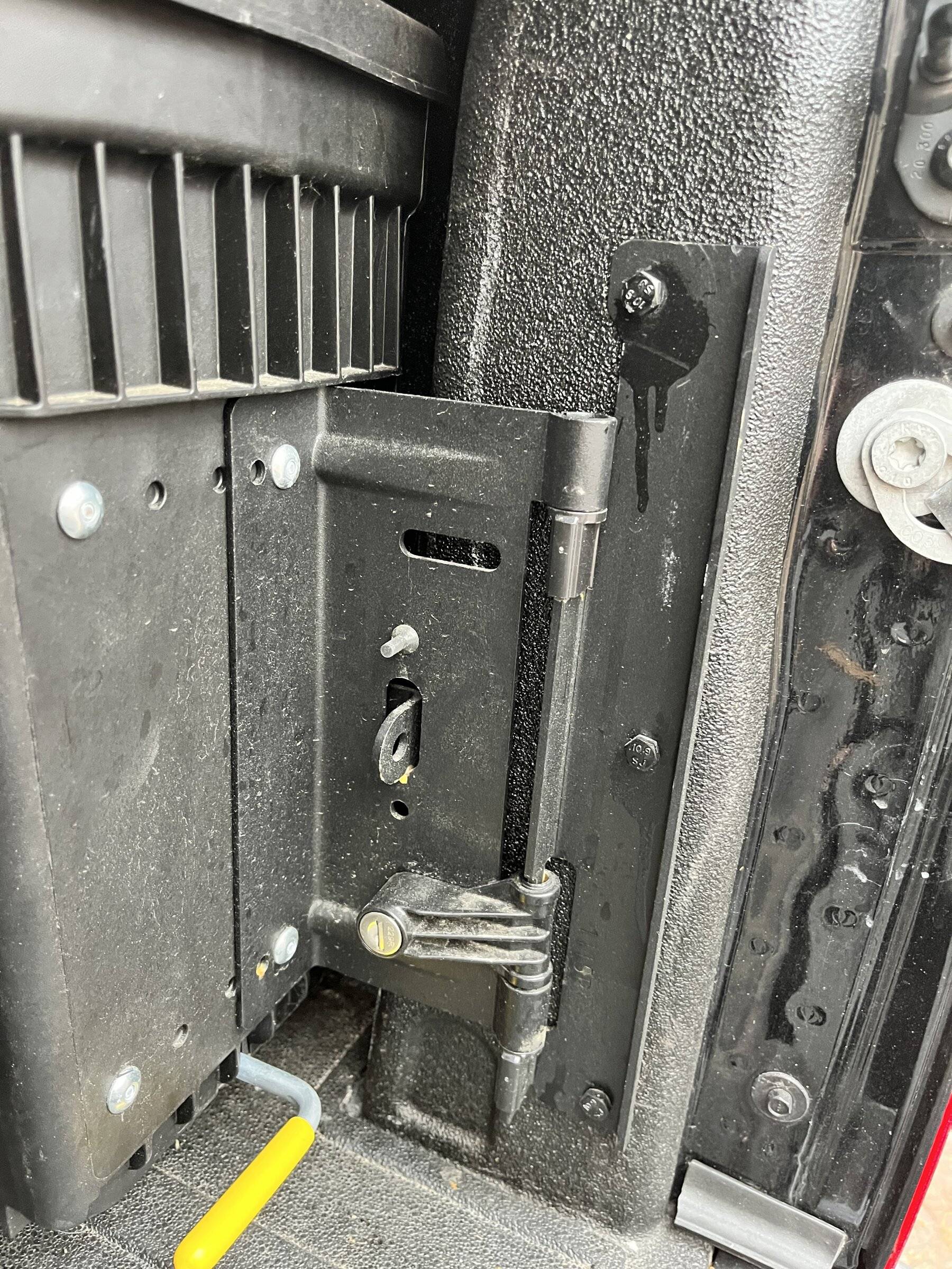

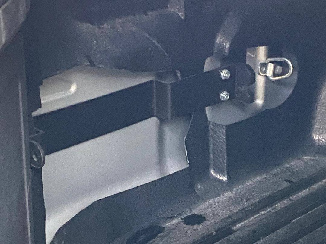

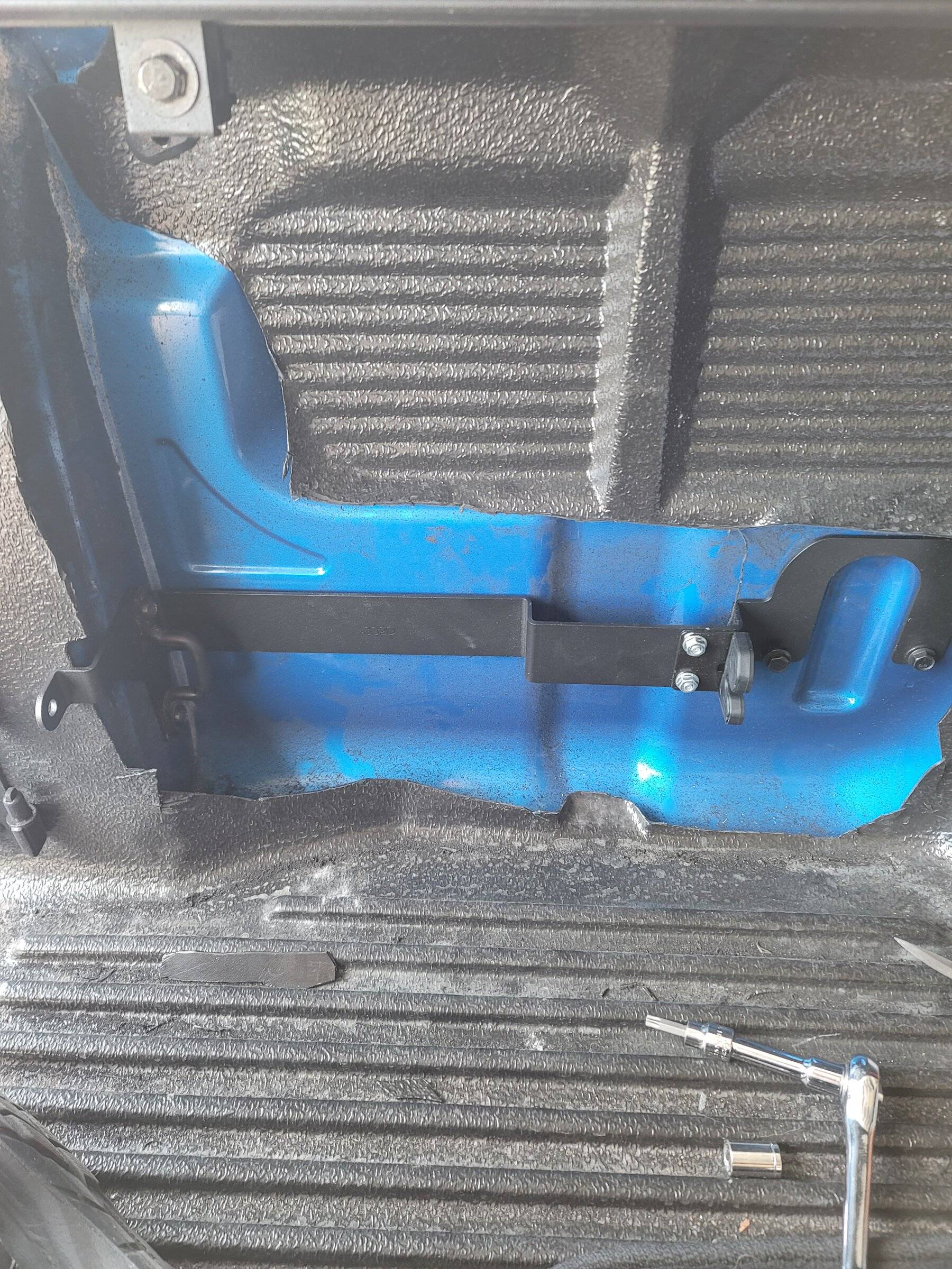

I just went out in the light rain to take a pic or two for this. There's one screw in the middle of the liner by the tailgate I took out an pulled the liner back to see where the other two bolt holes were to mark an drill them.
Then I had to cut the liner away to make room for the bracket. This is were you cut. I over did it but I was planning on doing a spray in liner later or just ditching the drop in an getting a bed mat.

Thanks for the picture. I finished getting in. Went a little bit overboard on mine but it works

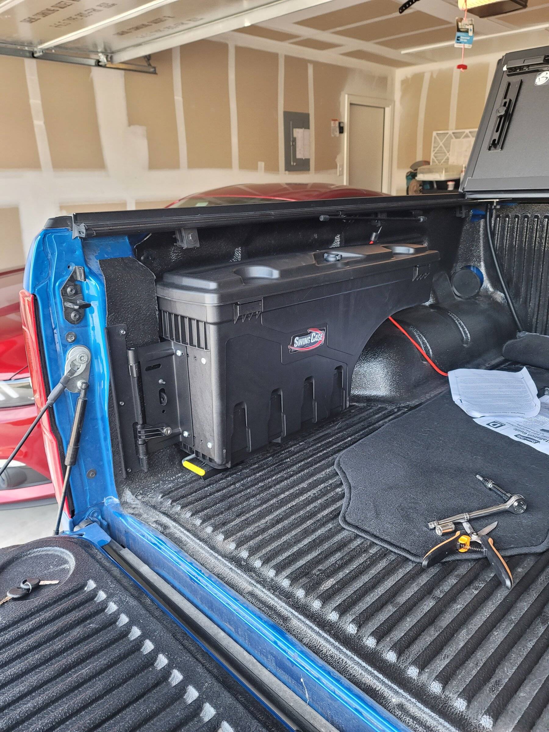

Here's how I did mine. Probably cut to much but can't really tell after the case is installed. I first used at dremel but it was taking long so I got heavy duty scissors. Then I got to some tough parts so I used hedge clippers which helped alot.
