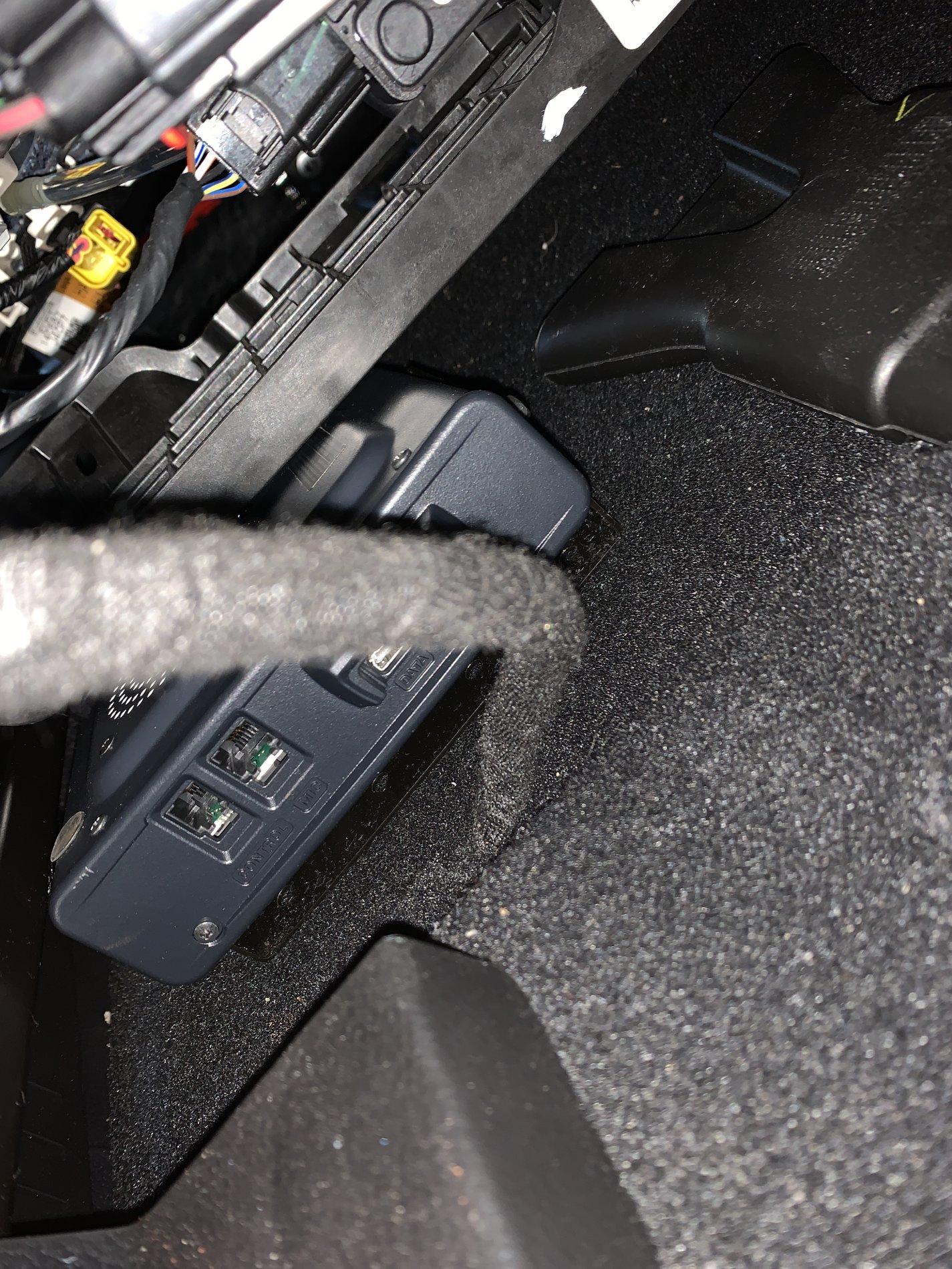

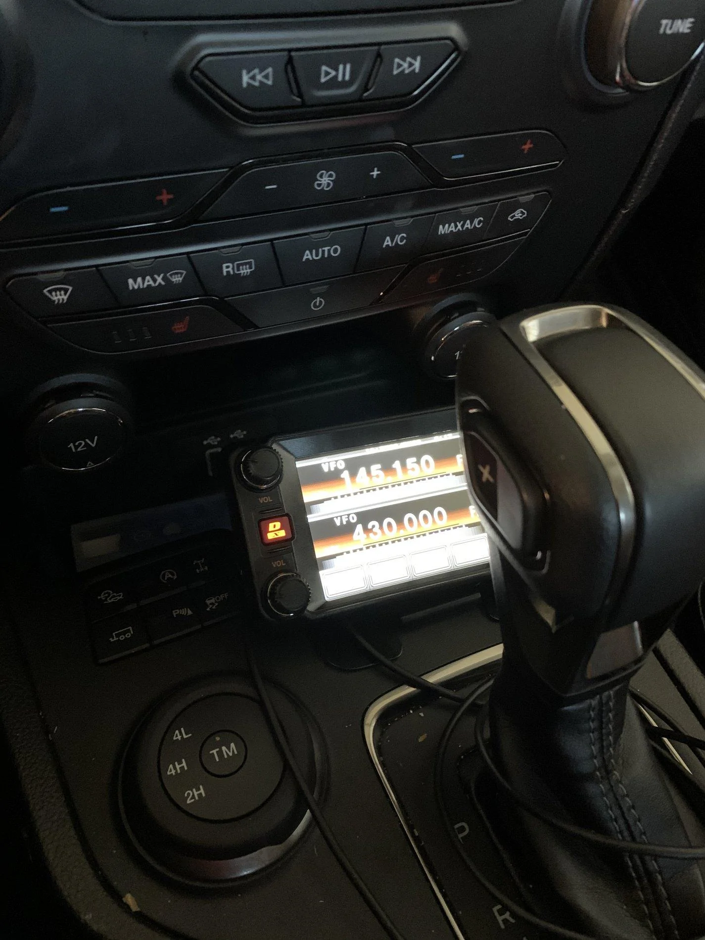

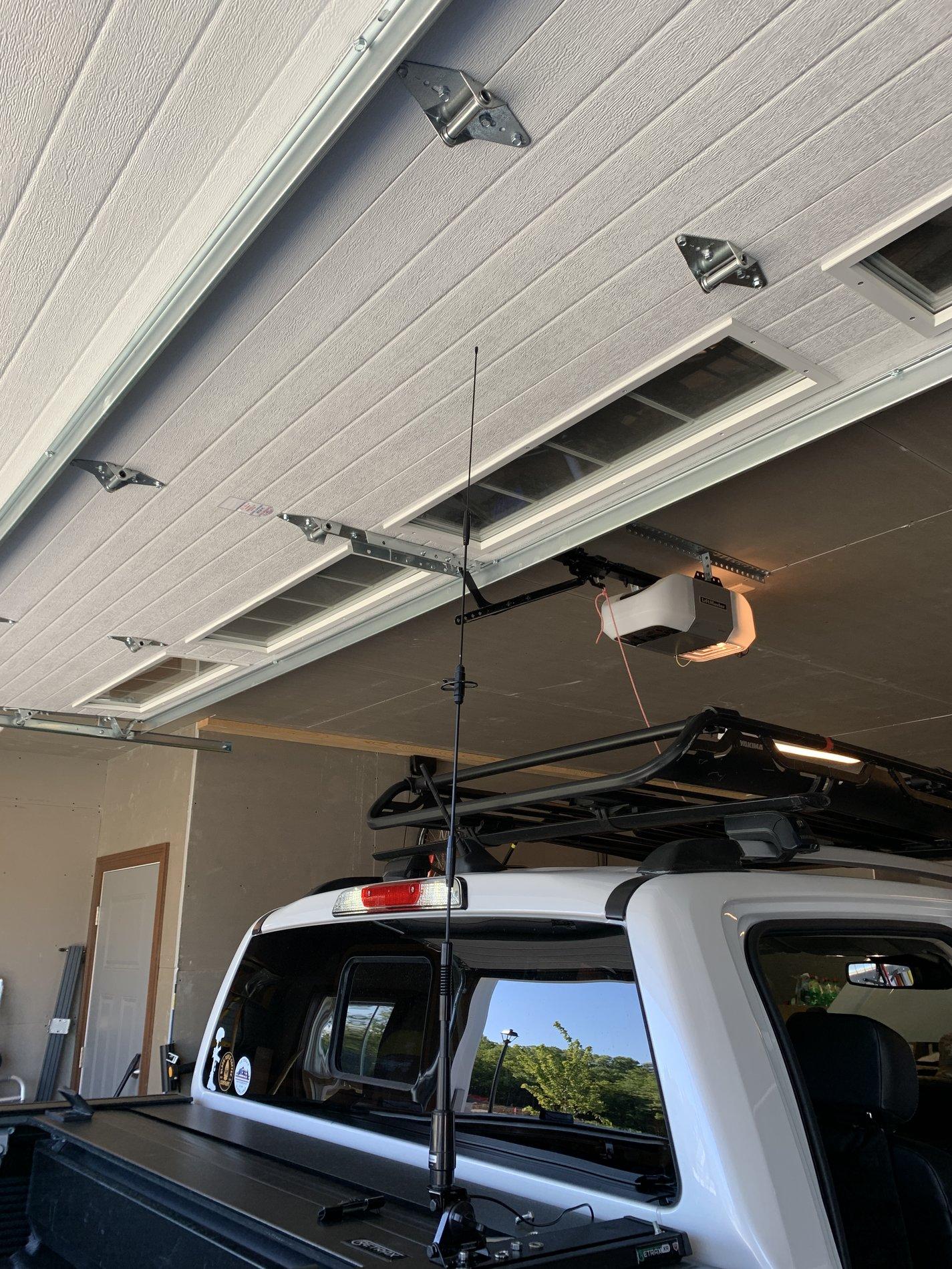

I got the HAM radio mounted in the vehicle over the weekend. I still have some clean up on the wiring to do but I am on the air.
mounted main body under passenger seat
mounted antenna to rail of Retrax bed cover... need to update hardware.
mounted controller to center console just in front of the shifter.

How did you secure the radio body to the floor underneath the passenger seat? That's my current hold up. I'm not sure if it is safe to screw bolts directly into the floor.

I used 3M Velcro strip. Holds up really well. Placed the hook side on the radio mounting bracket. It sticks really well the carpet under the seat. Have not had any issue with it.

Same here, I 3d printed a new bracket with the full footprint of the radio and lowered. This allowed me to use two 2" velcro strips to hold it under the seat. I didn't think the original metal bracket gave enough footprint for holding power.
