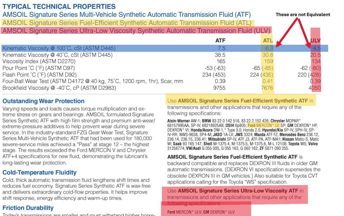

No, the 'ATL' (Fuel Efficient ATF) is not the correct spec for ULV.
ULV is the correct spec for ULV. You run the risk with the ATL of screwing up shift timings in the 10R's. We've had a couple people experiment in 10R transmissions with thicker fluids and most of them are generally unhappy with the results. You want to stay around the 4.5 cSt mark and the ATL is a decent bit higher than that. What the ATL is listed for is Mercon LV, totally different fluid.
We run into enough problems with balky shifting that it just isn't a great idea to go throwing a thicker fluid into the mix. Stick with ULV fluids. Sometimes you get lucky and don't notice a difference, sometimes it makes a mess of things.

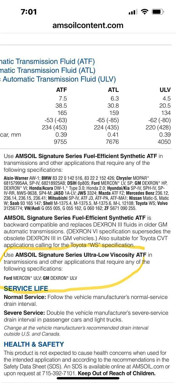

It’s been in the truck since 2019. I did actually notice a bit smoother shifting. Didn’t totally get rid of the rough shifting altogether, but an improvement. This summer will be my 3 oil change in the tranny which I will use the new stuff and see what happens.
This pic is from the ATL . Amsoil cannot make a recommendation unless it does meet there requirements/ specs. Huge liability, should something go wrong.
( Just friendly conversation)

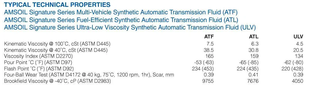

Yes, they are saying to use the ULV fluid in the ULV applications, not the ATL fluid, which is all they had up until very recently.
My points are twofold.
1. Amsoil, until very recently, did not have a ULV fluid. The closest they got is a 6.3 cSt 'LV' fluid (Their 'Fuel Efficient ATF'), which can and has caused shifting issues in the 10R transmissions. Sometimes a thicker fluid works, sometimes it doesn't and doesn't to an annoying extent. Doesn't matter if it is Amsoil, Valvoline, Mobil, etc. Higher cSt fluids are not what the shift timings and valve body are designed for and can cause timing issues.
2. Film strength, fluid quality, base oils are all minor players in the 10R saga. I don't recommend ANY fluid for an extended drain in 10R transmissions. Not HPL, not Amsoil, none of them. The reason is, it can be the best fluid in the world, but that fluid is still carrying particles around that are jamming up and slowing down our valve bodies and causing problems. And no, it doesn't matter if the fluid has better dispersant chemistry. The particles are still there and they're still eating into the soft aluminum and sticking in screens. If you're willing to spend the coin on the 'high end' fluids and change them on a regular basis, by all means have at it, but these transmissions all but require frequent fluid changes to keep the valve bodies happy. You're just throwing away expensive fluid at that point.
My recommendations are here elsewhere on the board. No longer than 30,000 miles on a transmission drain and fill, 60,000 on the filter. Minimum. Don't care what fluid you use as long as it is a ~4.5 cSt 'ULV' fluid. I also recommend an additive in the form of LubeGard Platinum at 1oz per qt. I started using it at 10,000 miles and waited until I had many tens of thousands of miles on my own trans before I mentioned it here, and while it hasn't 100% cured all of the transmissions, it has made a not insignificant number of them function better to the point people are happy with their trucks again. You might be able to get away with using HPL/Amsoil and no LubeGard. I don't know, haven't tried it and don't plan on spending the coin to find out. I'm sticking with my combination I know works.
