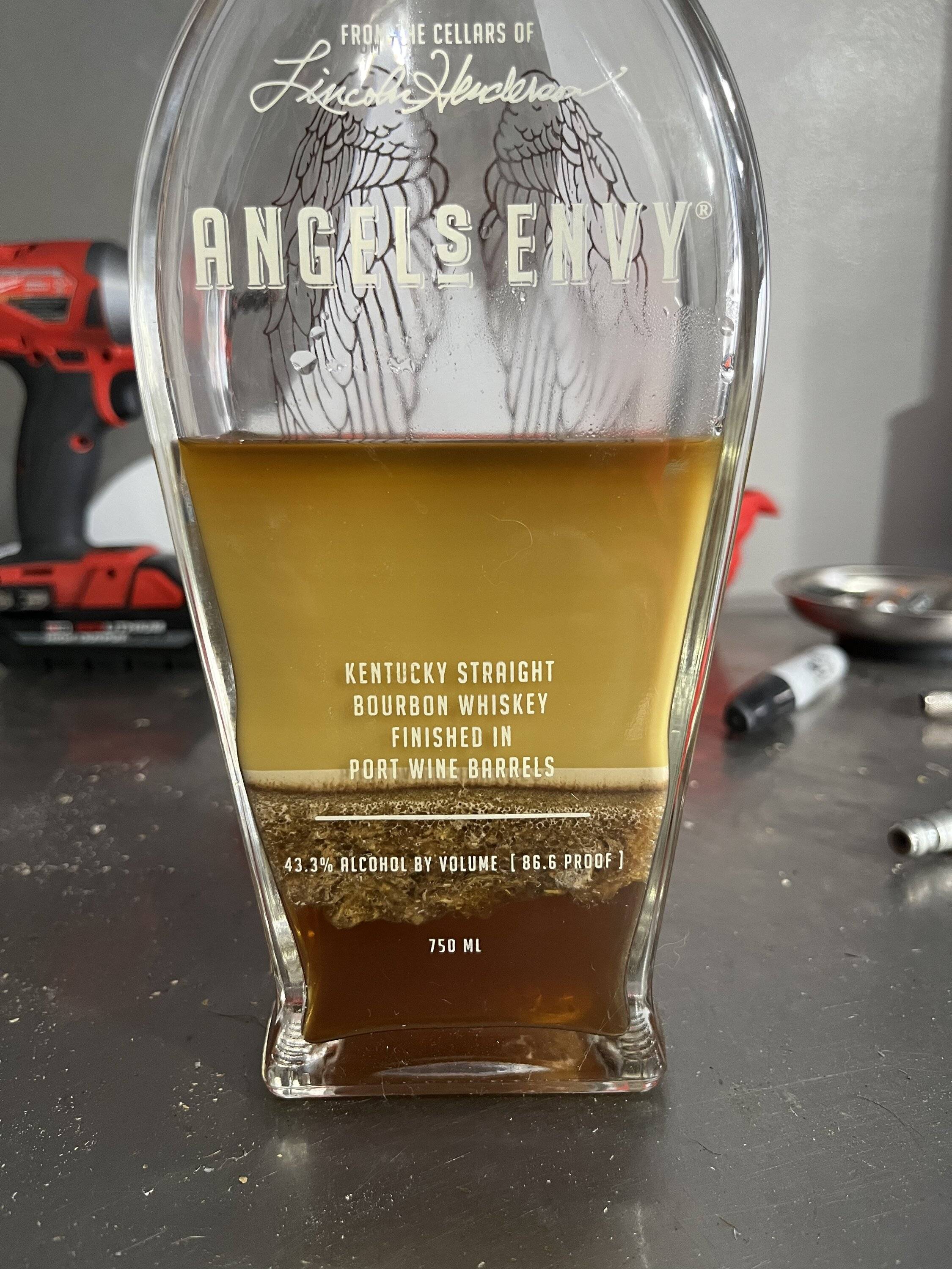

I have the UPR dual valve can, it’s not cheap and it’s very effective in catching contaminants etc from both sides of the PCV system. A regular person doing regular things is not going to benefit from having one, you’re talking about potentially prolonging the life of the cat and decreasing the need to clean the valves at the expense and inconvenience of buying/installing/maintaining the can.
On my truck I prefer to have one because it helps ensure that what burns in my combustion chambers is just fuel and air, thus reducing the potential for knocking. Also through warmer months it doesn’t catch more than maybe 2-3 ounces of thick oil but in the cooler months it catches like 6-8 ounces of fuel/water/oil slurry almost every 400 miles! That is enough for me. I’m happy to have it.
The cheaper ones tend to do very little btw, especially the ones that only hook to the valve cover and inlet side.

Just a small sample of what mine has captured.
