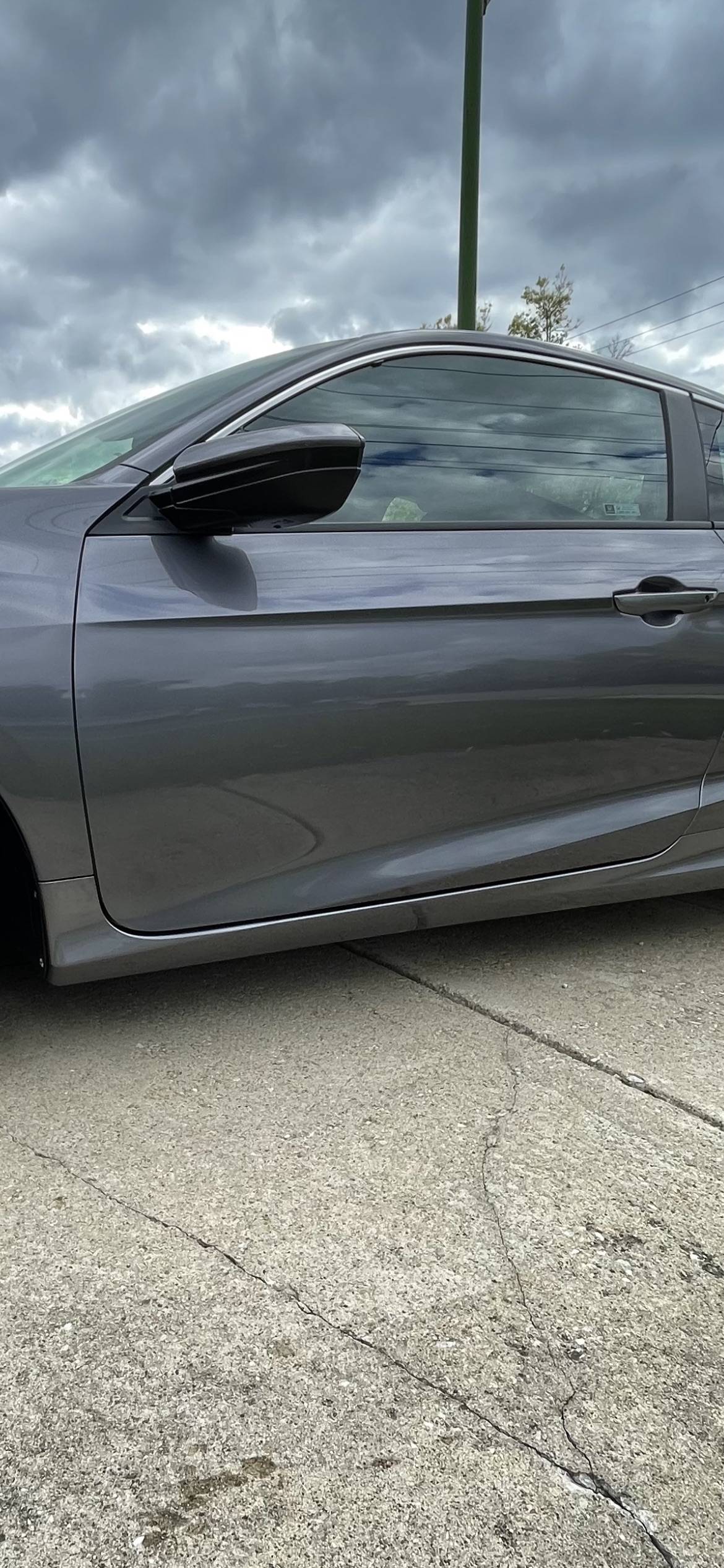

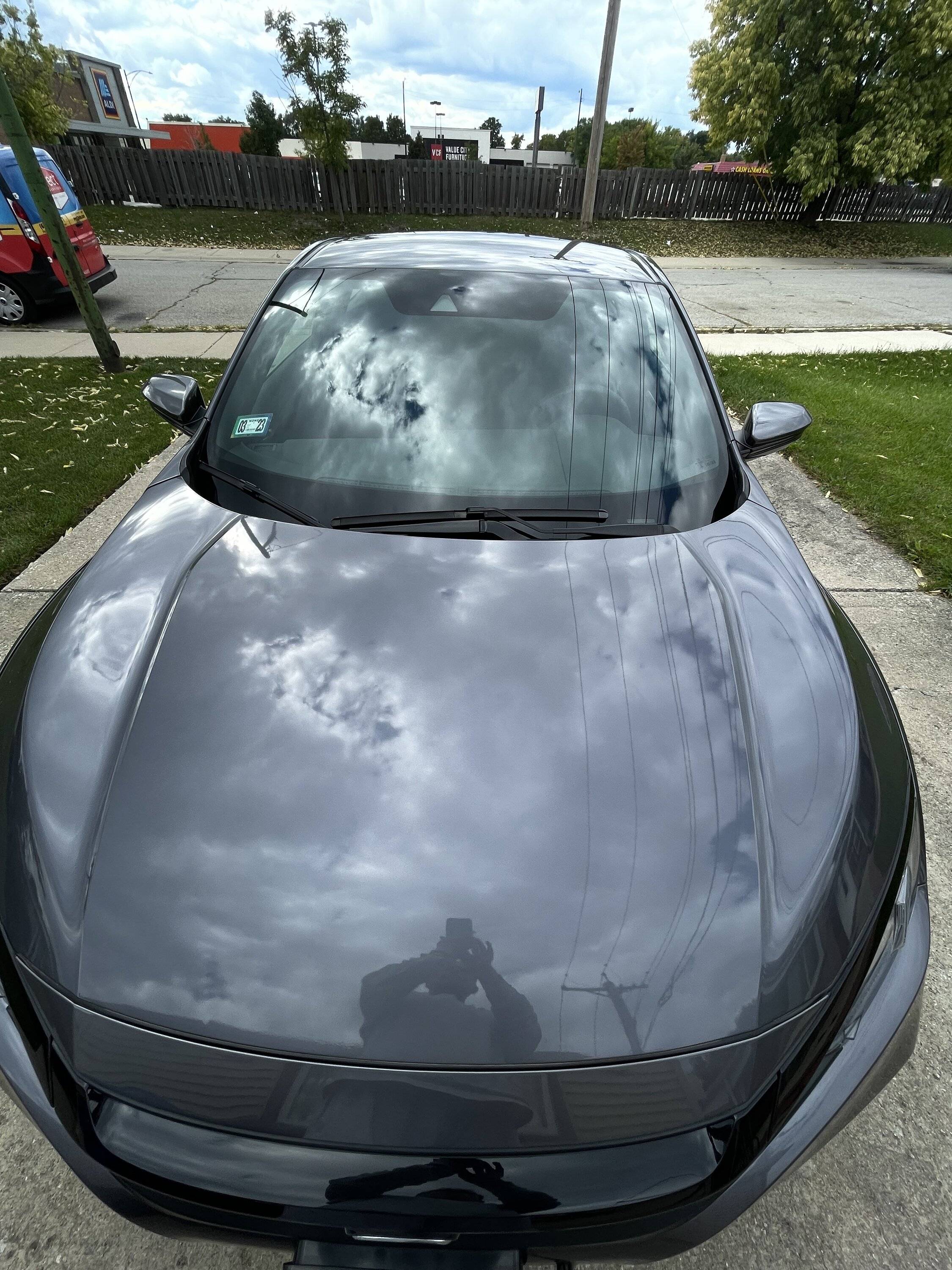

I just did my girlfriends Honda Civic last week. The car is 2 years old and has never seen a coat of wax and was dry as a bone! :facepalm: Here's the hood after doing 3 coats of the Graphene Nano Spray and 1 coat of the Graphene detailer. It too sits outside 24/7 so it'll be interesting to see how well and long it lasts.
See, told you he was doing girlfriend stuff. ?
Three coats, nah, be like Kate, use up most of a bottle and put it on so thick that it takes a lot to buff it out. Her single layer is probably an inch thick! =D
