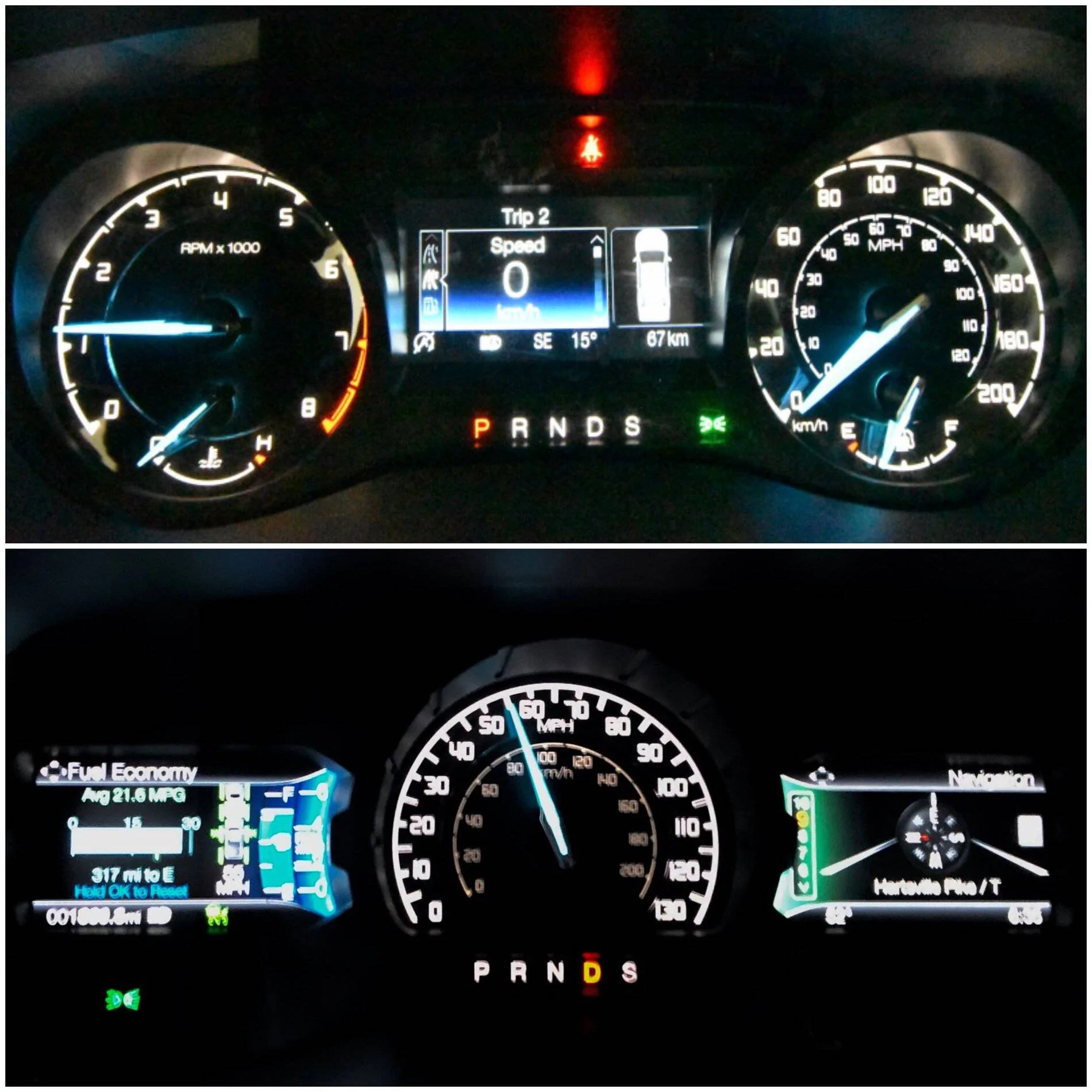

Cant find tire pressure dash display

My 2019 Lariat is in display mode: arrow right once, down twice.

I had the dreaded tire pressure warning light come on while on the freeway and quickly got into the right lane just in case and went to the tire pressure screen. The driver’s side front showed “- -“ instead of a number like the others. ? I sure found the next exit in a hurry - manually checked all four tires - same. Faulty TPMS Sensor. :whew:

From OP: solved by Bsthroop, reply #16 - thank you! For tire pressure readings: from Display Mode, right arrow once, down arrow twice (past Off Road and Digital Speedo). My manual page 101 is misleading.
