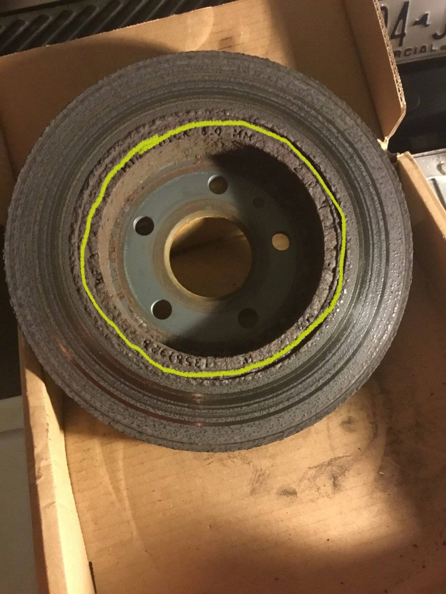

I also use anti-seize on the face of the hub and sides, yet this does not help as the rust buildup I was explaining happens at a point where the rotor does not get in contact with the hub while everything is in place. As soon as I have taken the wheel off the rotor was loose but it would not come off.
There was a collar of rust closing in behind the hub, as when the wheel is mounted the hub protrudes in the rotor. The difference in diameter between the hub and the rotor inside is maybe 2mm. Yet the collar of rust I am mentioning had a diameter smaller than the hub. The only way to prevent this is to apply some anti rust solution that would resist the heat on the inside of the rotor.
I took a random photo from the internet trying to explain with an image. Imagine that yellow circle smaller and smaller in diameter with rust buildup until it gets smaller in diameter than the hub. Exaggerating of course it could close in that inner face of the rotor until it would touch the axle. The rotor is free once the wheel and caliper are off, you can pull it a few mm but then it stops on that collar of rust.
It’s not like this is the first issue with car brakes I had but this type of problem is new to me. Ford chose to put a tiny diameter difference between the hub and the rotor that in a matter of two years the rust is an issue. It’s not a tight fit to be hub centric on the entire hub yet tight enough to be a headache.
