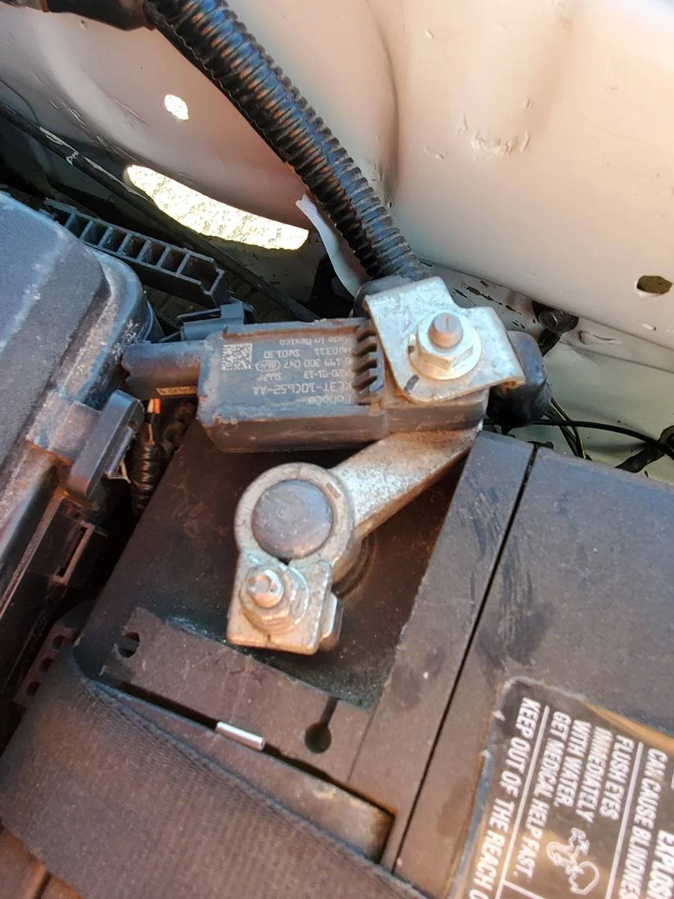

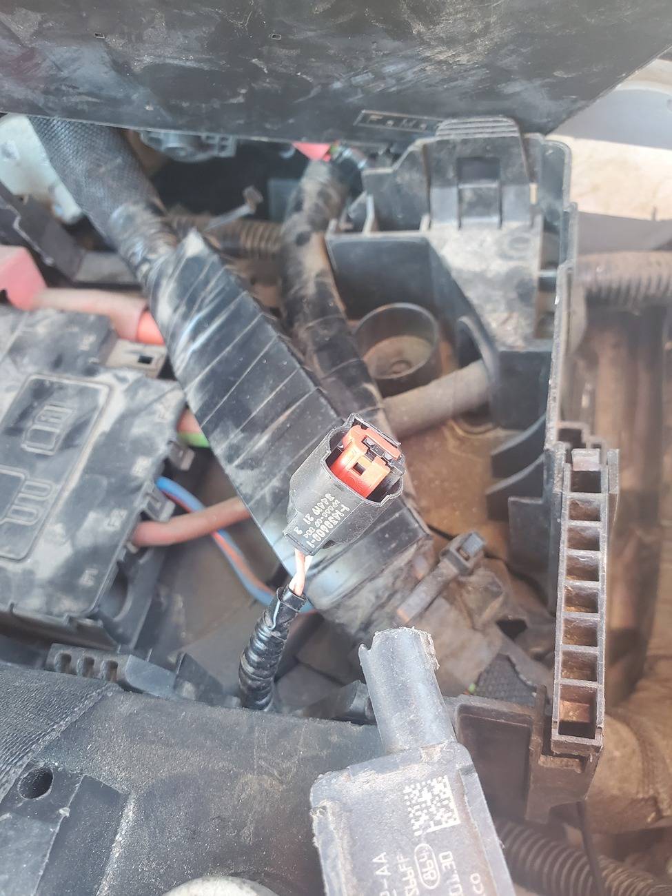

Ok, the pictures you posted cleared up a lot.
You may be right about the BMS.
I took a pic before exploring and now that I know what the BMS is, notice in the first pic
that the bms has the connector plugged in.
Then after unplugging everything from the BJB I notices that the plug to the BMS had come
off. The plug has a lock clip on it and I don't think it would just come off by bumping it. So
maybe it wasn't clicked on all the way.
The BJB's casing is cracked. It looks like the battery was pushed back into it. But the modules
that the massive plugs plug into look fine.
Anyways, after buttoning everything up and making sure the BMS clip snapped tight, I started
it up and checked the codes. LOTS of them, several diff modules. But after clearing them, none
came back.
I can only hope.

In your first picture above, the negative battery clamp is not installed in the correct position. It is rotated causing the BMS connector to be jammed against the BJB. The BMS sensor long edge should be parallel to the BJB front edge. The battery terminal clamp needs to be rotated counterclockwise as well.

Yes - Rotate the BMS Sensor, so it's not hitting the BJB, and depending on how bad the BJB is cracked, might be the source of your (stall) issue.
I would recommend at the very least getting some sealant (RTV) Flex Tape or similar to repair seal the crack from monture intrusion. This is not an old school fuse box. it is a circuit board (PCB), and moisture intrusion can short the board.
If you continue to have issues - you can find a BJB on Ebay fairly cheap and just replace it as a precautionary maintenance action.
I would also check to ensure ALL of the Left side (inner Wheel Well) covers are installed, as those will help keep rainwater being thrown up on the BJB and related areas by the tire.
Since you have addressed the BMS and Headlamp codes, we still need to confirm that the main issue (stalling) has been addressed, and if it does it again or issues remain - Replace the BJB vs replacing the BCM.

Roger on the Rotate.
And I do see the BJB's on ebay.
Can't help but to think that would be a good idea.
Really appreciate the help.
I'll keep you updated.
