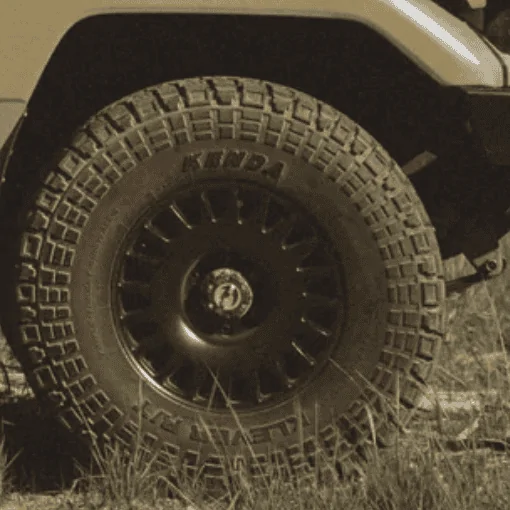

To achieve this look:

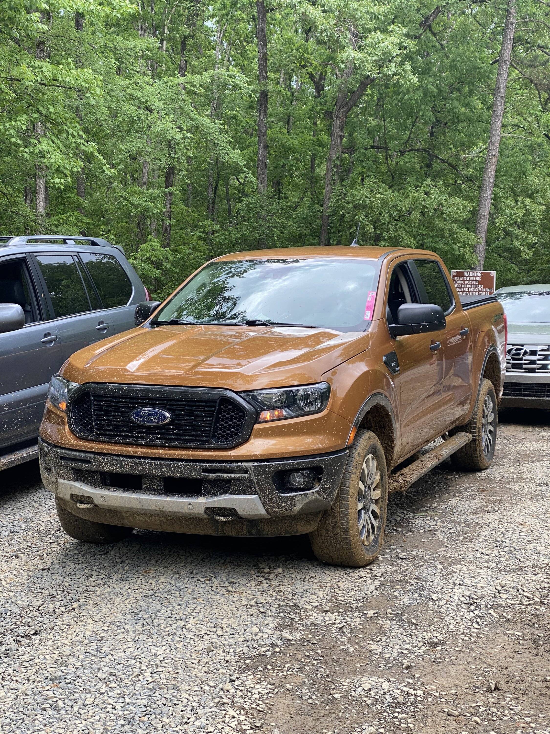

Currently how she sits:

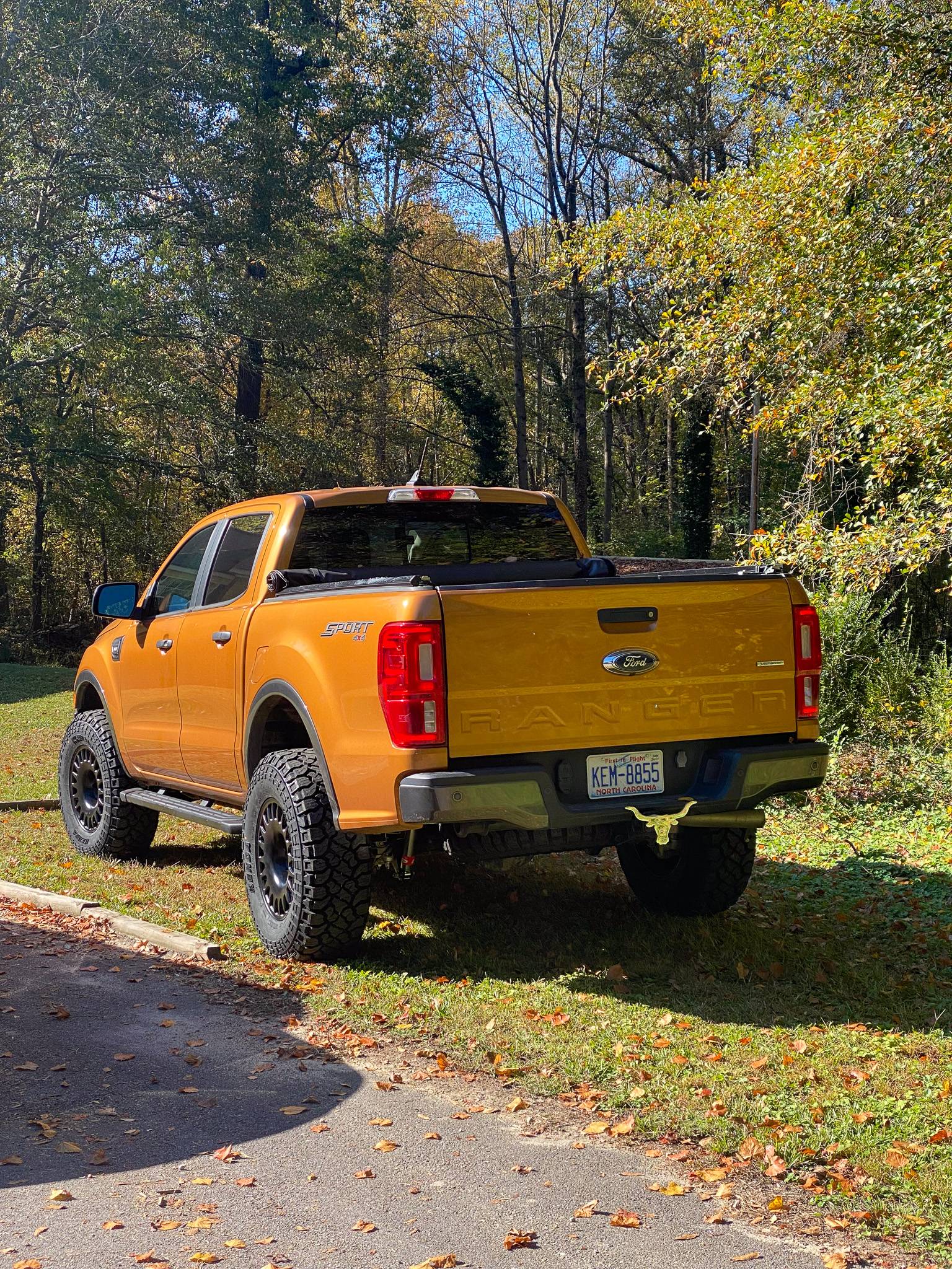

Update here:
Thanks to this forum I was able to do everything myself. It did take me way longer than other people seemed to estimate though (almost 20 hours total), especially because I did the front suspension swaps by myself and prying the old struts out and getting the new struts in was a major pain in the ass. Also putting the rear lift blocks in with just a floor jack and jack stands was a little dicey but I made it work. With the price of labor of saved and the tools I now own I think it was well worth it... I think.
The ready lift anti-intrusion crash bars ended up not having enough clearance with the 33" tires, so I am officially crashbar-less.
The Rugged terrain E-class tires are a little noisy and definitely ride a lot stiffer but they are amazing off-road. Truck feels a lot heavier as well. MPG dropped about 4-5mpg, and I did have to take the air dam off.

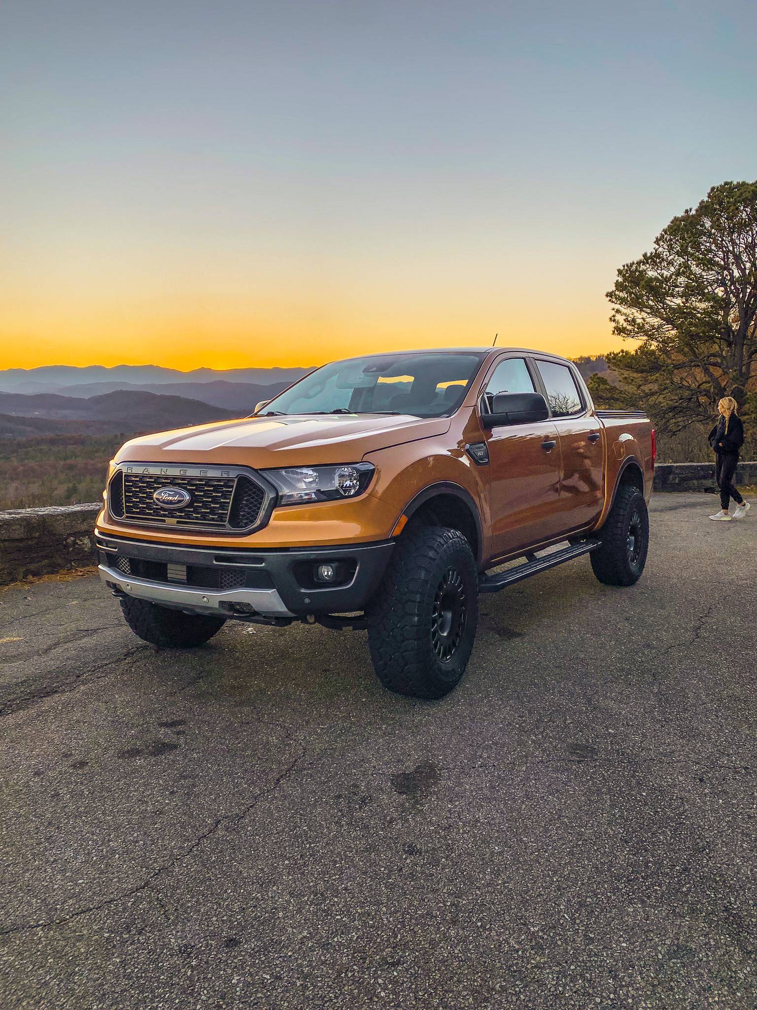

I put about 600 miles on it this weekend to and from the blue ridge mountains and everything is feeling and looking good:
