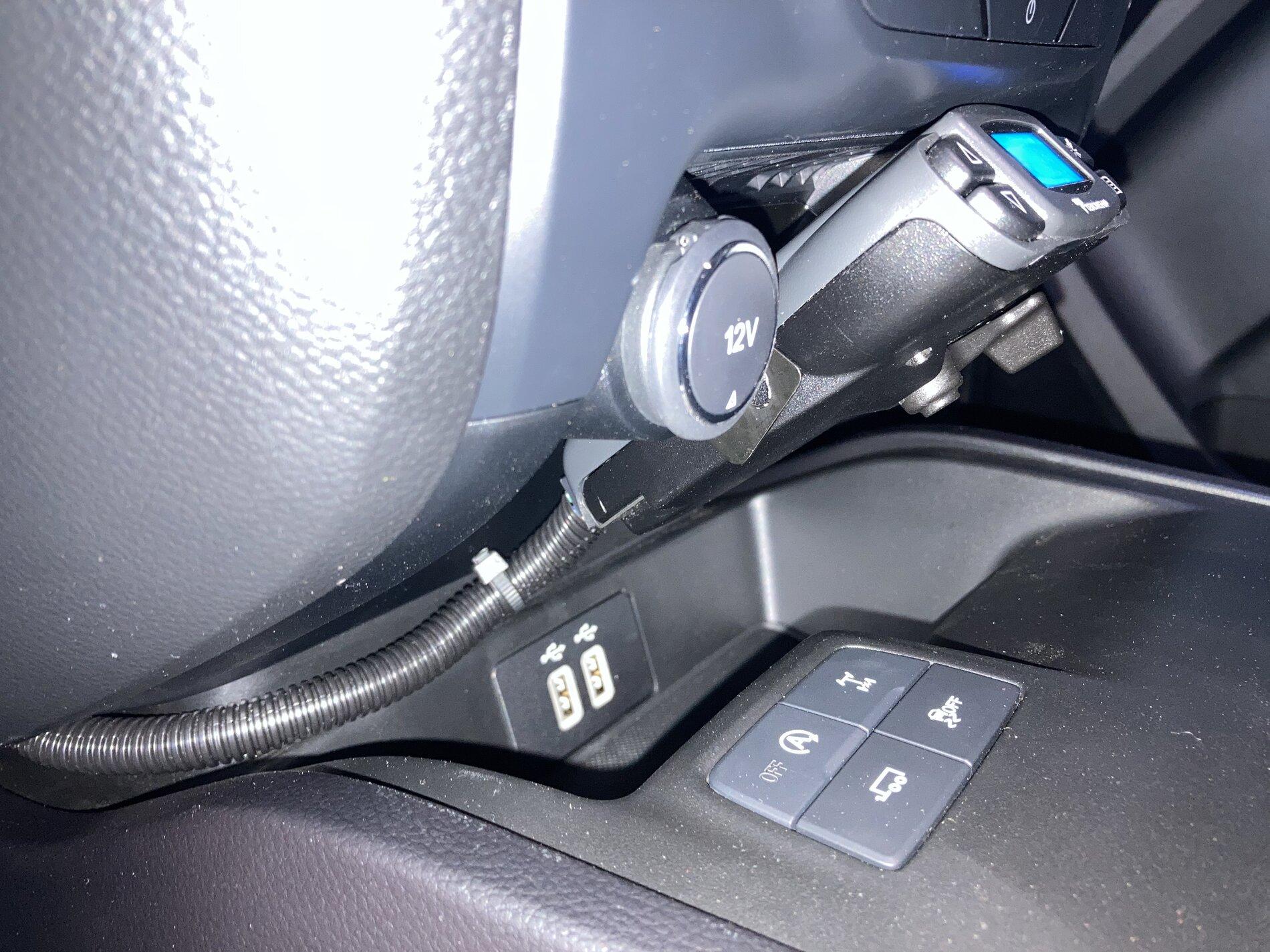

Just did mine. 12v (yellow) and trailer (blue) are 12ga, ground (white) and brake on/off (white/violet) are 20ga. I used 16-20ga (red) and 10-12ga (yellow) crimp on butt splices.
My P3 harness had 16ga for ground and boo, and 12ga for 12v and trailer. Mounted nicely in the center console.
edit: you need to cut the blue tape that holds the brake controller wires together— that should give you enough to work with even after you cut the heat shrink portions off.
